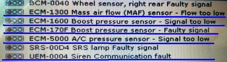

As you can see it's been a long time I started this thread.
With this as result of fault reading; Now the rest of the story:
I did anything I could to find the reason.
I also visited several general shops and some claiming being specialists and working exclusively on Swedish cars.
Suggestions as how to deal with the issue usually started with "replace the booster pressure sensor MAP" [most frequent] replace MAF, replace AC compressor () replace fuel filter etc etc
Being burned before following free advices received [probably from friends of part sellers] to replace MAF, crank shaft sensor and TB, therefore having throne away good $$$ I decided not to replace any sensor AT ALL.
I began testing these sensor on in their pace; a set of sewing needles, wires and a multimeter.
The reading were more difficult to understand than Greek spoken with a Japanese accent.
They changed every other time and whether the Key on 0, Key on II, engine running or sensor not attached.
I KNOW, these changes are normal but the same reading being different from one day to another ????.
The 5V+ line was driving me crazy. One day 5, next day 0 and the next 1.69 then maybe 4.8
I suspected a short somewhere.
So I took the car to a car electrician explained my case, handed showed my printout of the wires regarding MAP, MAF, Ac etc.
This guy took me seriously, listen to my explanation took my electric schematic and called me 2 days later:
They had removed and cleaned the harness (the one on my schematic) realized there were oil spills on the computer end. Cleaned it and Voila. The car is running fine since 2 weeks. And so is the AC!.
I was charged for 2 hours labor.
Maybe my story will help someone save couple of bucks on unnecessary purchase of parts.
