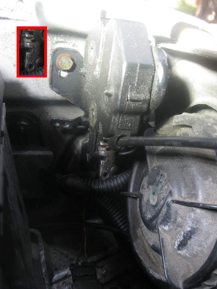

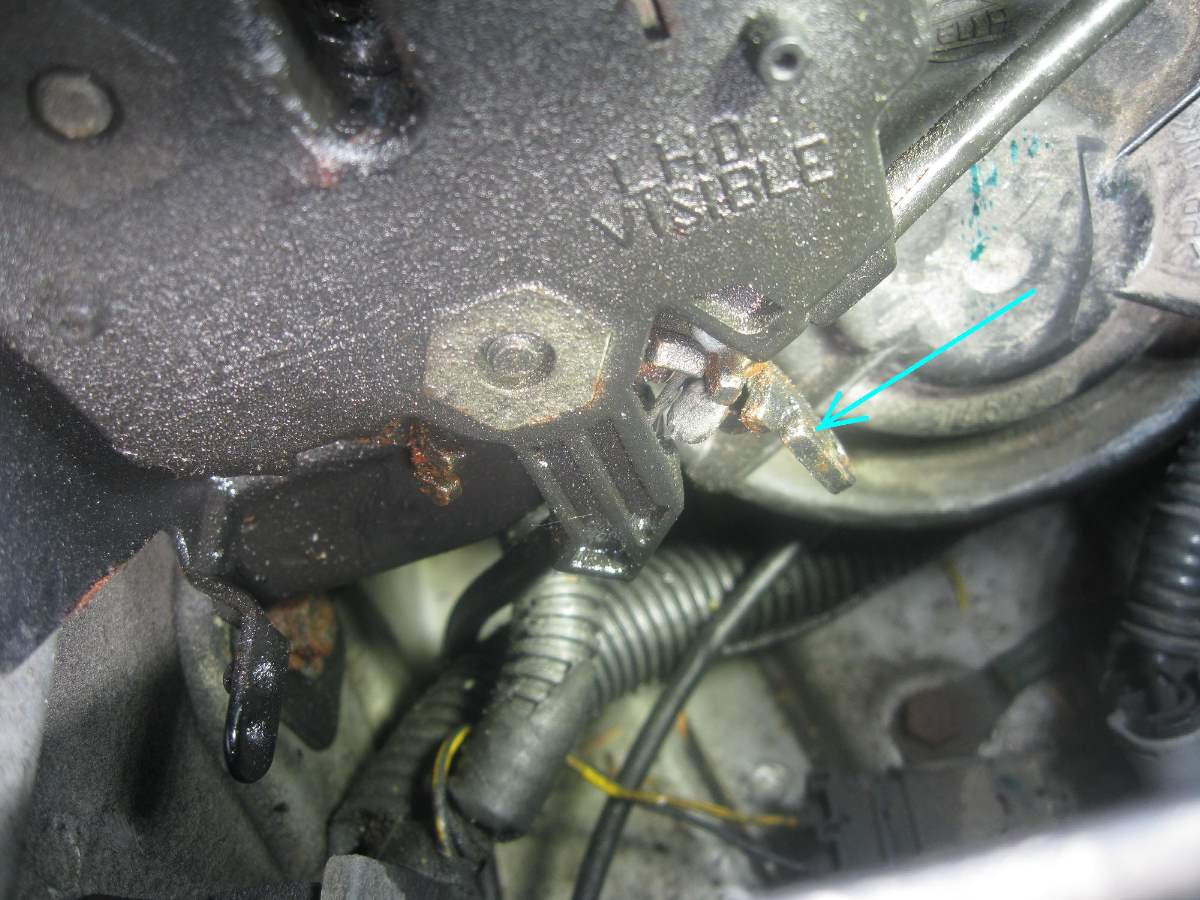

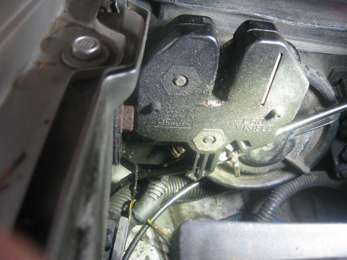

Hi again,
Thanks for the detailed explanation.
I included my close up pictures of the drivers side latch, two from the back of the latch and one from the side.
Looking at the picture with the blue arrow, i guess that is the lever right?
Looking at the side view pic, that same metal piece has a hole in it near the bottom, not a slotted hole. But if i tied something to that hole i guess pulling it to the left (looking at the back picture again) would open the latch?

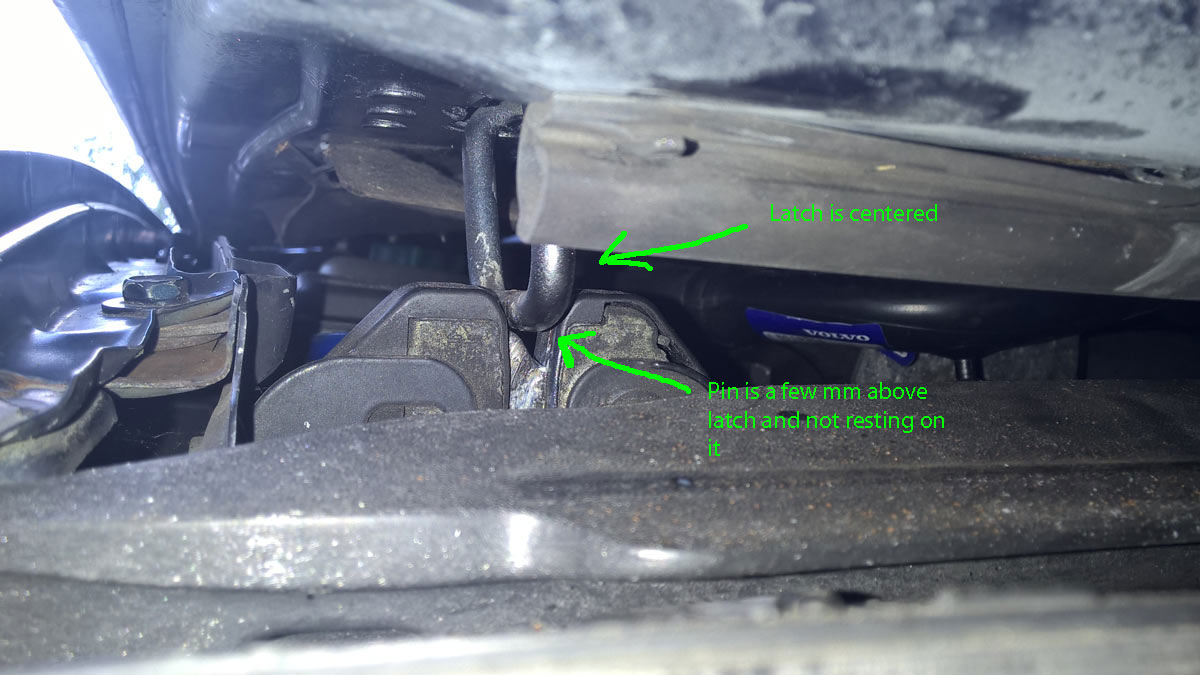

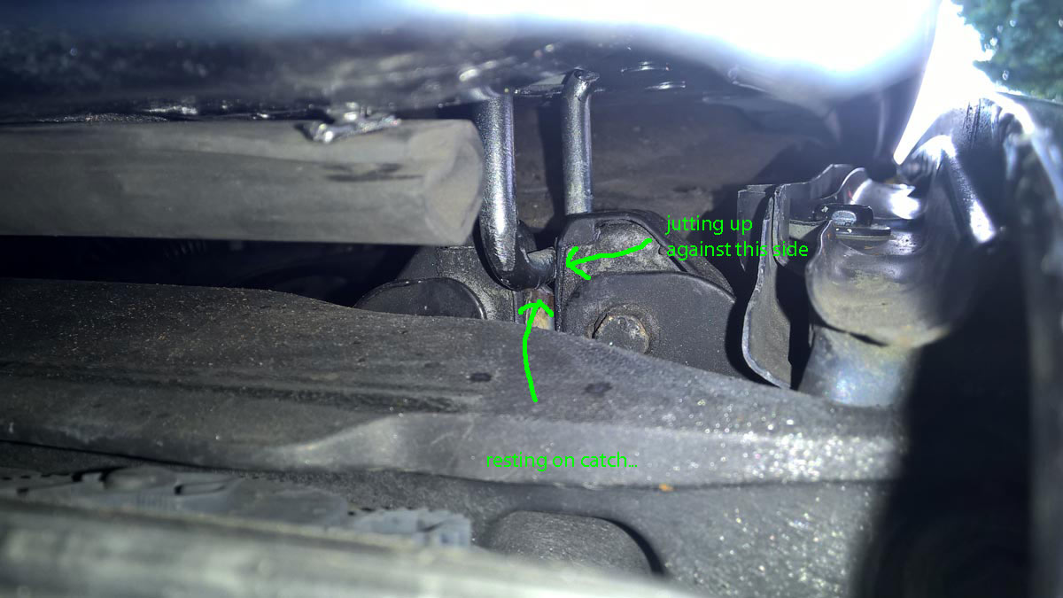

I lubed my latches with white lithium grease. They're working fine. But my hood is still getting stuck.I haven't tried any felt pads (I couldn't find them.) But I did notice two things:
1. The driver's side catch is "lower" than the passenger side. By a few mm.
2. The driver's side catch is angled (probably due to the less than stellar welding I had done to it), so I moved it over a little by loosening and repositioning the 10mm bolts.
And... The hood is still stuck. I was looking to see if there is any way to "lower" a latch. And there doesn't seem to be a way. You can move them side-to-side however.
Attaching pictures below of my horrible hood!

Hello there,
The only thing i can think of offhand is maybe bending the catch a little, if it only has to move over a little, but you should ask someone else here if that is reasonable as i dont know what it takes to break one of those off. If it broke it would have to be welded.
Another more drastic idea i had was to cut off the catch completely, drill two holes in the hood in the right place, and install a "U" bolt to act as the catch. Sure, that would expose two bolt ends on the top of the hood but they could be cut to length just above the hood and use chrome plated cap nuts to tidy up. There would be two cap nuts showing on both sides of the hood. This would be extremely functional because if the hood doesnt lift you can just undo the two nuts on both sides.
Downsides are it would not conform to the original Volvo "look" if you are worried about that, and also the security of the engine compartment would be somewhat compromised because anyone can come along with a wrench and undo the four nuts and gain access to the engine compartment. How much that matters i dont know because if they want it that bad they can get into it some way anyway, although they may trigger the alarm if you use one. I would bet there is some way to use another sensor though to make up for the possible alarm disfunction however.
