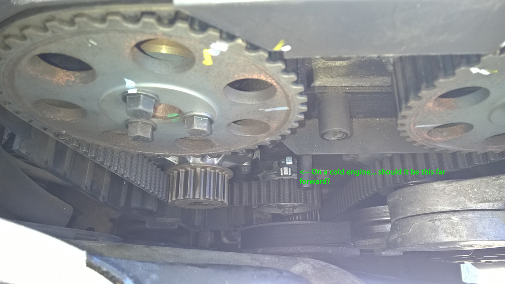

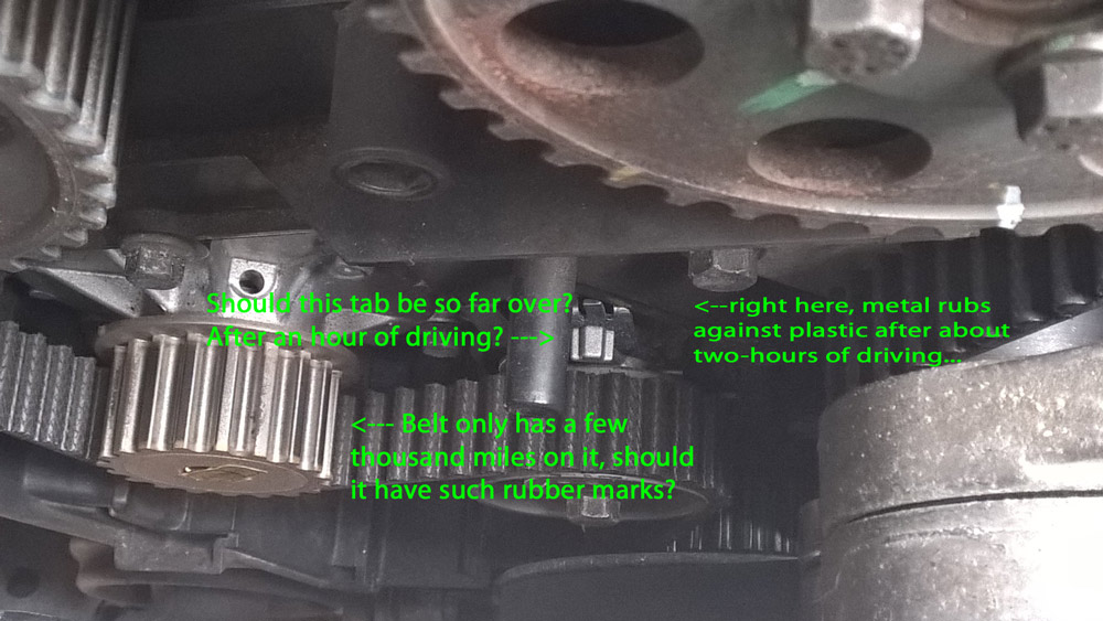

Ah, my timing belt... I did the job about 3K ago. I cracked the lower timing belt cover a little. Car sounds great. No hesitation. No misfire codes. Idles perfectly at 900. Weird issue though, after about two hours of running, I get this weird "plastic rattle/spring/tinny" sound when going over bumps. (I cannot recreate this sound on a cold engine.) I opened up the timing belt cover the other day, and it was pointing to hot on a cold engine. So I readjusted it. (That was about 600 miles ago.) I have gotten the noise a little less, but it is still there.
I took some pictures of my timing belt because it's lack of precision--unlike the hydraulic tensioner--strikes fear into my heart! I also wanted to start another thread on this... But, as this is related, I'll just post this here.
Looking at the timing belt on a hot engine, I saw the little tab pitching forward like so. This seems normal to me. I also noticed where the plastic and a little piece of metal might come in contact. Would that make any noise? And this is the picture of the timing belt during this latest no-start fiasco. On a cold, unstarted, fuel-flooded engine! Haven't gotten over to turning the car over yet. Should I try to crack it while in first gear to see if the engine moves? Or should I just take the wheels off and crank it by hand?

The rattle sounds in the timing path you will want to investigate, but they are unrelated to the no-start. Same with the ECT, you will probably want to get a better one.

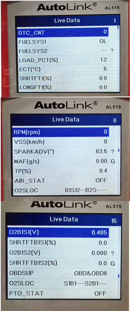

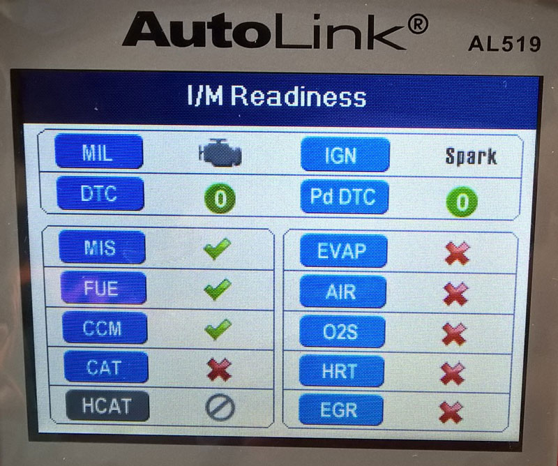

Finally got a chance to hook up my computer to the car... this is what I'm getting. (Can't pour oil into the cylinders because it's raining.
) I am going to research what each of these values mean. But if anyone could tell me if something stands out, that would be greatly appreciated. Thanks everyone.
I've got a lot of x's here!

That means nothing when engine is not running.
Those are live data parameters .

The Xs mean the monitors arent ready to give values - if you recently removed the battery or cleared codes thats normal. If the engine isnt running, not meaningful as misha pointed out.
