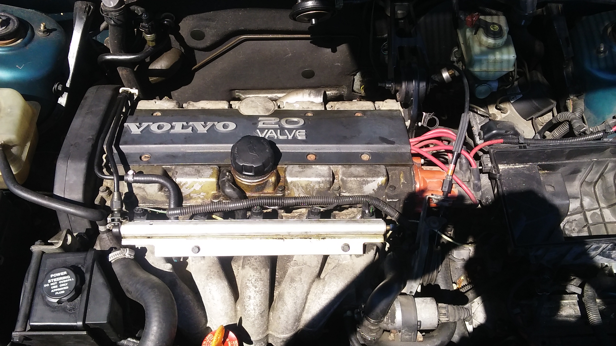

Fuel rail also replaced?
96 & '97 n/a dont have fpr on fuel rail!!!

Gotcha!
They are not different regulators...they are different devices!
One without vacuum line is damper and in that case fpr is back at fuel filter area.
One WITH vacuum line and return line to a tank IS fpr for older n/a cars,just like the one from the picture from previous post.

Same location,yes...but totally different devices.
Cars with return line have fpr in that location and cars without return line have damper there.
Cars without return line have fpr at the back of the car.Return line is also in the back.Totally different setup.

That's good.
You have a set of 5 spare injectors you can use or sell along with extra manifolds and fuel pressure damper.
