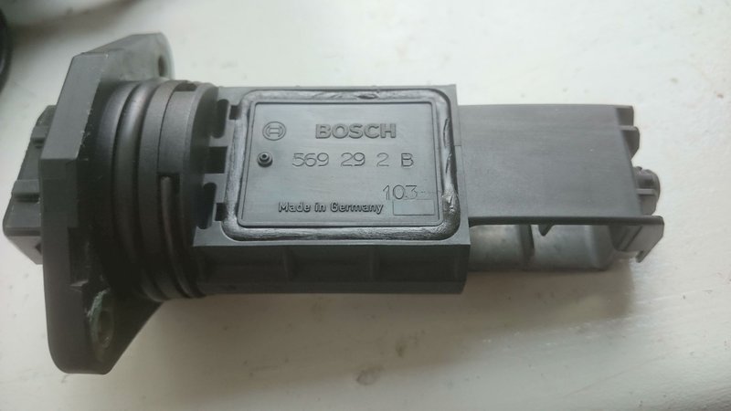

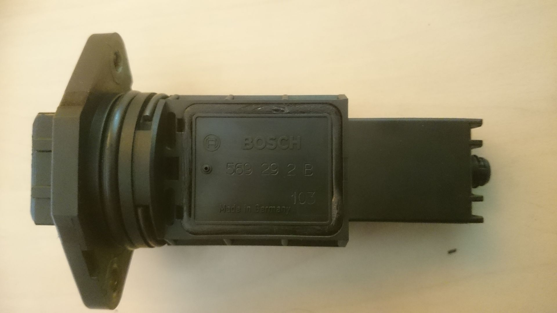

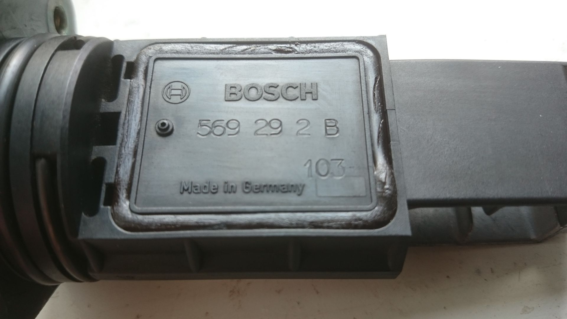

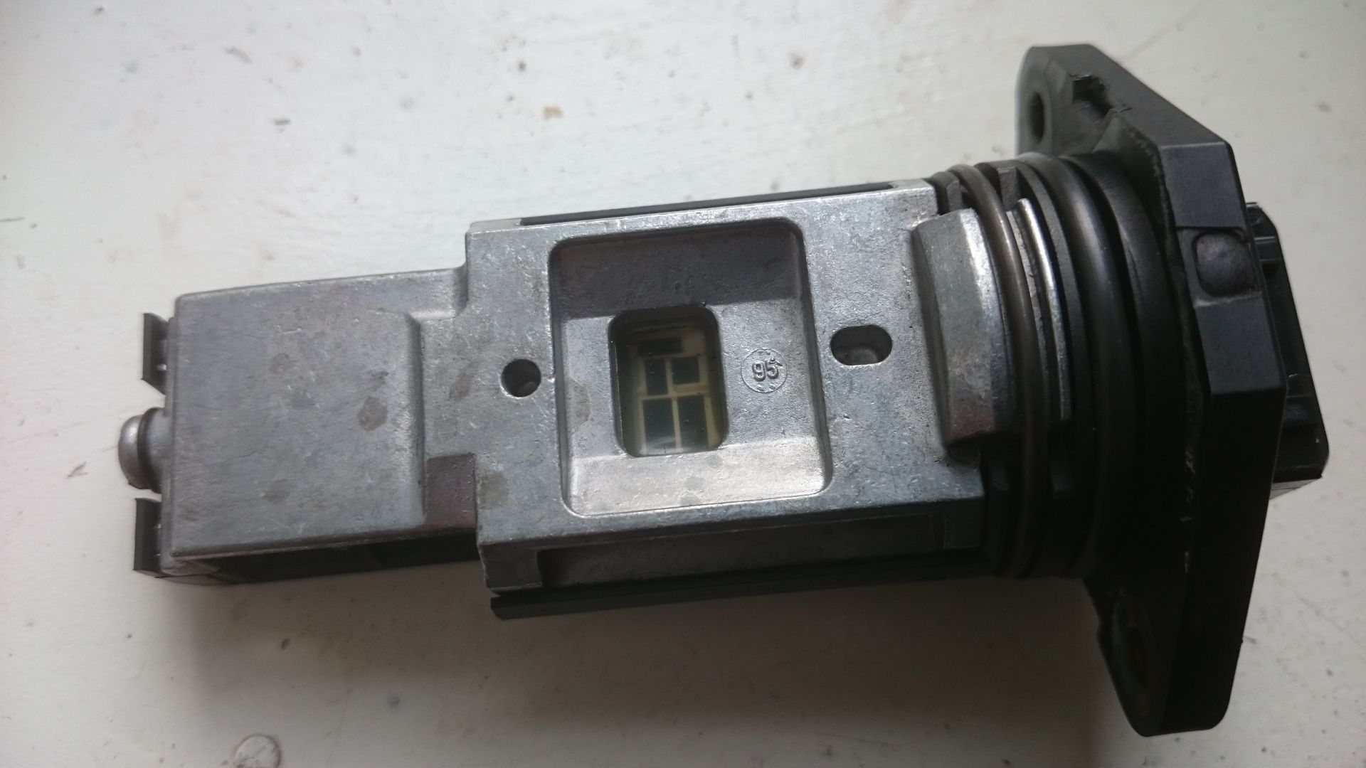

Now I took some pictures.
I read somewhere about this seal on the maf itself dissolving over time and giving strange errors.
What do you think about that?
The seal is soft. you can clearly see my nail pressed in it a few times. It feels like glue that hasnt dried proberly. Very soft and sticky.
To me that could also look like it has been resealed actually.
Wich I also noticed is the datestamp. '95. This is an end 95 car.
Could this be the original? With 300000km on it...
I read of lifespans from maximum 100000 till 250000?
