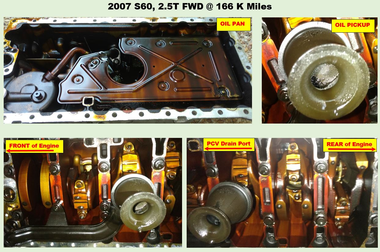

There are three or four gauges I consider to be HUGE troubleshooting and long term monitoring tools... fuel pressure, oil pressure, exhaust temperature, and then boost pressure for turbo engines.

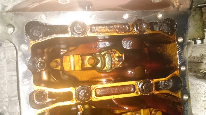

I'll be very interested to see your pictures once you have the pan off. The ones I took of my daughter's '07 S60 2.5T FWD are below, and they were taken at 166K miles. I didn't take any pictures of the pan once it was cleaned, but it looked 100% better, even though I used about 4 cans of Brakleen, some 000 steel wool, and then some 400 grit wet/dry paper on the flanges to prep them for the new Reinzosil sealant (much less expensive than the Volvo sealant, but the EXACT same specifications and is used on BMW's, MB's, and VW's for the same application (and others).

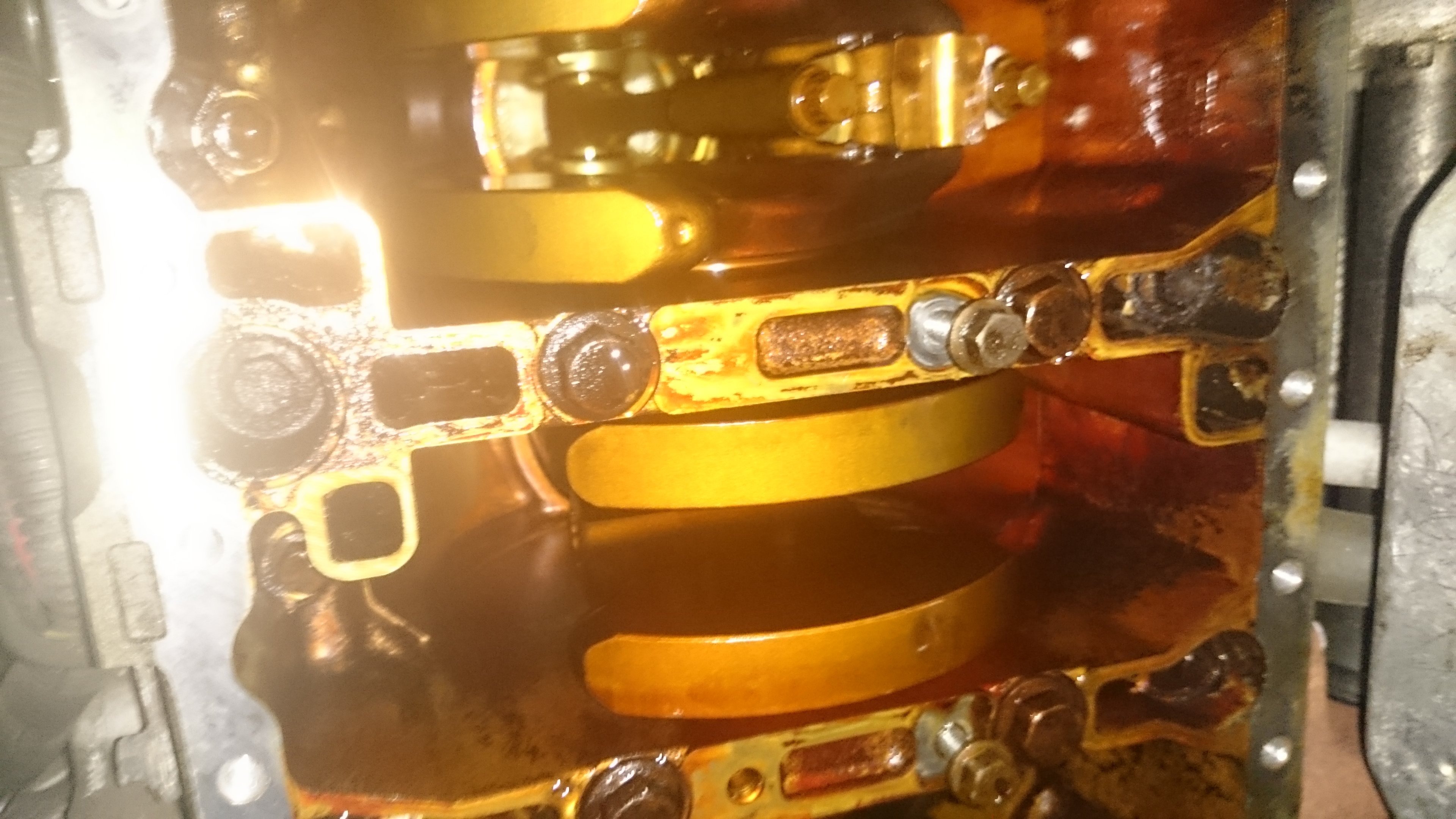

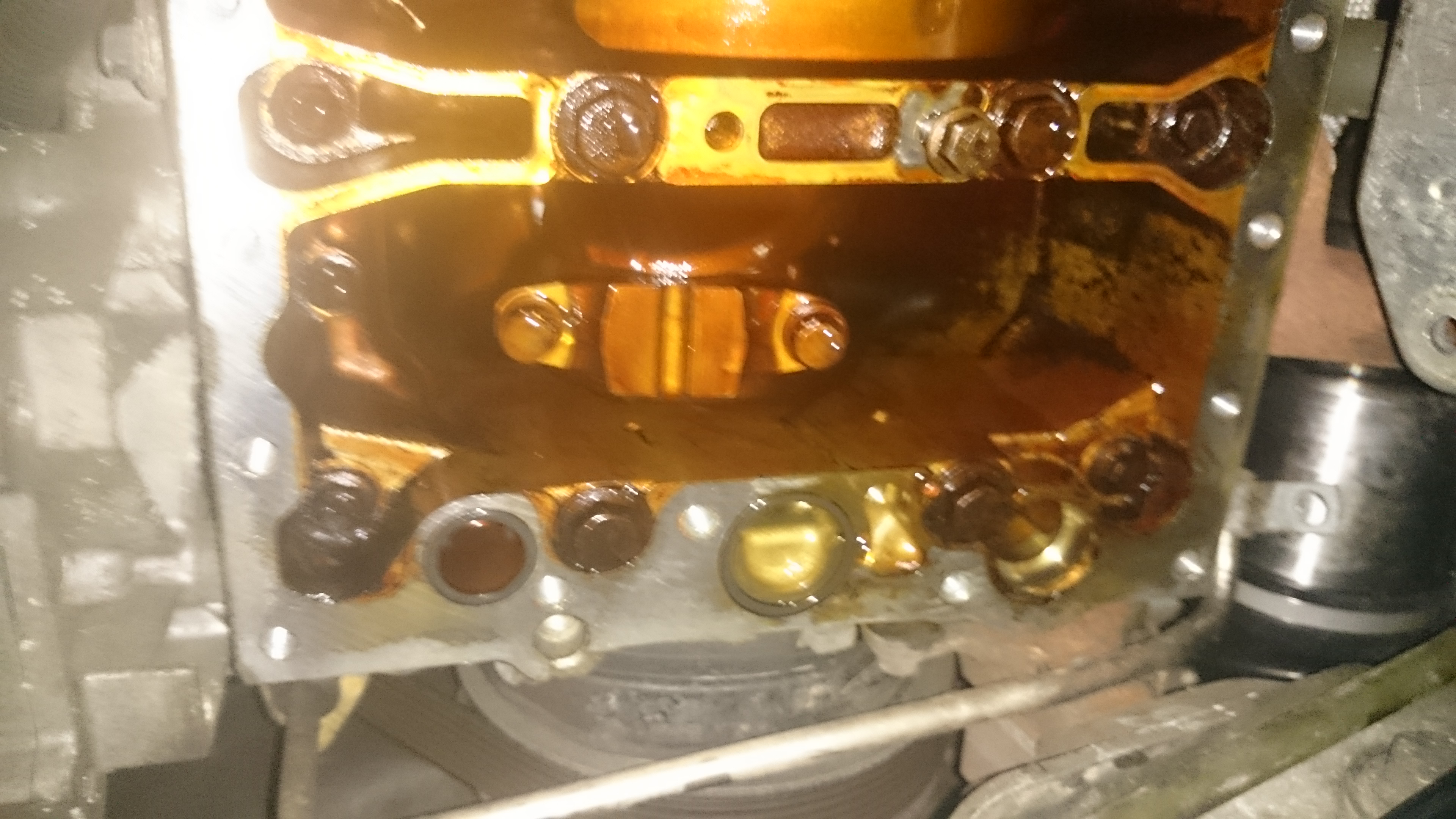

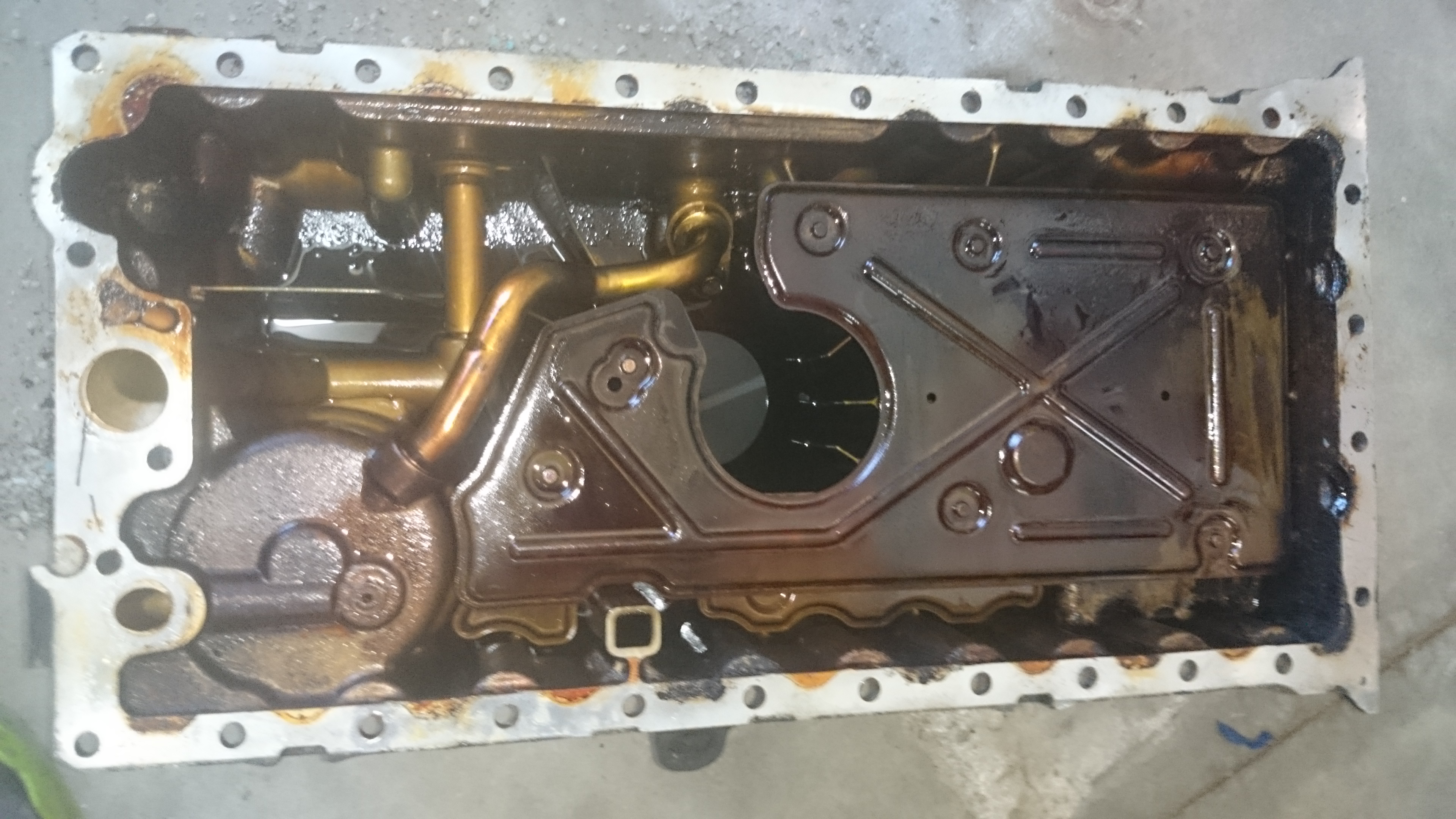

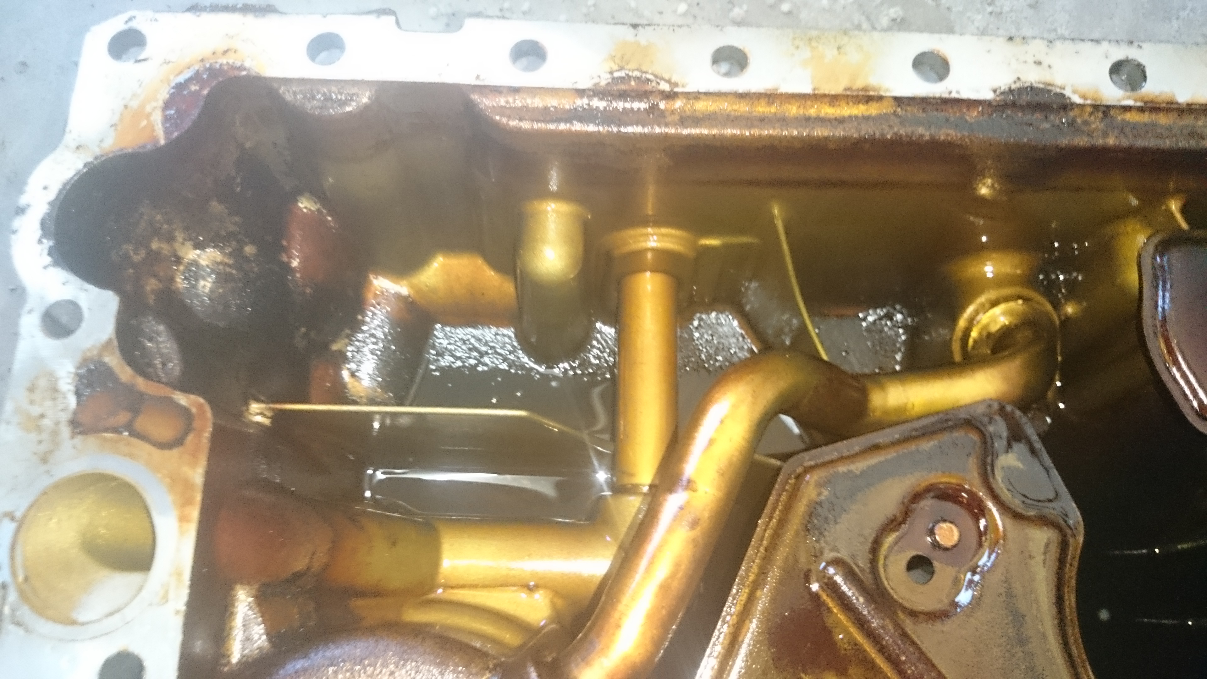

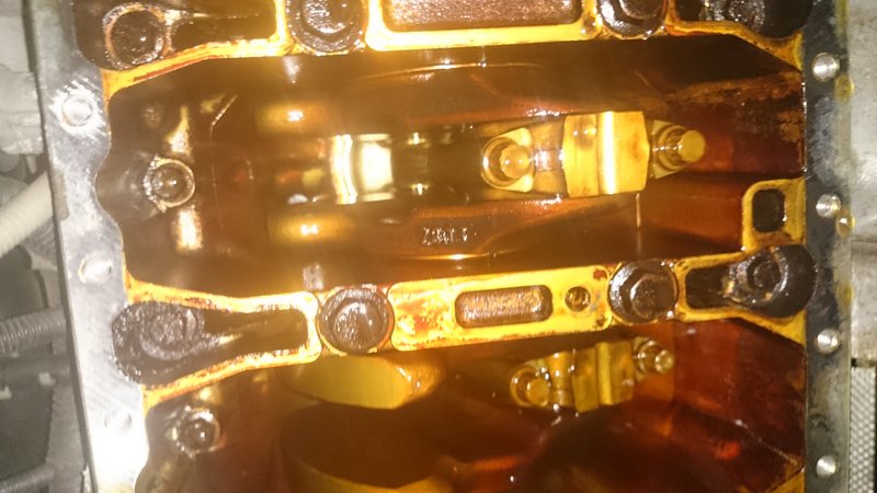

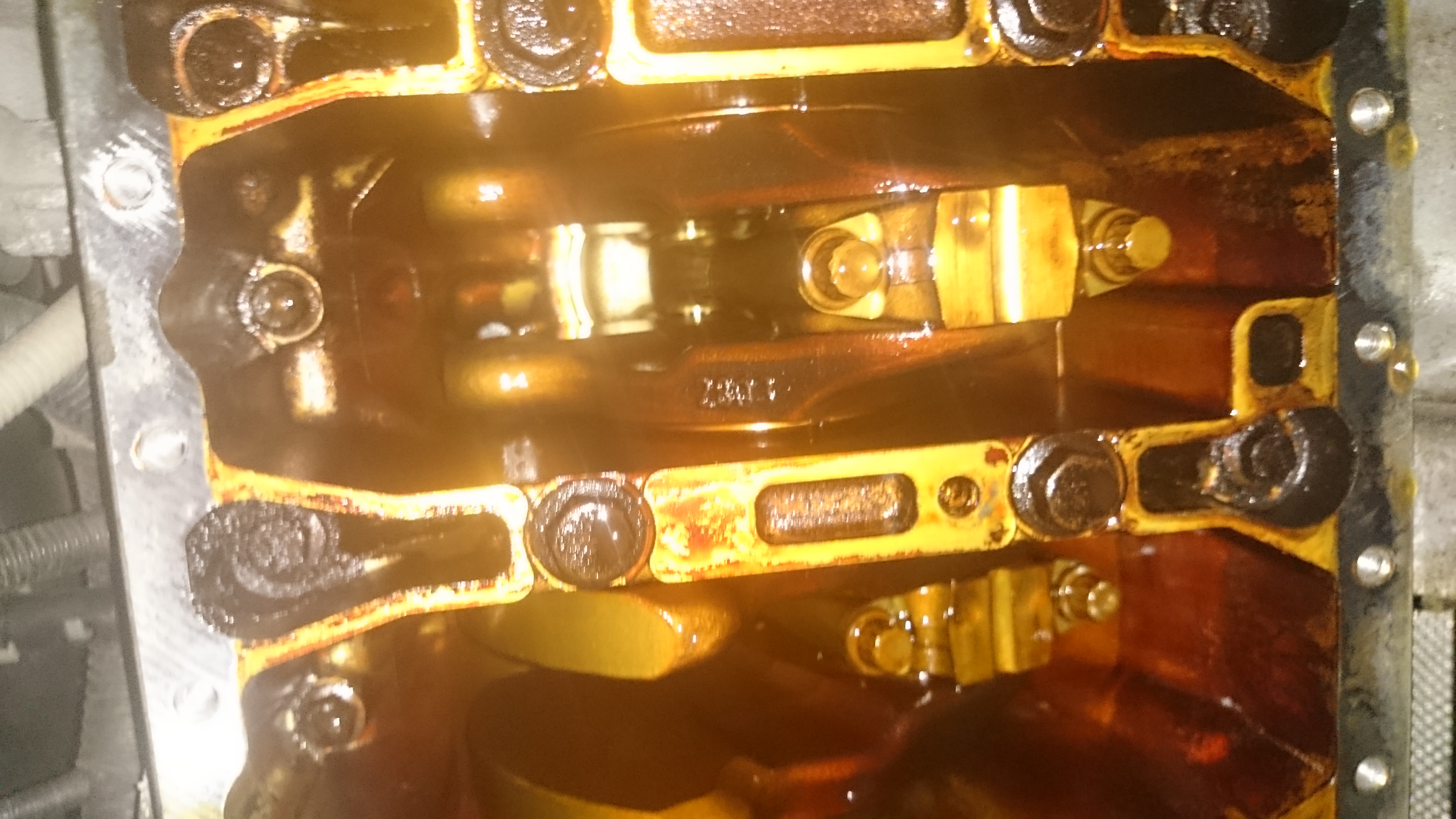

Here are some pictures of the oil pan and engine.
To give you an idea of how bad my luck with vehicles has been lately. I took my dad's truck out to my shop (30 mind away,) to get a part and tools to finish up an alternator install. While I left his truck idling outside, it decided to overheat and blow a hose, it got dark out so I didn't notice the puddle in the gravel and not till I was a minute down the road I noticed the needle on the water temp Guage buried. So instead of finishing getting my car going going I have to spend an hour and half gettng his truck cooled off and getting the hose back on. Thankfully I was just down the road from my shop and had spare water jugs and also a passer-by stopped to give a hand.

Your varnish looks "younger" than mine did... a little less color variation and not quite as dark in places. Perhaps my previous owner(s) were not as concerned with either oil quality or OCI frequency. I also had some crusting inside my PCV drain, all the way down at the bottom, and it was completely plugged at the top of that vertical port in the block, and yours looks fairly free of crustiness (at least at the bottom opening, anyway).
