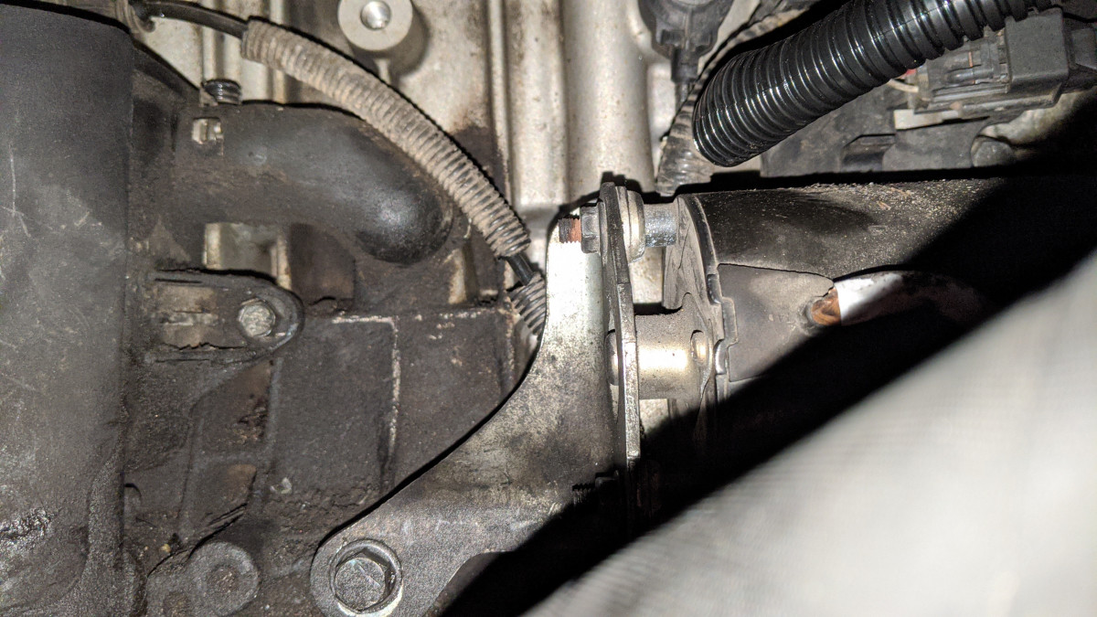

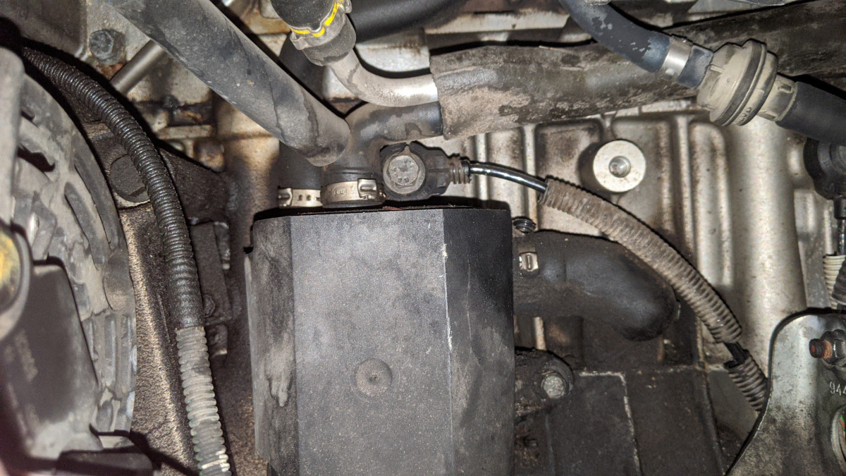

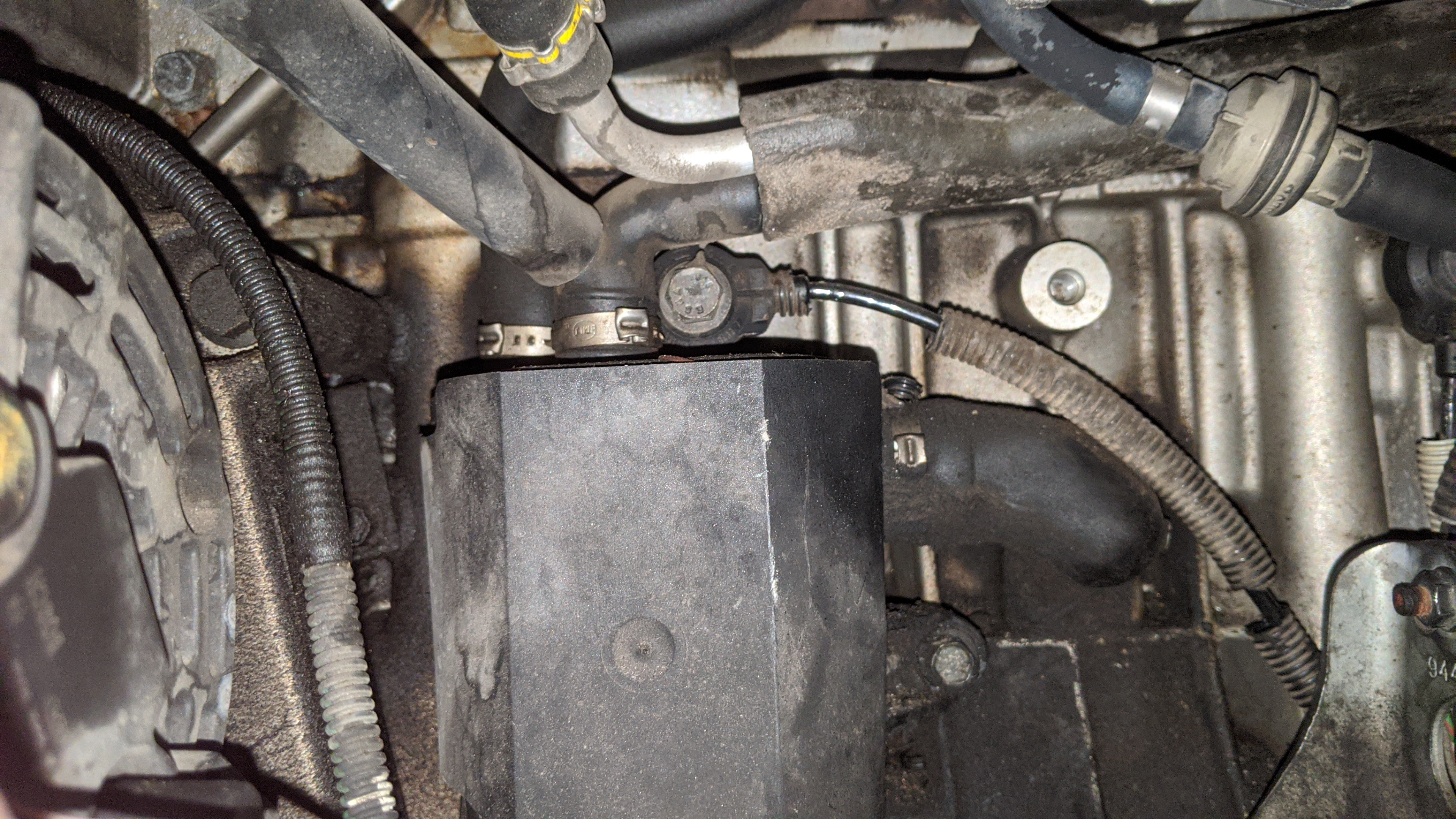

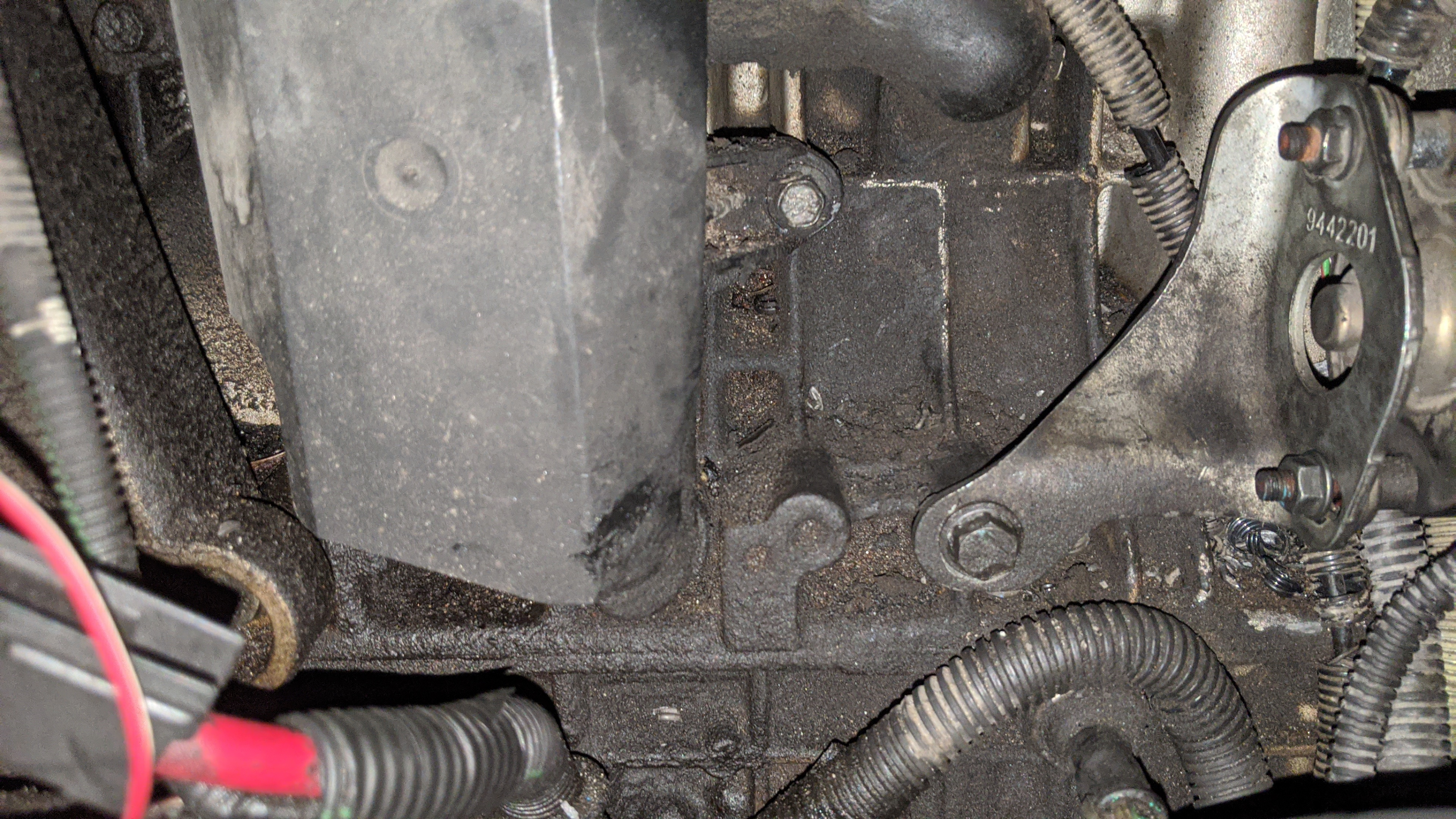

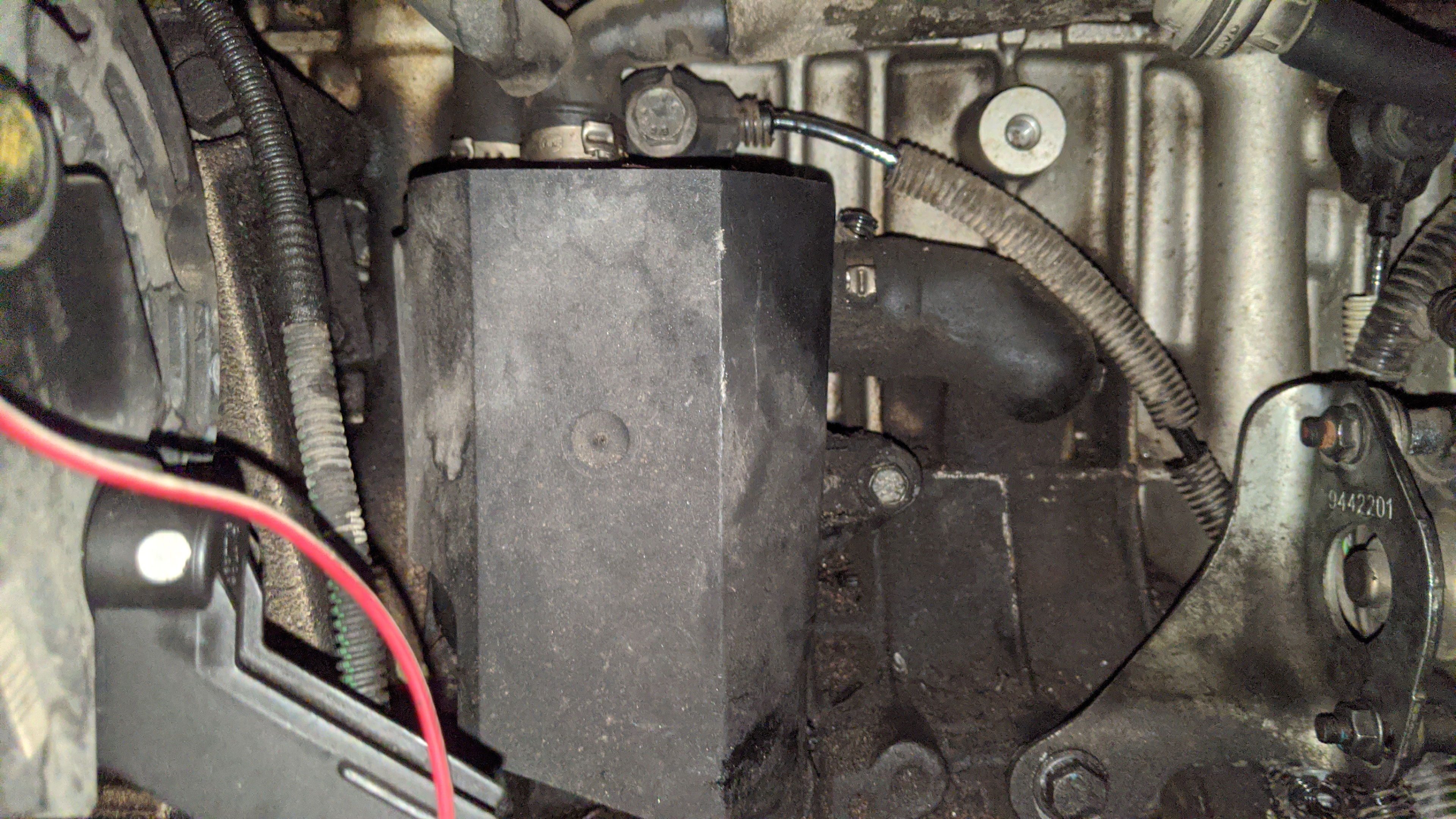

Was this close to ordering the parts for the PCV job then I got cool feet and chickened out SMH. I'm just going to put back the throttle body back on tomorrow morning and put all the parts back to normal. I stuck my phone under the manifold and snapped these pictures....not sure if there's anything that stand out ??
