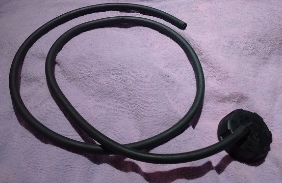

I bought an extra oil cap on ebay and I'm going to drill a hole through it, stick
a Elbow fitting into it and run a vac or 1/4" ID line down to road level.
Inside diameter of vac line elbow is 3/32" and for a 1/4" elbow 5/32, I'm inclined to
use the 1/4" with 5/32" elbow but is that too much, will it throw a ECU vac leak code?

Here it is used the 1/4" ID line. I like this because my son can put back the old cap
without having to fuss with a splice in the original hoses. I also might leave it in
since it provides some safety against blowing a seal at anytime down the road:

This did not work, since the new hole in the center is in an area that vents outside through the
half circle holes around the perimeter. Oil leaked out through those holes and we are back to
the old cap with the dip stick out a bit.
I need to make the vent continuous from the hole in the bottom side, if I even want to bother
with it. Then I wonder how much oil will run out the hose, would like to avoid too much.
The design of this cap is a bit of a mystery to me, It looks slightly spring loaded - good,
but it must be so tight that the engines blow out seals rather than it doing its job -bad.
There does not seem to be any path from the inside metal area to the perimeter vent
holes in the normal configuration of the cap - what are they for?
Edit: On a closer look this is not designed to be a pressure relief vent of any kind and the
perimeter half circles have nothing to do with venting in normal operation.
