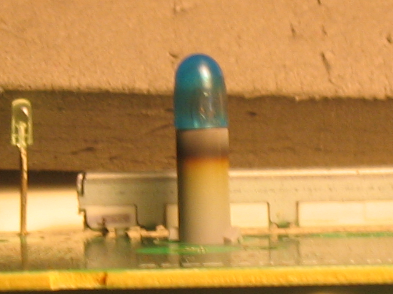

Evidently not all of them as this one is orange/red. I understand it's not the bulbs. I pulled them to discover they had blue covers on them with brown overheated spots. So I removed them all. You can see photos posted above. The ECC I pulled looks exactly like the one it replaced.

misha wrote:I had never seen amber or blue illumination on ecc panel or switches on these cars.
5/1 is the Combined Instrument Cluster (COMBI). The wire highlighted in RED is the voltage signal proportional to vehicle velocity. This wire is connected to the ECC as an input (C1 with arrow pointing to the right).Sleddriver wrote:BTW, the ECC I pulled from the JY has ORANGE backlights instead of GREEN. Odd that. Even odder, is that as shown above the bulbs were covered in BLUE vinyl covers!! Removing those had increased the brightness.

Ok,i see....i'm just saying that i didn't seen anything but stock green illumination.
I've seen those little bulbs with vinyl covers available from Volvo and i wonder if they are an upgrade or from later models.

Re: Blue covers. Very odd that. Why change white incandescent light blue when the dash light is green or in my case orange?
