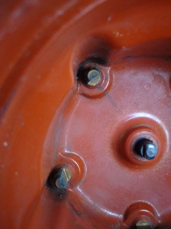

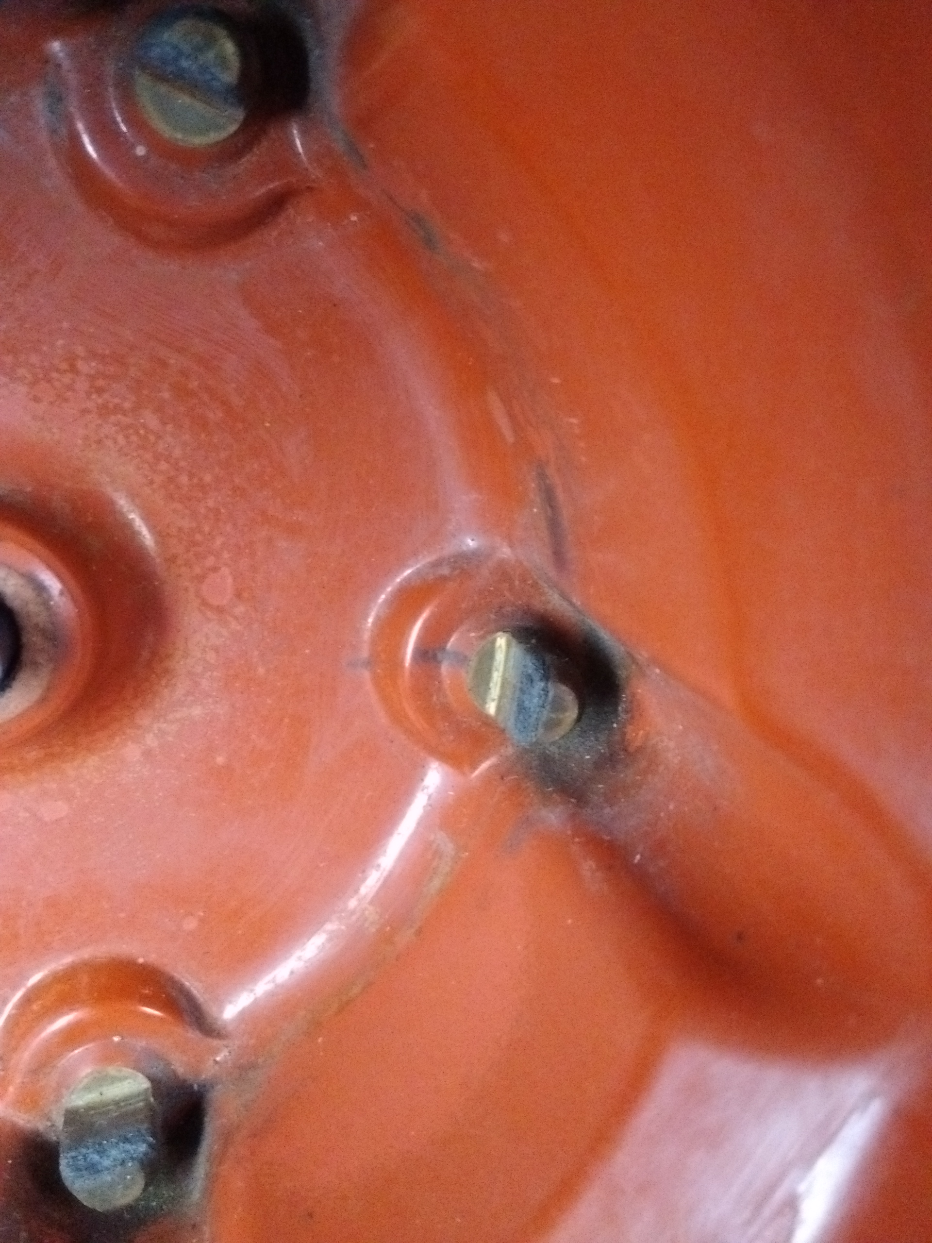

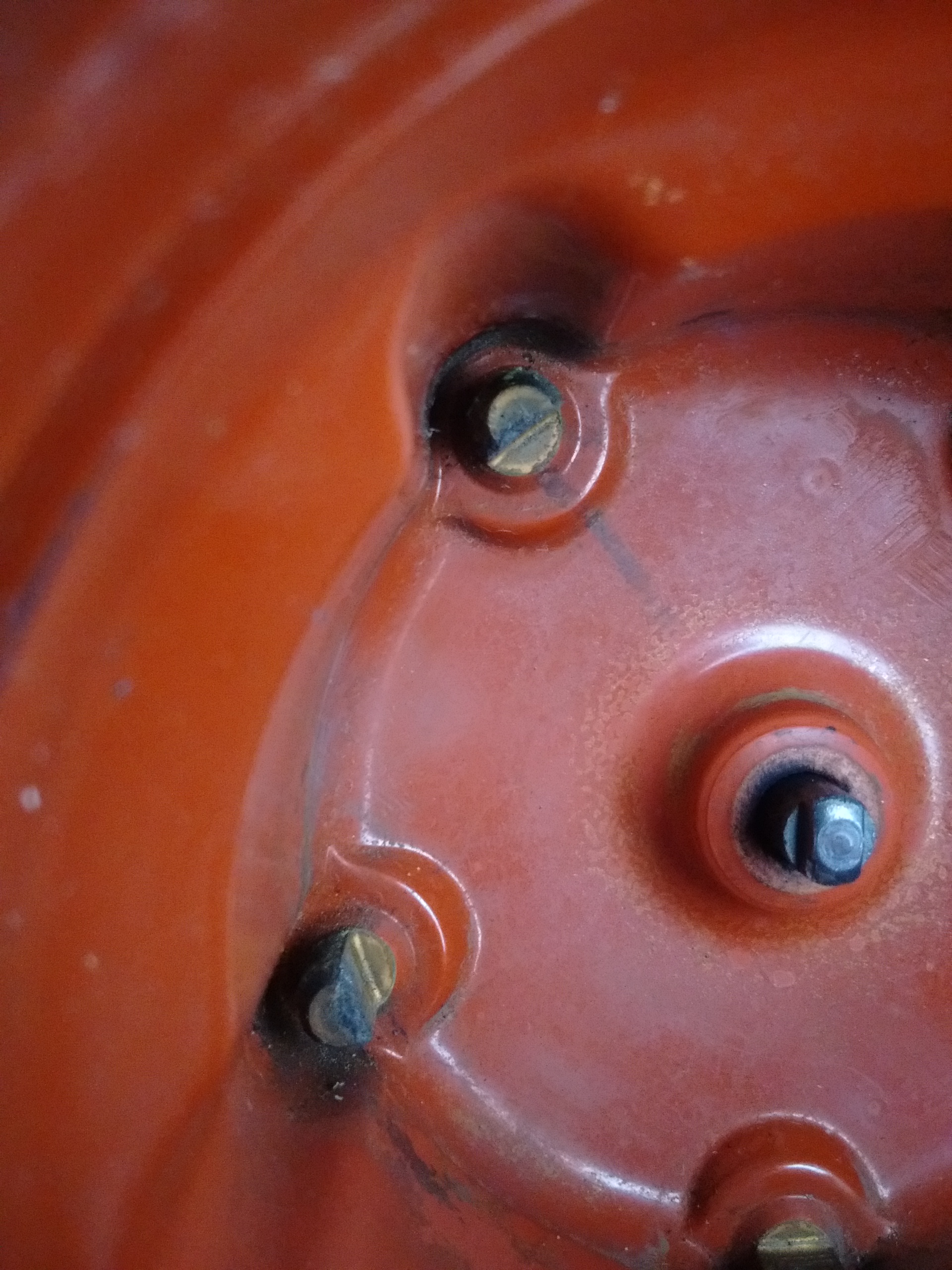

I did. Doesn't make sense it should be rotated 180° like that. There's a reason the large flat area faces towards the middle terminal.erikv11 wrote:Look more carefully, compare where the shiny part is on each contact. It's fine, they are all the same! None are ackwards.

I think it is just an illusion in the picture.

Sorry, my post was obviously not clear: what abscate said. The pic is fooling you, nothing is rotated. The "large flat area" is the shiny part, it points to the middle on that contact, as on all of them.

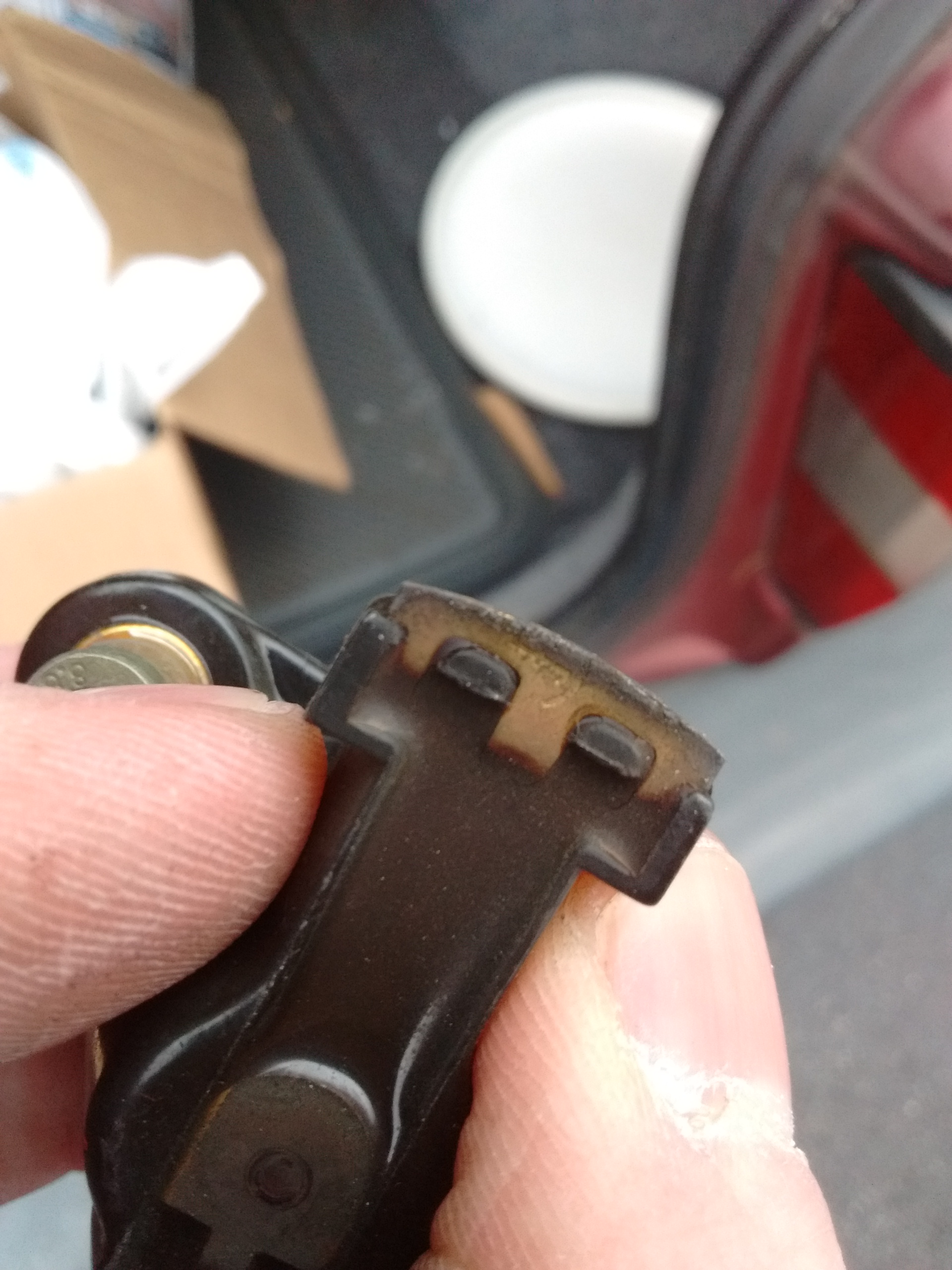

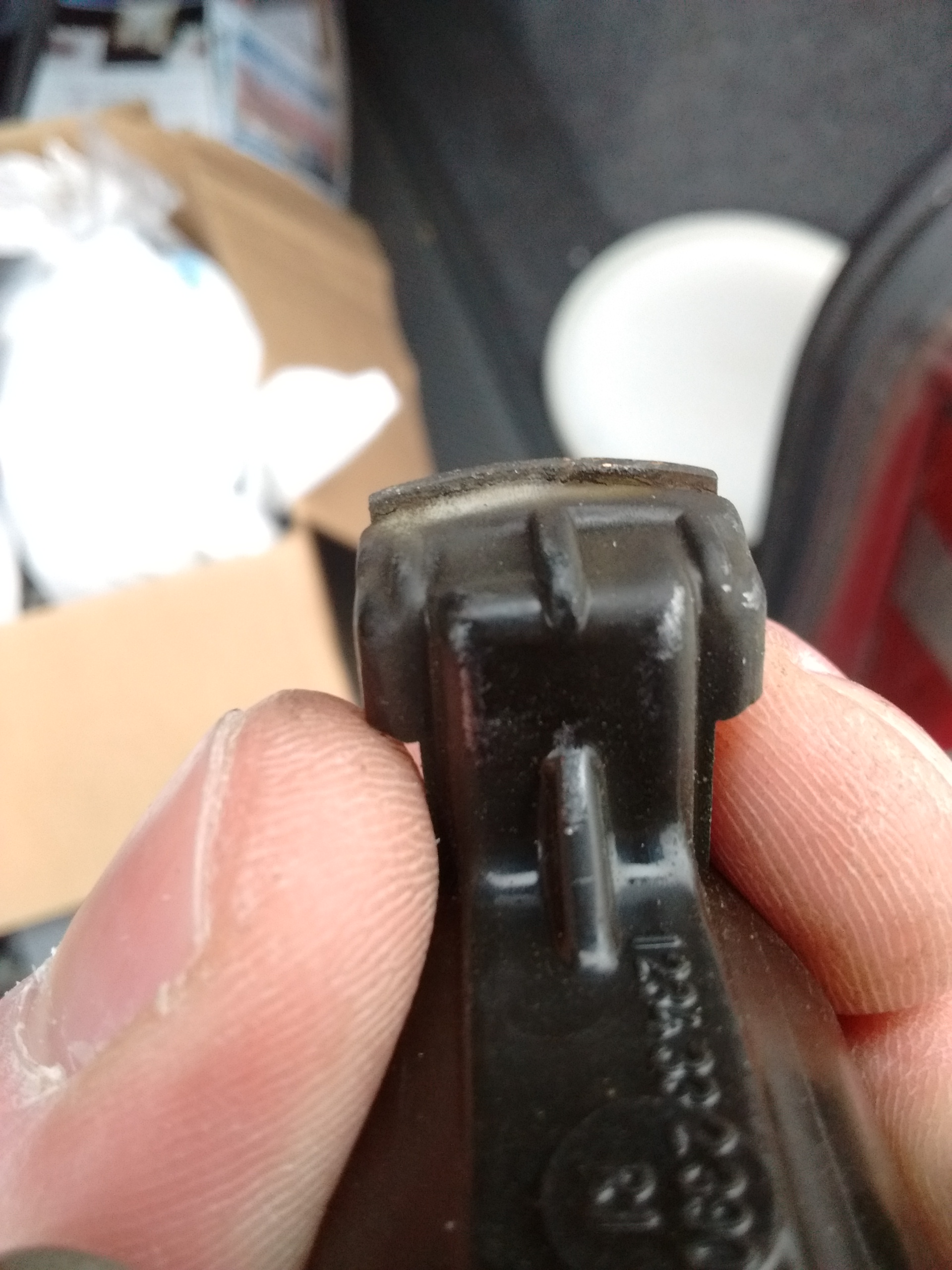

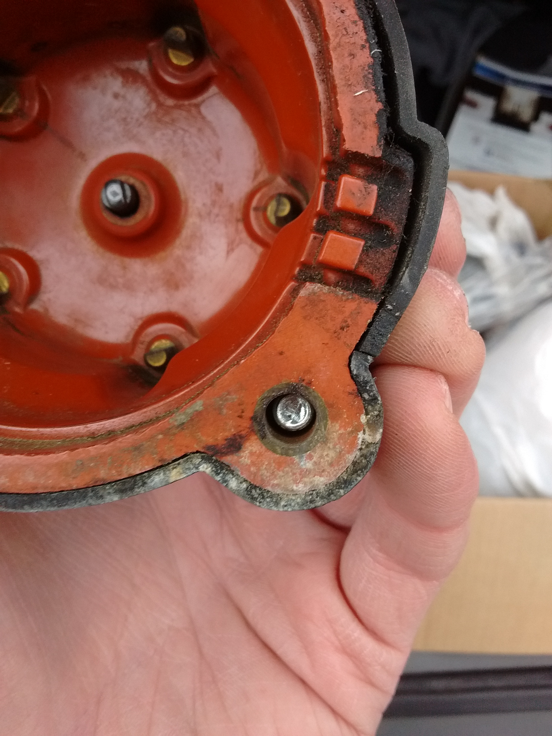

New cap and rotor installed. The car started and ran normally before changing the parts, and it continued to do so with the new parts as well. I drove it around for a few miles, and all seems well. Fingers crossed that was the issue. Attached are some pics of the the old cap and rotor. Clearly they were due for replacement.

Gnarly looking cap and rotor. I'm surprised it ran at all. Dont remember reading but did you replace wires and plugs also?
