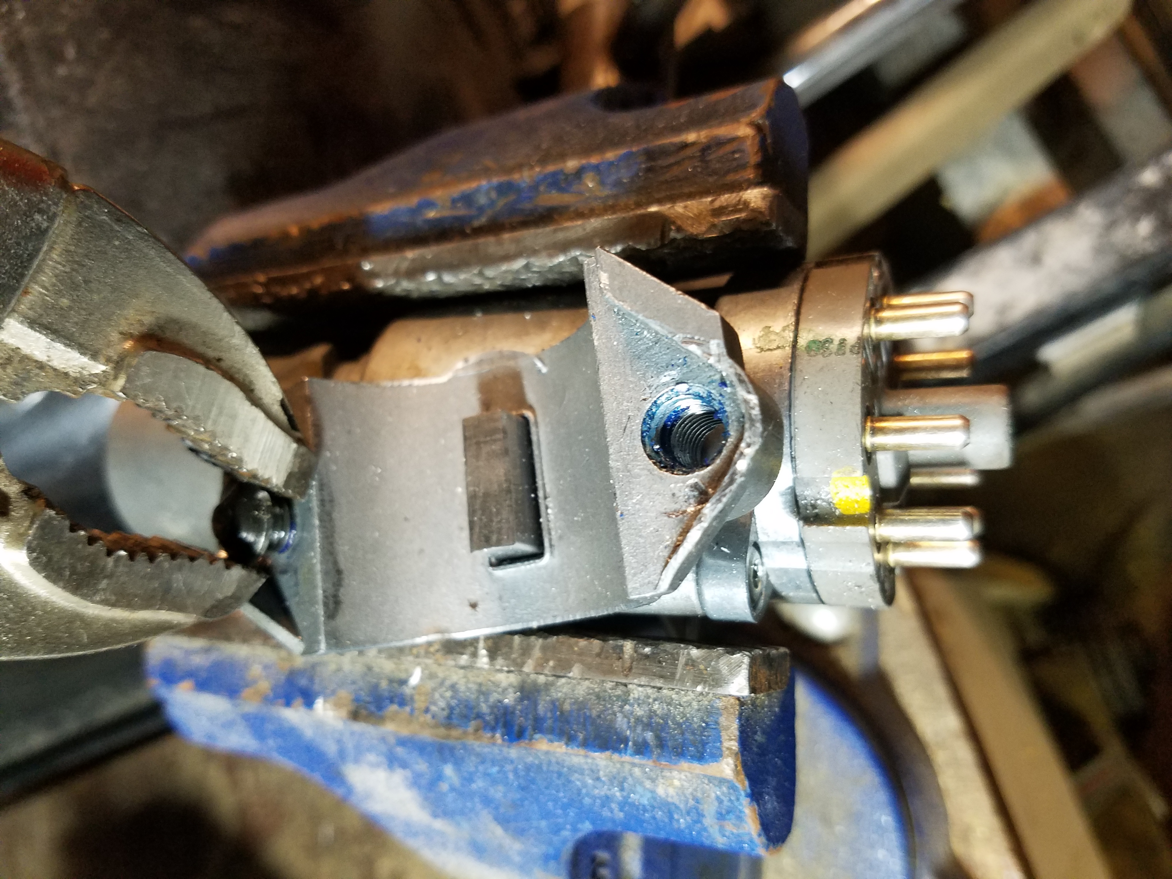

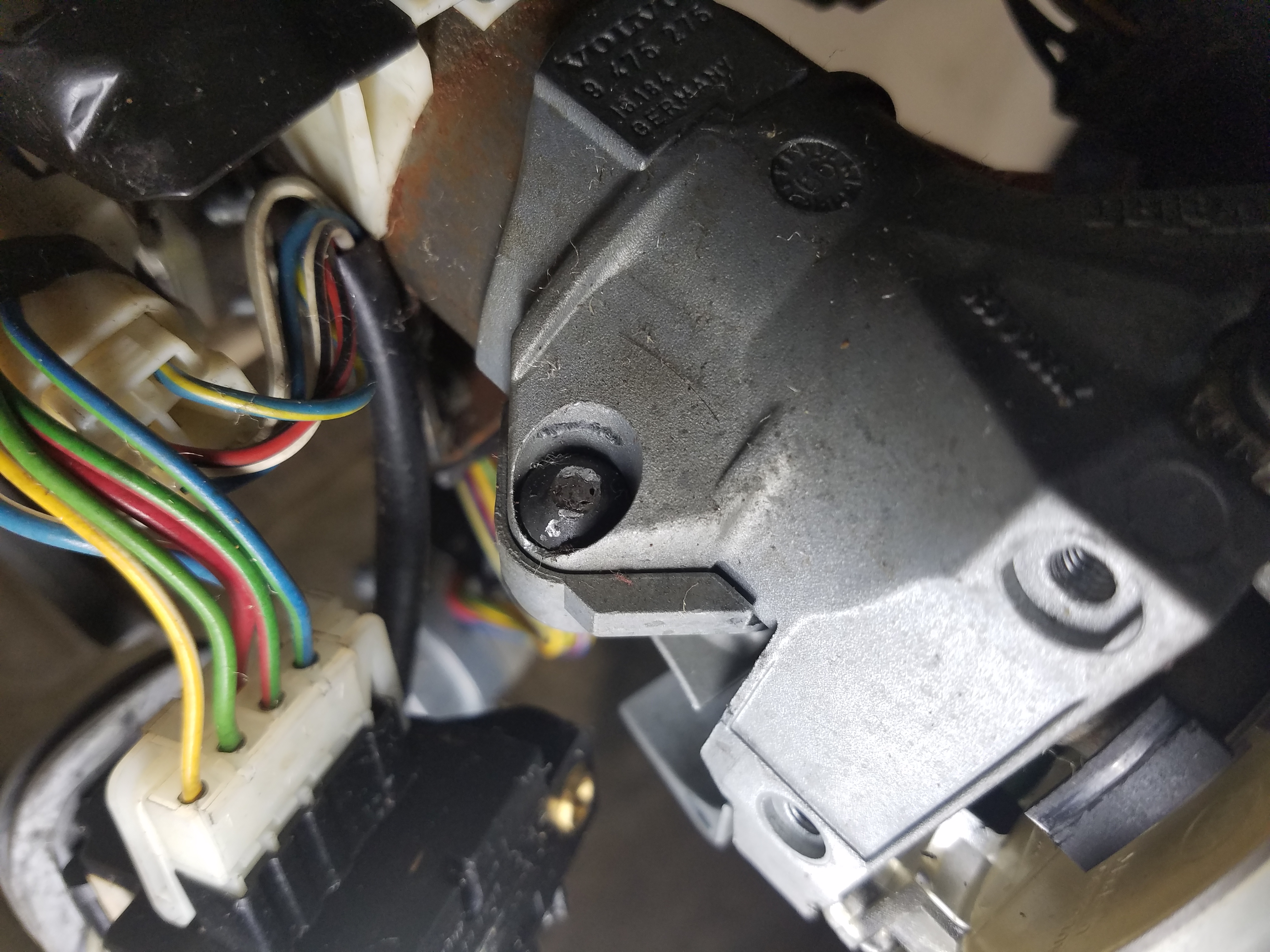

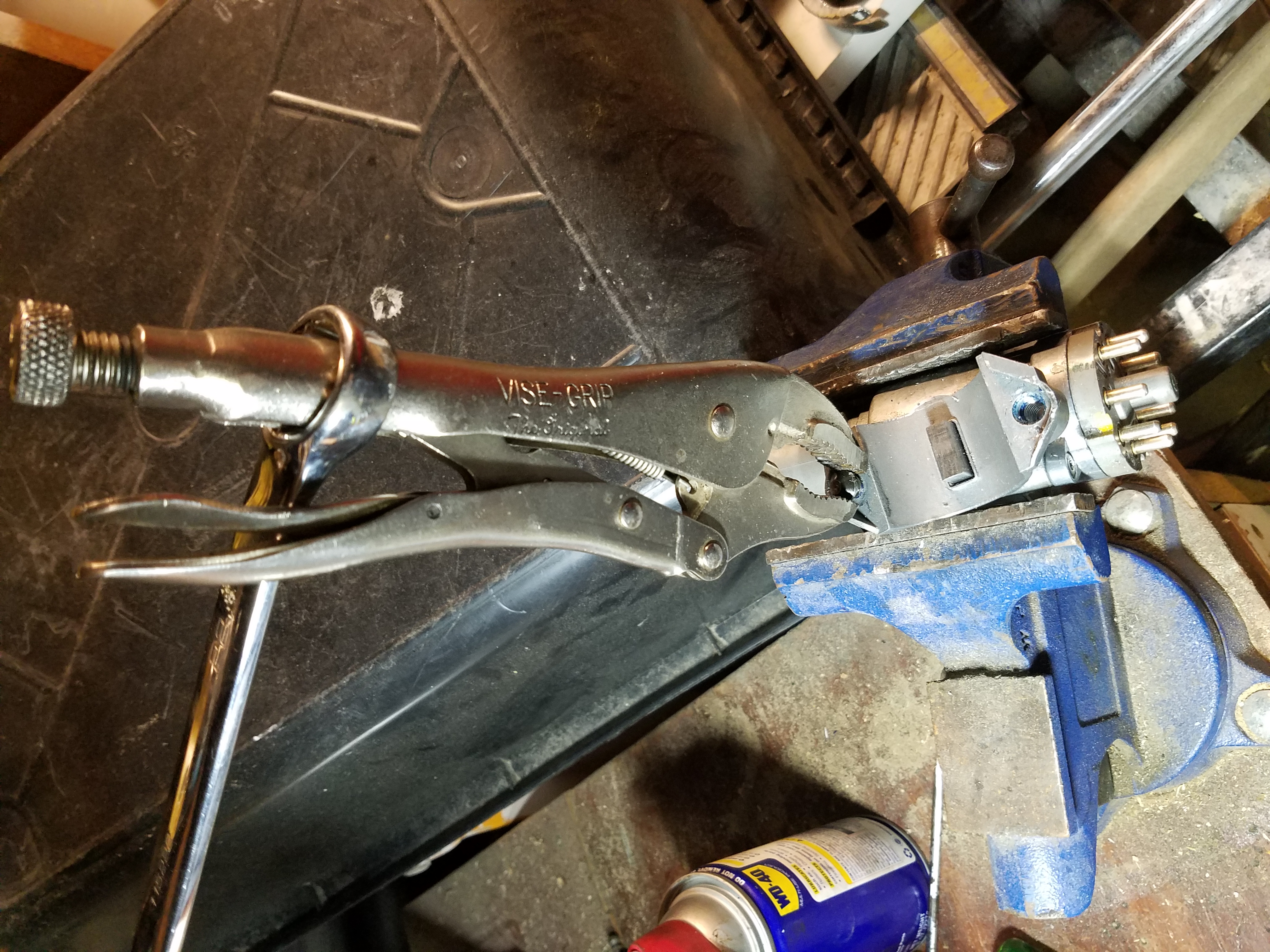

The ignition and key assembly arrived yesterday and I was having trouble getting the shear bolts off. Any ideas guys?
Got the ones out of the new assembly by using a large vise grip and wrench for torque.
How am I supposed to get these out?!

I suggest using a punch and a ballpene hammer to get the screw to turn. I am surprised to see blue locktite on the screws that came with your new lock. Does the new key work in the door and glove box?
