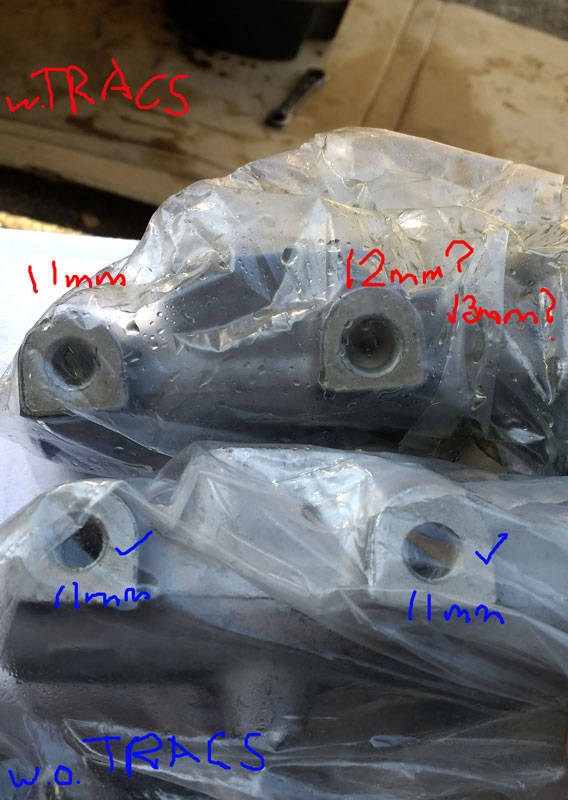

Thanks for the support, guys. Waiting on UPS to deliver the 98 S70 master cylinder (no TRACS) model to see if that one will fit... It's out for delivery as I write this. If not, really need to think this through.

So the problem (as I see it...) is that our car (1998, Volvo S70, N/A, MT 5-Speed, BASE) takes the WITHOUT TRACS master cylinder. (Which makes absolutely no sense since when we bought the car it had a TRACS light on the dash and the ABS module I ordered from Midwest ABS was for a car with TRACS! And it was the same exact one that I pulled from our car...). There seems to be a little bit of miscommunication here.
I haven't been able to fully bleed my master cylinder yet and will try to finish that up tomorrow...
Thanks for all the support everyone. The car's not perfect right now. But she turned on... And didn't get any weird noises... Whew...

Brake master cylinder summary
Chassis break at 1998 1999 model year
Master cylinder needs to match TRACS application
Confirm fittings size before ordering
Abscate shamelessly pimps one 1998 and one 1999 in stock as used parts
