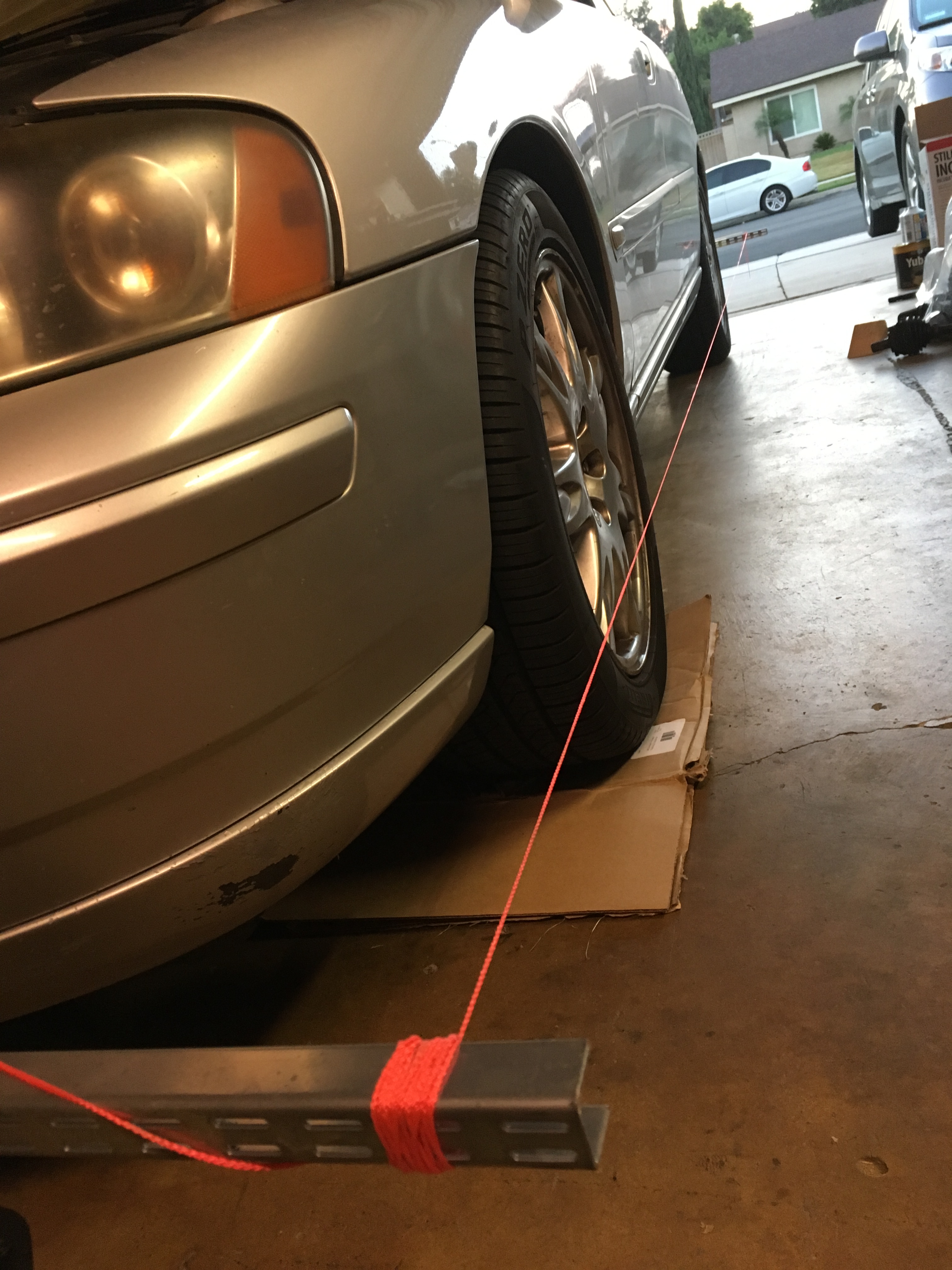

Did a string method wheel alignment last night, forgive the tilting horizon - one too many beers?
Got it pretty darn close. Car drives fantastic, tracks straight and is quiet and solid over bumps. Steering wheel < 5deg CCW of centered, which is easily corrected by equal ~ 1/8 turn to both outer tie rods. But I'll leave that for Thursday's for-reals alignment by the pros and I'll call this job "done".

I too did myself the geometry for the past 10+ years with uniform tire wear as a result. My approach is a little easier, just measuring with a ruler the distance between the tires first behind then at the rear and compare it. Don't forget the camber adjust at the struts, I prefer having it on the negative side.

not much adjustment range on the camber. I didn't touch the top of the strut, and when I attached the knuckle I pushed it towards maximum negative camber. Will find out Thursday how far I was off

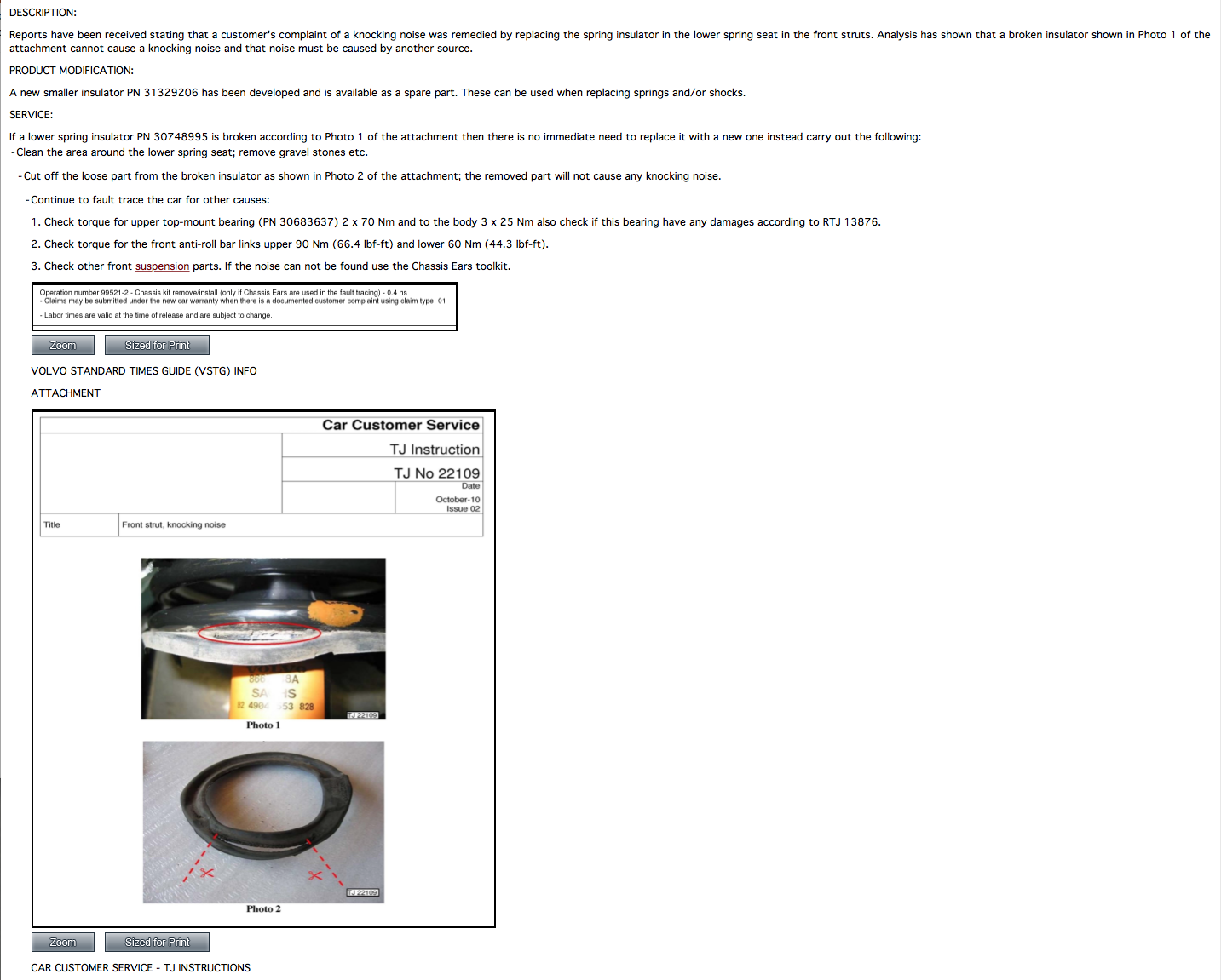

and to add TSB xxxx to this thread
