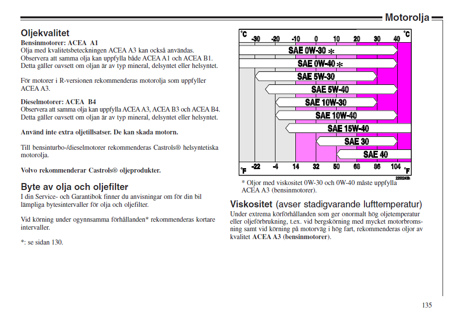

These recommendations do differ for different markets. There are differences between european sold cars and NA sold cars. Attached is the corresponding page on oil from the Swedish V70 owners manual for MY04. The manual does not however contain the service charts, these are in a separate booklet which I do not have a picture of on hand. I do however know that a european spec MY04 has a 20k km OCI since i happen to own one.
And yes, many parts of NA have a hotter climate than Sweden (a summers day here is rarely more than 85-90 f) but there are also plenty of areas in NA with a very similar climate year round. You also don't have to drive that far south from Sweden to find yourself in 100+ temperatures. The oil spec however is quite different I'm sure.
As for 10k miles OCI, european 850s used to have the same (15k km) from the first year and on without a requirement for synthetic oil.

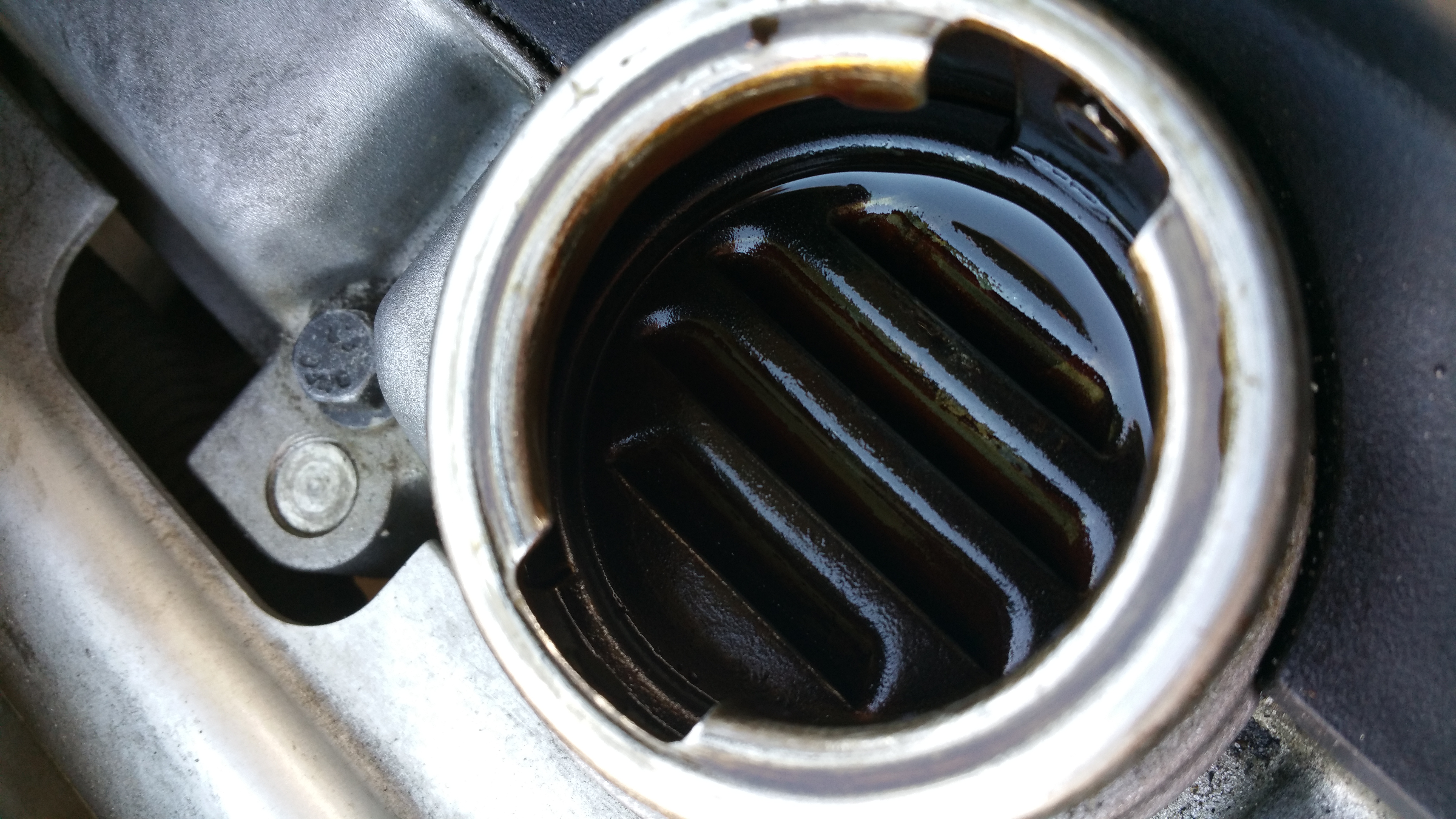

Here is a picture I took of my 2.9 T6 under the oil cap a few months ago for a thread on synthetic oil required on certain models XC 70. June
