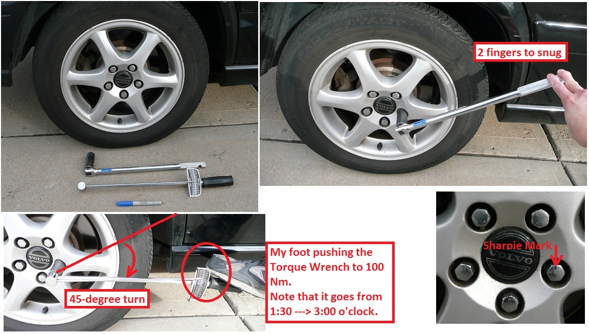

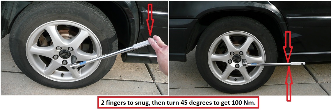

2. Back to my 45-degree trick. I just did the experiment to show everyone that with good practice, you can get to 100 Nm easily.
- I use only 2 fingers to snug the lugs down. You cannot generate too much force with 2 fingers.
- Then marked the lug with Sharpie to track the degrees of turning.
- Set the Breaker Bar at let's say 1:30 o'clock, then go to 3:00 o'clock, which is 45 degrees. I get exactly 100Nm using this trick.
- I wrote a note and throw it in the trunk "2-finger, 45 degrees to get 100 Nm". This way when I am in the middle of nowhere, I know with 45 degrees, I can get to 100Nm with reasonable accuracy. This torque of 100Nm is true for many cars. In fact, I have used this 45-degree trick for 25 years in all kinds of cars, BMW, Honda, Toyota, Volvo without issues. Of course, you can always go with the car mfg's specs.

I've never seen that quantified before but I bet that works.
Very neat
Very neat
