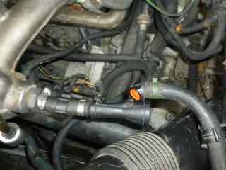

At least I'm tech-savvy enough to drop this pic in. For reference, this is on the driver's side going into the intake manifold. Looks like a sensor of some kind, and probably broke when I had this line laid back for removing the manifold. It was cracked when I found it, it easily peeled back as you now see in the photo. Might this have anything to do with my problems? I'm sure it can't help. I tried taping it into place but that sure didn't help matters.

That's a massive vacuum leak direct into the intake manifold right where it will do its worst.
It's the brake " ejector pump" which is a clever way of making sure your power brakes have boost under all engine running conditions
So, once you get it plugged up and your engine running we'll, you will find you have no brakes.

OK, while you're LOL ... I'm not!!! Obviously it's a massive leak now, but it was just a hard-to-see crack before I went ahead & peeled it back. So now that's identified I'll look for the part(s) to square this away. Wouldn't hurt to check on all the other issues everyone has brought up as well.
Booster Vacuum Ejector? Looks like part # 30665561 ... found it on FCP. Excellent - I like sub-$100 parts. Obviously needs to be replaced, and I would very much like this to be that magic bullet to get this vehicle mobile again.
And ... going back to the original failure, I assume if this failed catastrophically then that could explain why it was running fine one minute and sputtering the next.

Finding a massive vacuum leak on a Volvo translates into Swedish as ...a good start.
Keep looking at all the vacuum lines , take them off. Blow into them and listen, feel for defects
