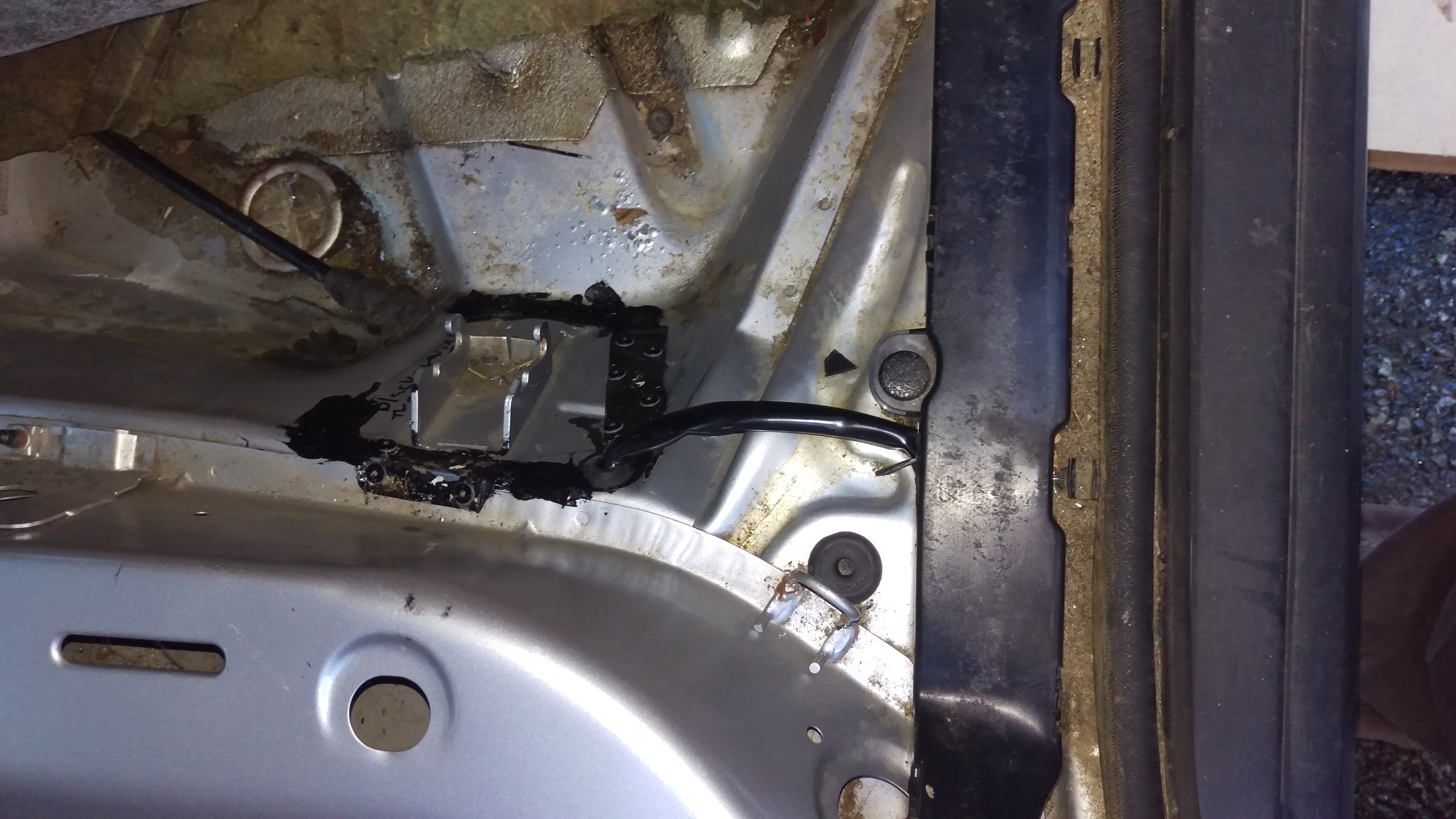

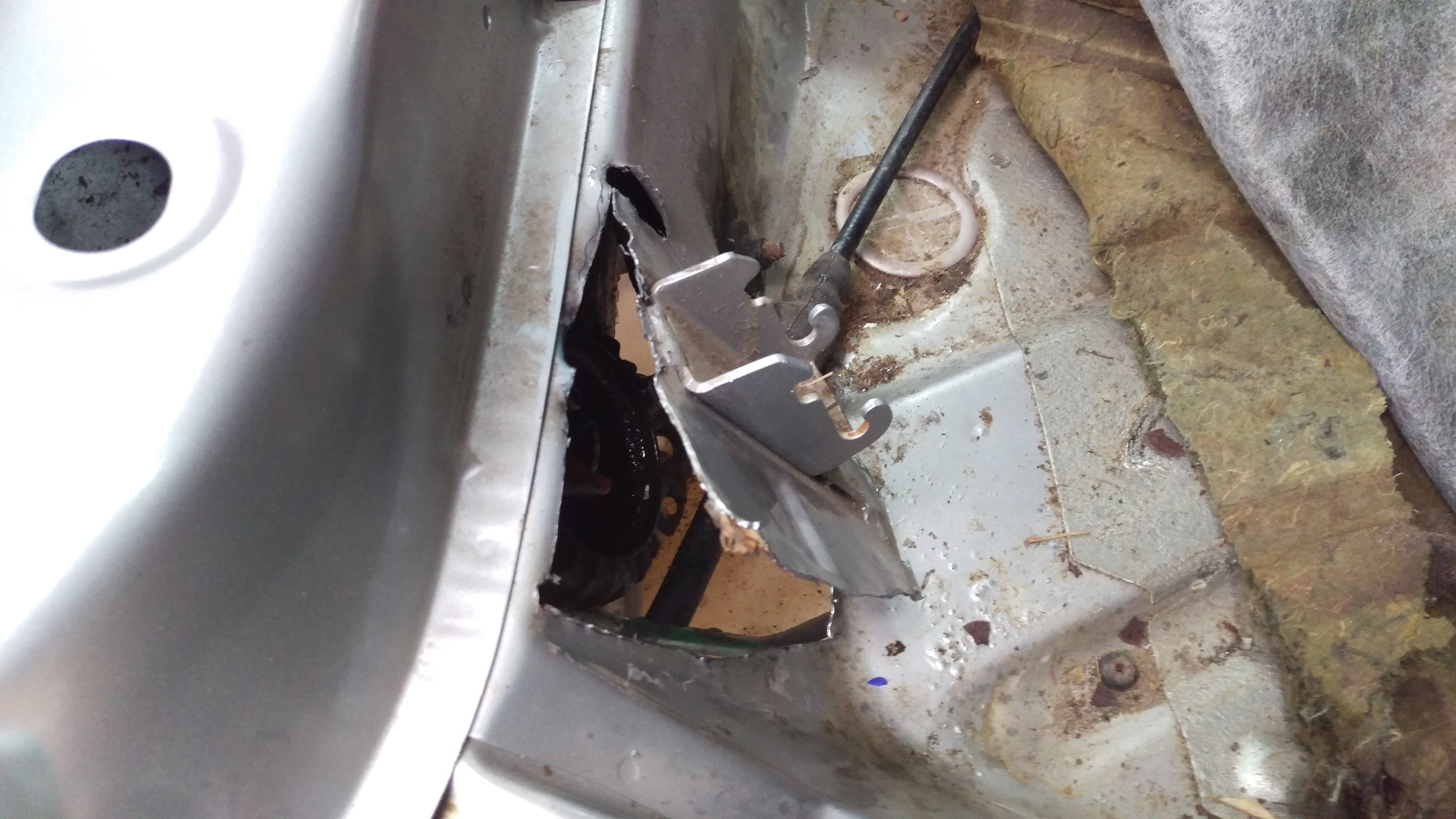

Any tips for closing up the access hole i cut for the fuel pump i put some black silicone and aluminum tape over it.
When I did mine this Is how I sealed the the access hole. I used urethane being a Autoglass tech is the best body sealer I have available. What is not picture is a small plate set over the edges and riveted on before sealing. Also pictured is I ran the wires through a rubber grommet then ran the wires in the wire harness protector up to the back.
