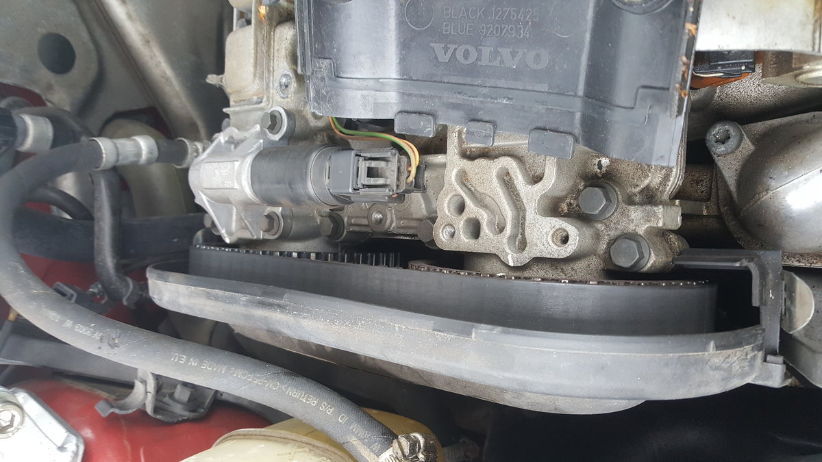

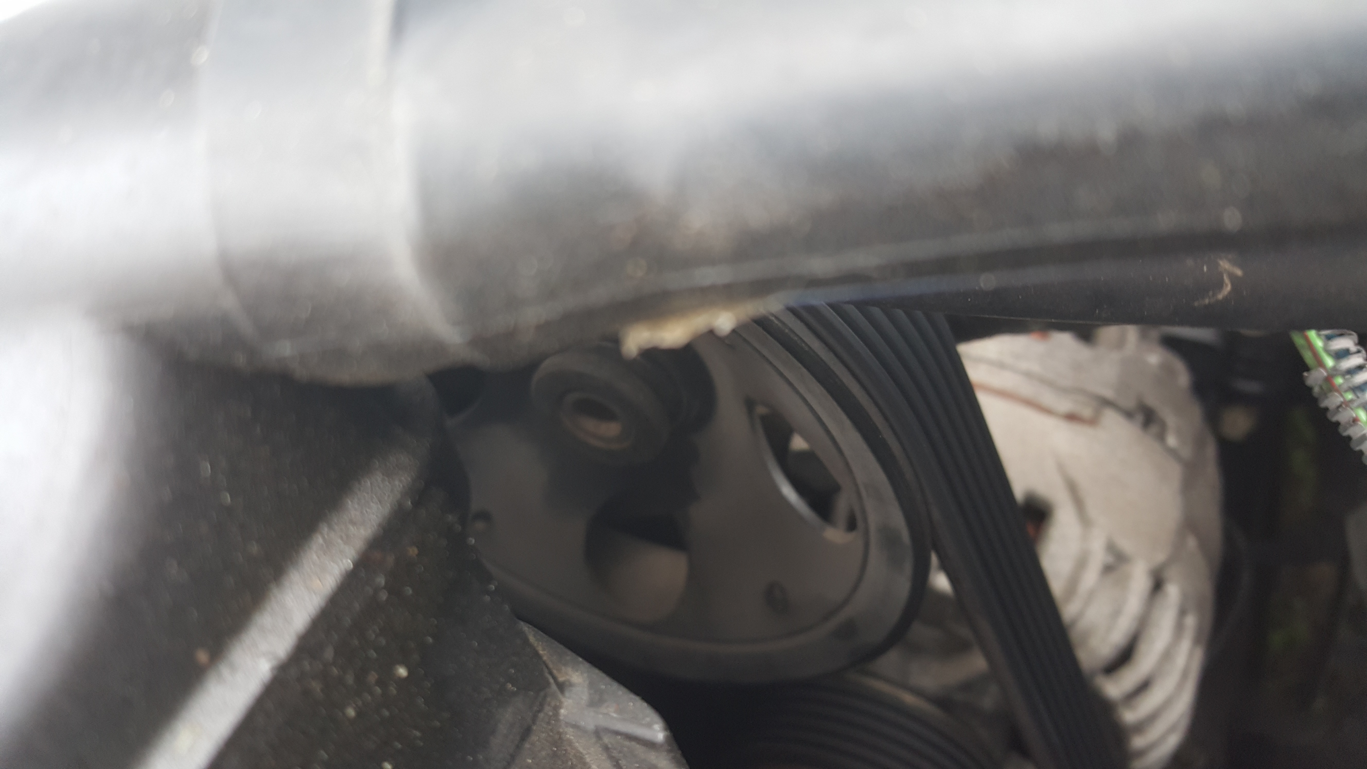

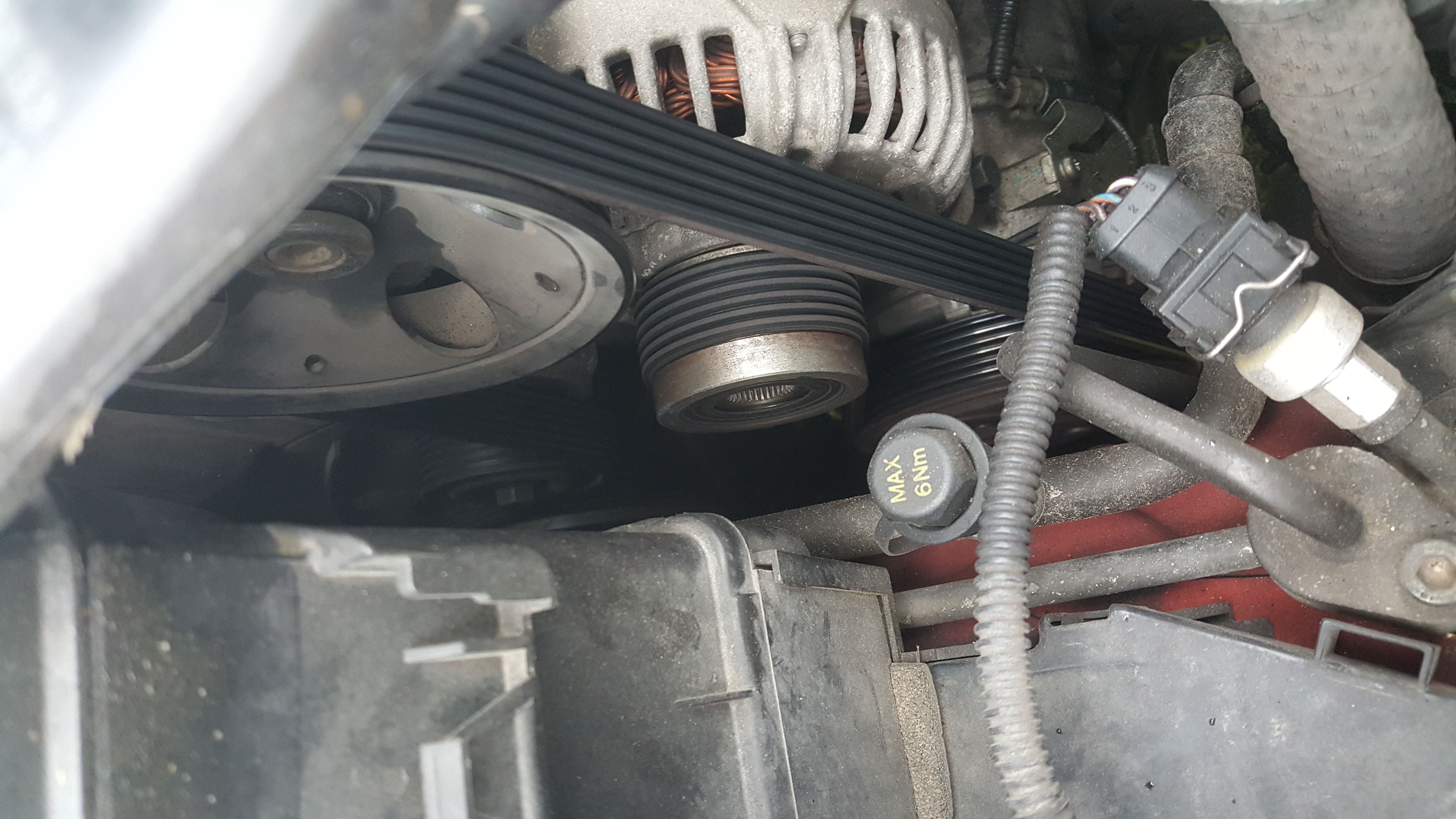

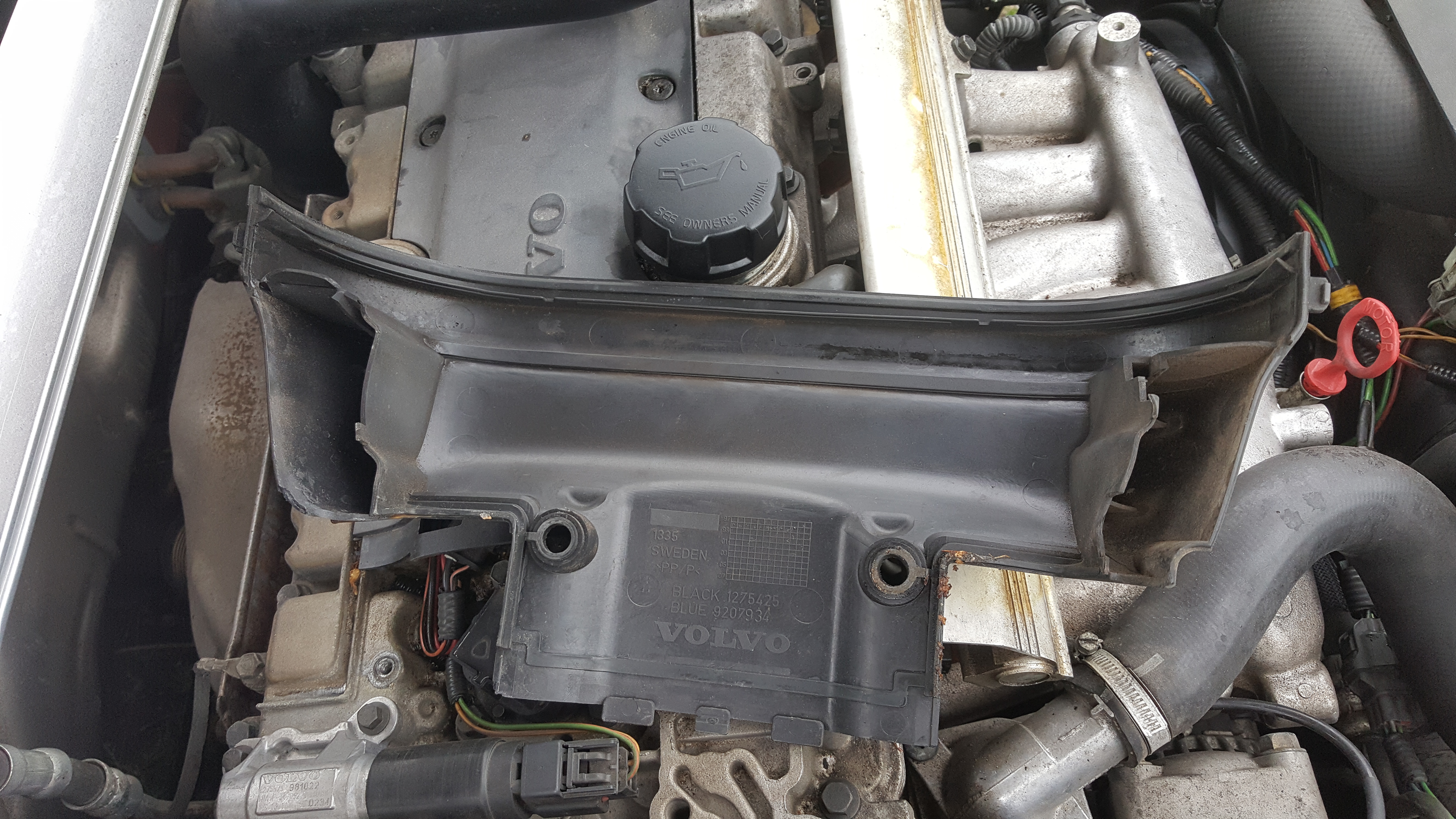

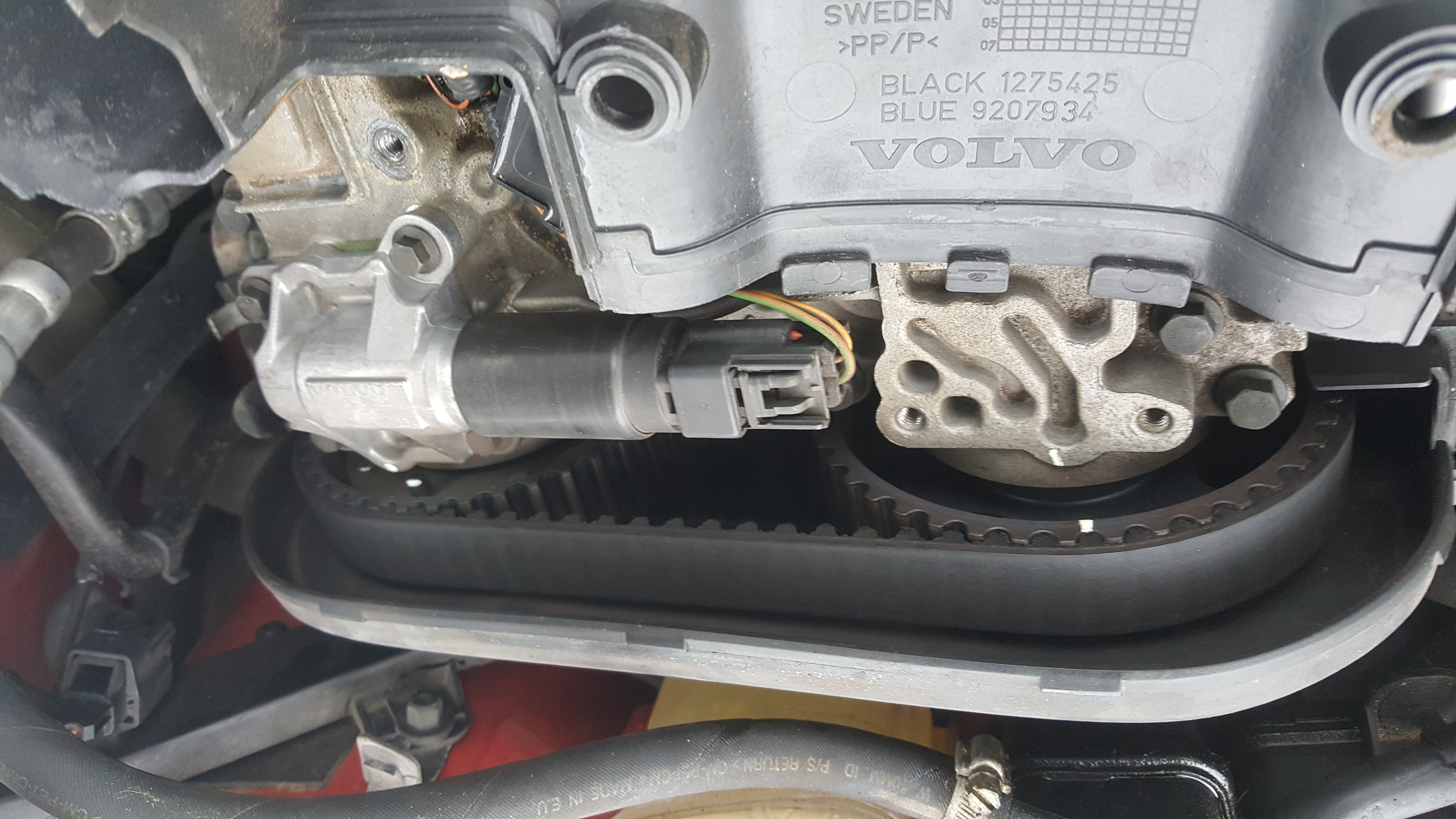

Here are some pics I took today. Sorry if they take up too much space. I don't see anything like oil leaking anywhere. As soon as I get more time, I will jack it up and have a good rummage 'round. I'll keep ya'll posted.

Power steering pump pulley looks like it has something on it. Also the power steering reservoir looks suspect. Check your power steering level to see if it is down. If it is low that could be the source of your leak. From there check your reservoir and check your power steering lines where they connect to the reservoir. Also check the front of the power steering pump where the shaft goes into the pump - maybe this seal is leaking.
Other than that - what I mentioned before check the front crank shaft seal and oil cooler. You need to take off the right front wheel and pull the plastic access fold back - it will give you a nice look.
Look at the oil drippings and take a good sniff and examine the color - try to figure out which oil is leaking (engine, power steering and/or transmission are the flavors).

Also, avoid chasing your tail here - the only description of the oil leak comes from post 1 where the shop "said the front of the engine was covered in oil and that my cam seals were to blame." That statement has been thoroughly debunked so step 1 is something like "where is the leak accumulating?" followed by "where might it be coming from?" and (as SuperHerman describes) "do you know which fluid it is?"
I agree the stain on power steering pump is worth paying attention to but I can't see much of a leak at all in those pics.
My reading is the next step is to clean everything up and start from square one. Is there a leak? Where is it? Etc.

Thats nice and dry. That PS 'leak' is probably seep from the shaft bearing but I would call that acceptable - its not even wet, just the slightest seep which has picked up dust. If you cleaned that off with a towel and water I bet you wouldn't see any seep coming out.
One last defense for your shop.
Check the left side of your engine - the one towards the FRONT of the car. If you PCV has blown or is clogged/leaking, that could be where the oil is.
