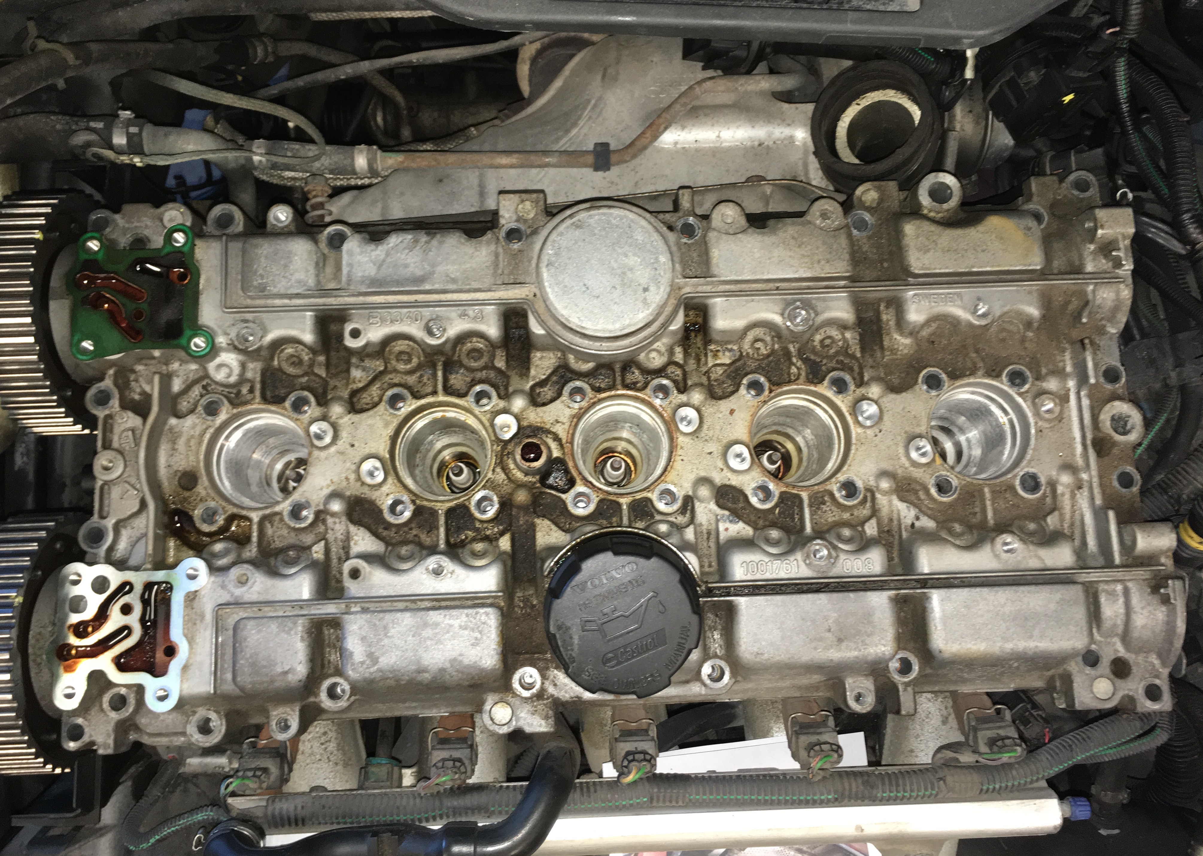

^^Yes. I removed just the lower cam wheel bolt on each, did a lot of careful jiggling around, and it came straight up. Also, your front cam seal lip can get caught on an edge under there and won't let it lift up.prwood wrote: 09 Jul 2018, 16:14 If you don't remove the timing gears before removing the cam cover, some of the screws holding the timing gears on to the cams can get caught up on the cam cover or the cylinder head prevent them from fully lifting away. I took a careful look at them and loosened up just the ones that were preventing full movement.

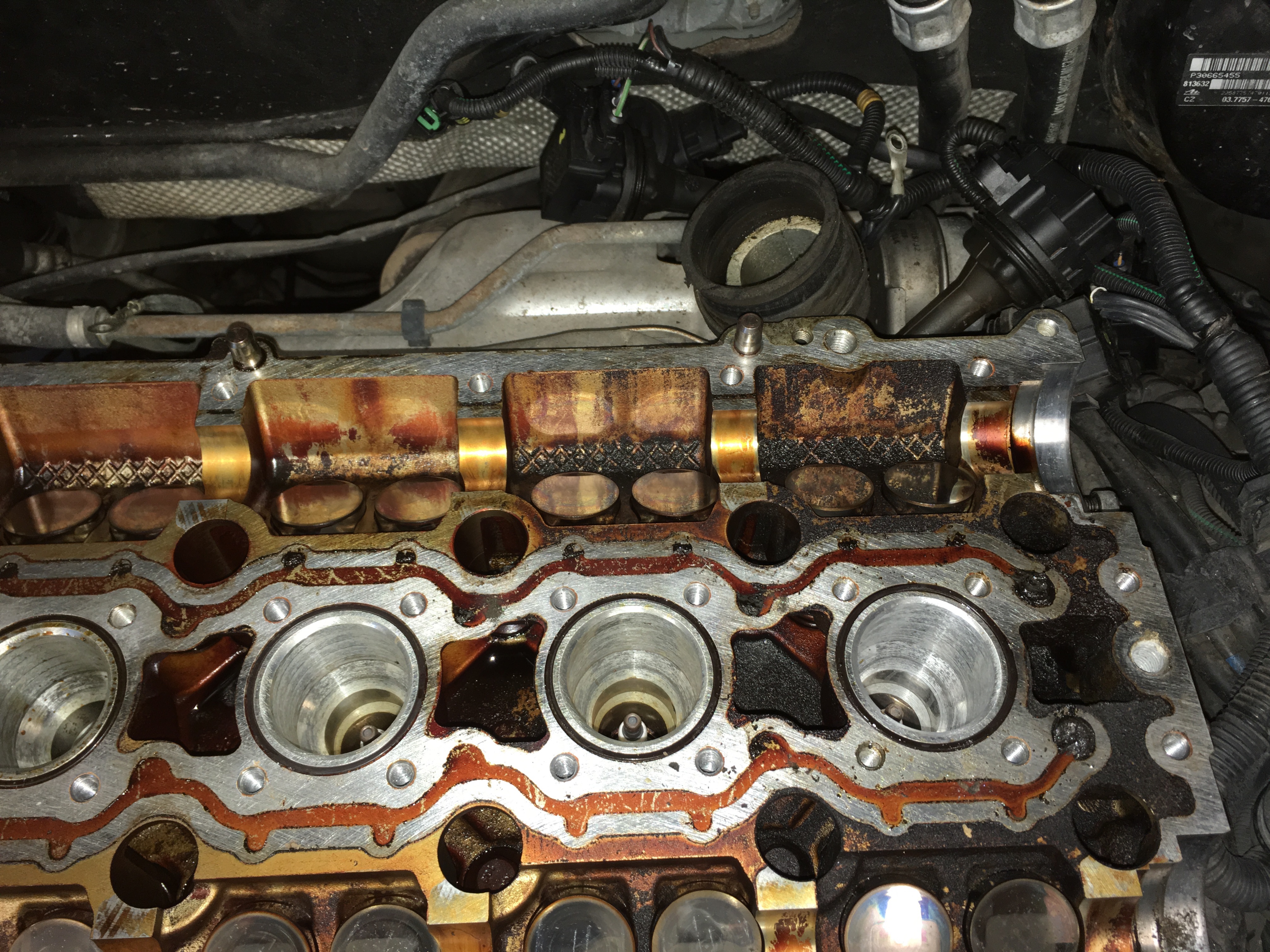

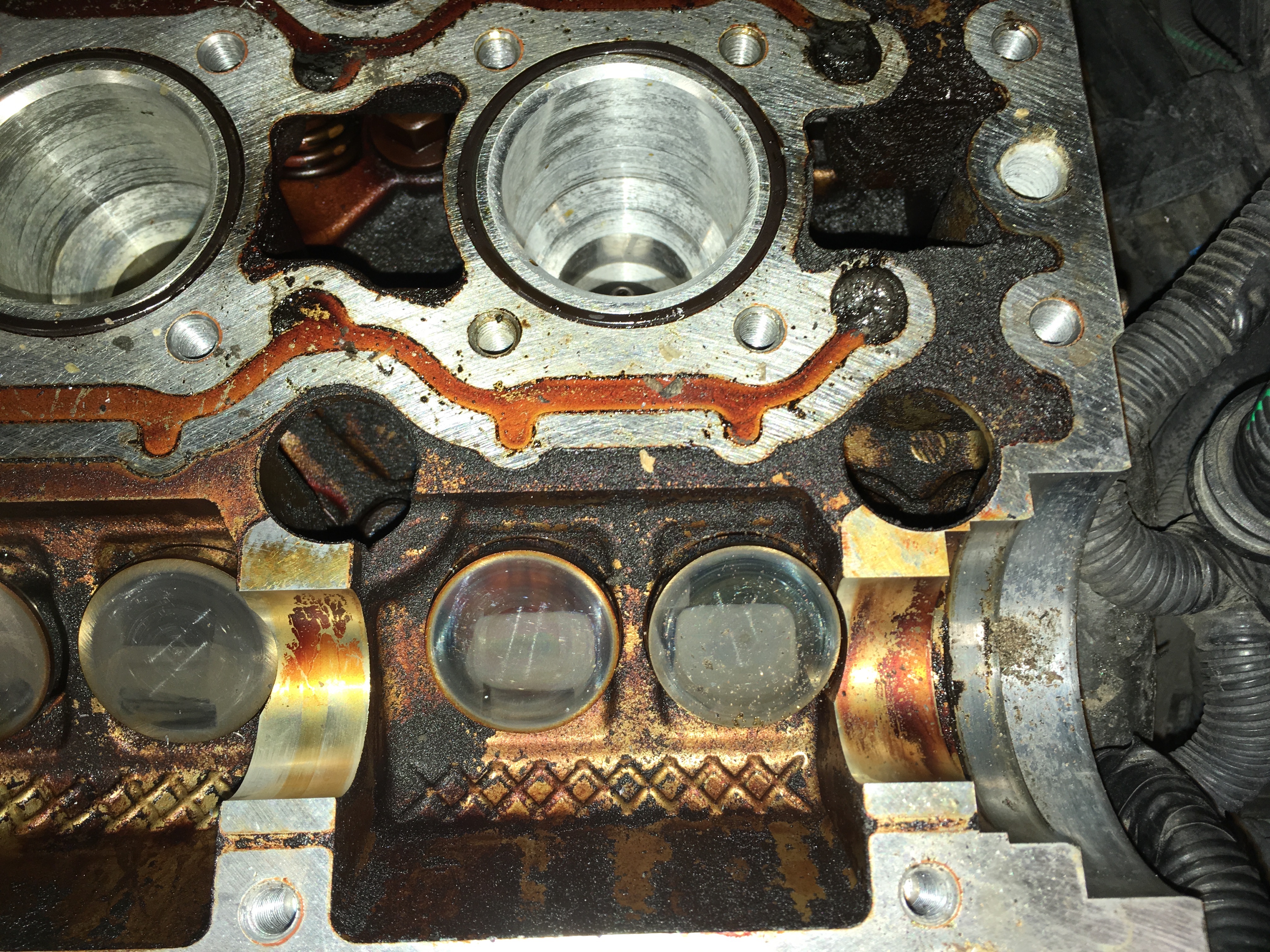

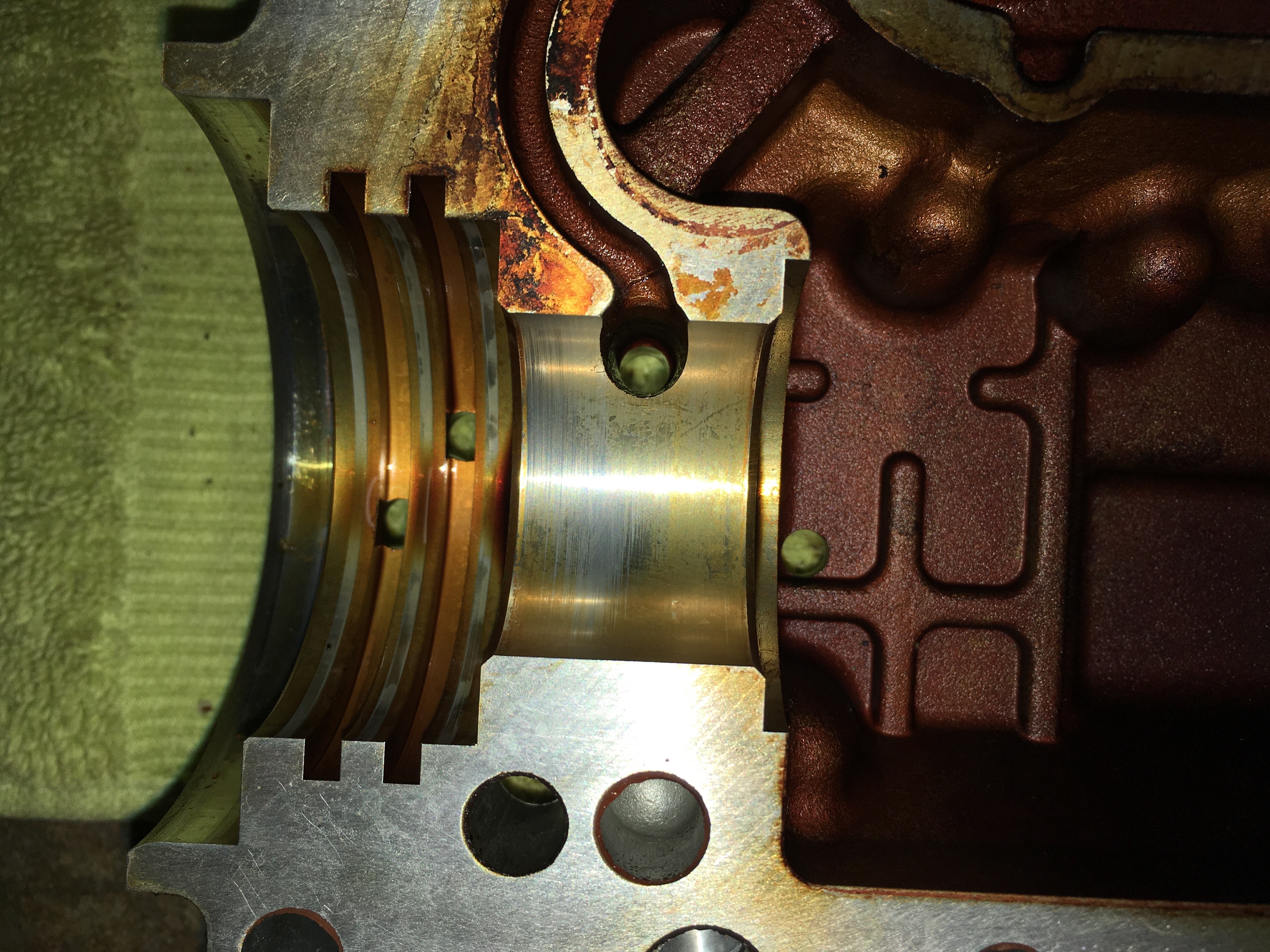

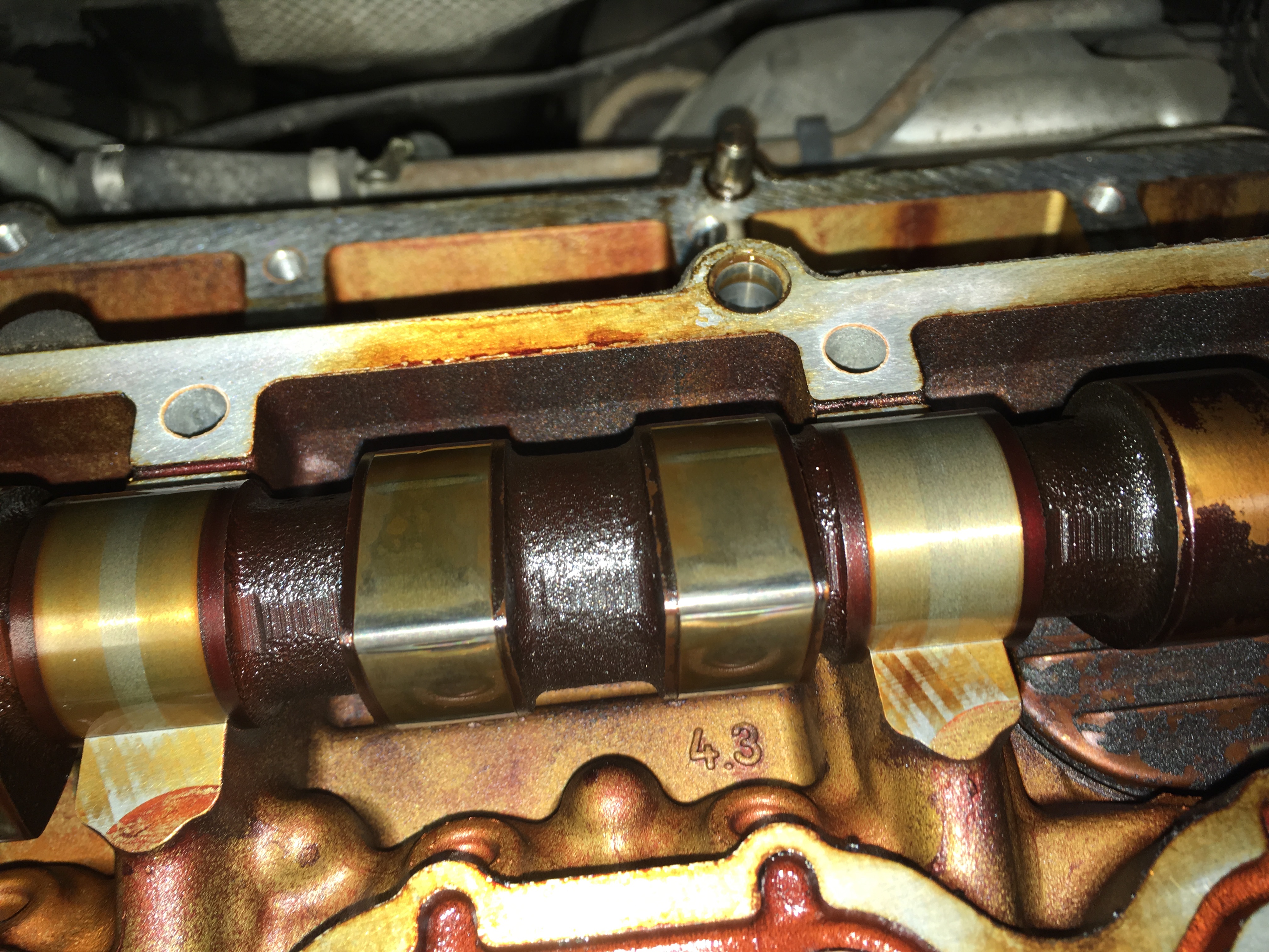

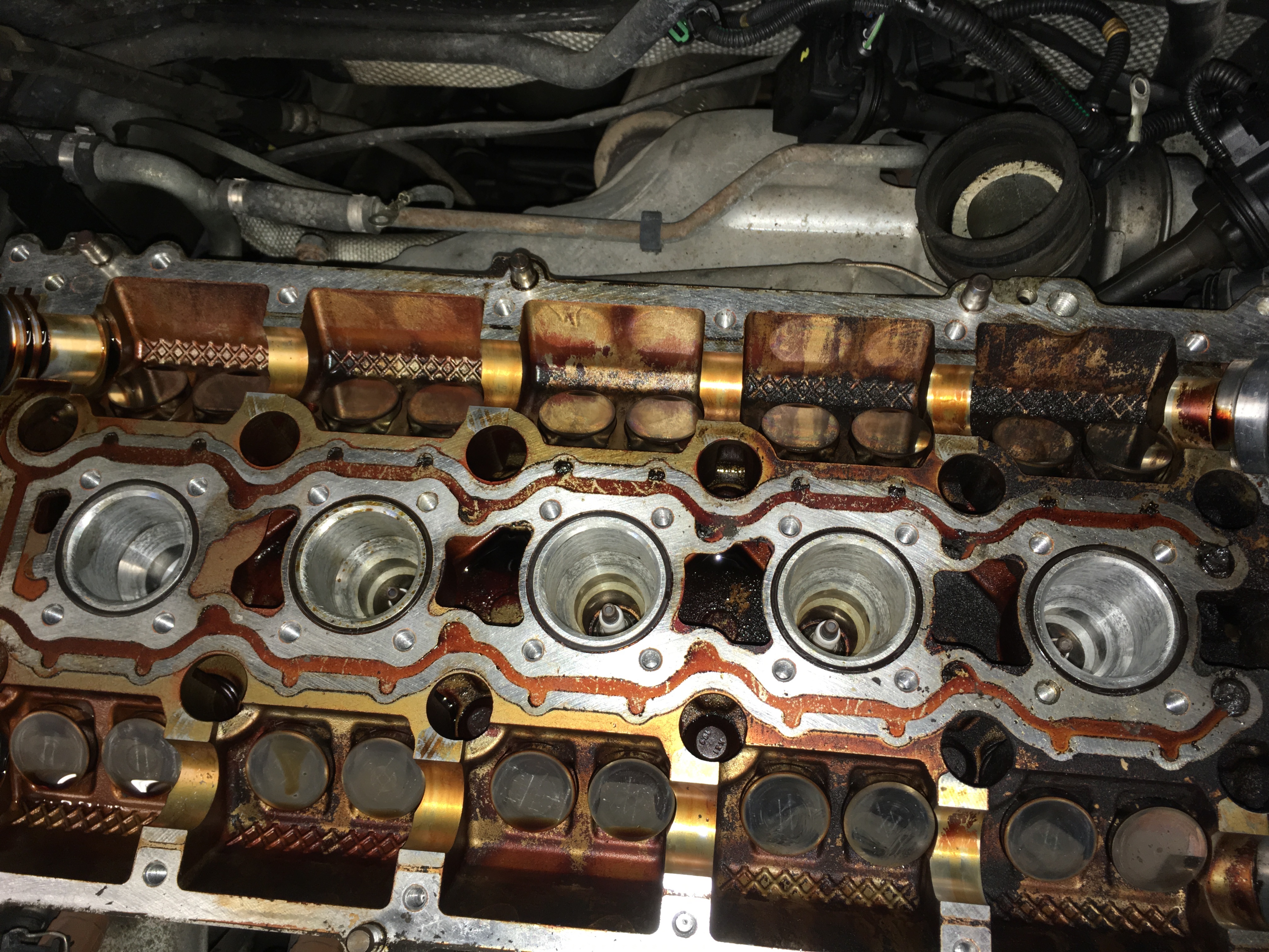

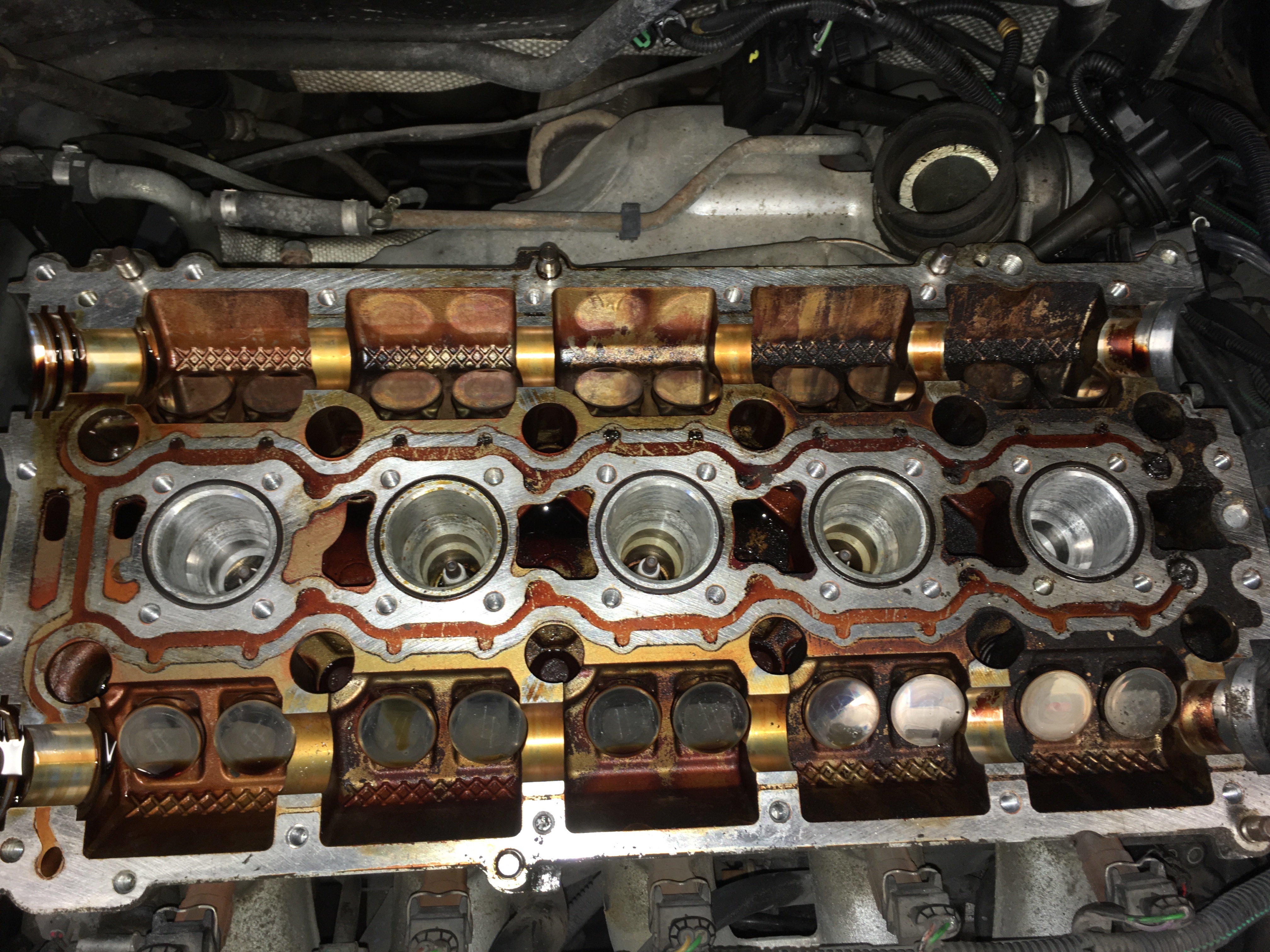

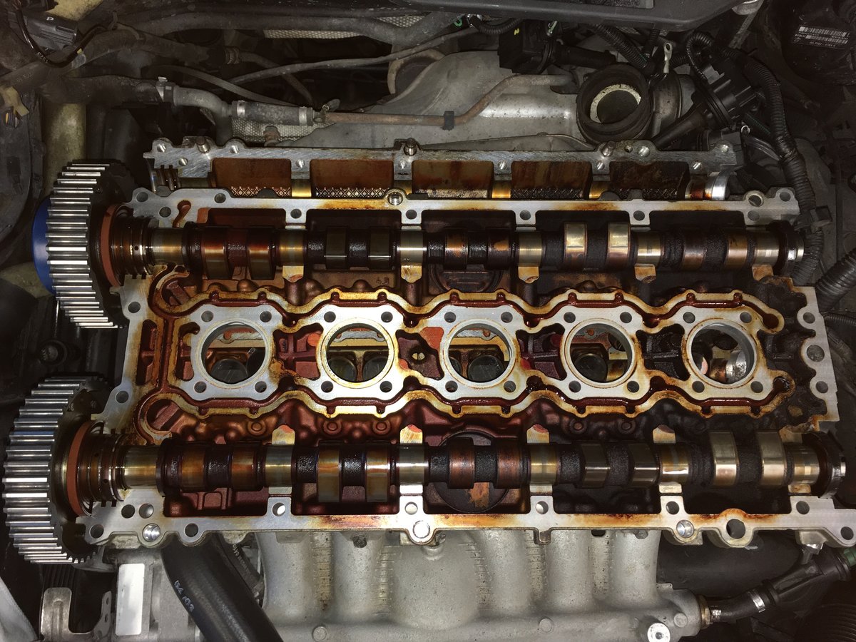

So it's off. Took some photos of what I found. Interesting that there is increasing varnish / sludge(?) as you head away from the front of the engine and the oil source. I've read accounts of this on engines - the farther from the fresh oil and higher pressure, the more the build up. I think, based on the sludge issues thread, this engine is due for some detergent oils and frequent changes. Previous owner did mostly good maintenance, but maybe extended their oil change intervals or missed a couple??
I assume this is factory? They obviously used a continuous bead of sealant rather than the roll-on anaerobic goop we're using now.
Most cam lobes are clean

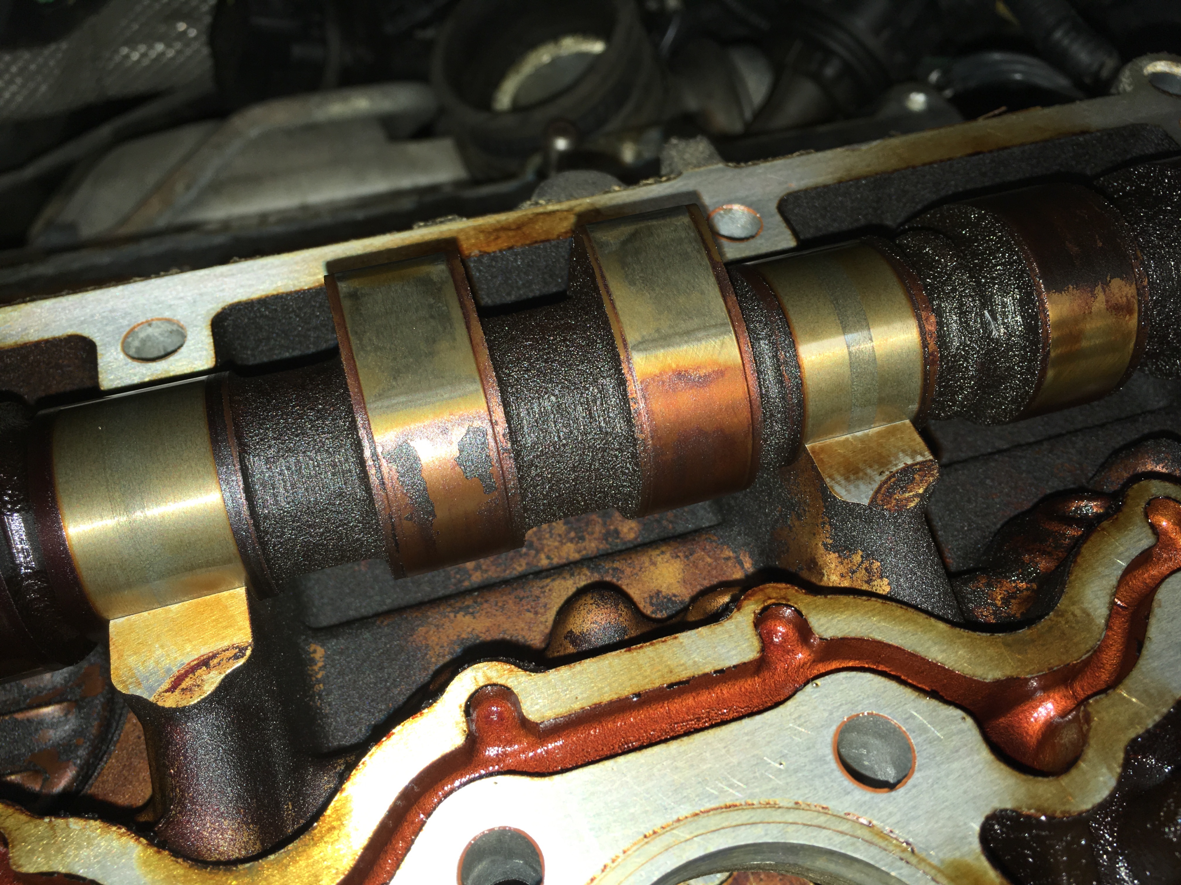

The non-contact side of some towards the back are varnished
Progressively darker buildup as you head south down the engine
Pretty gunky down here, but I don't see clogged oil ways

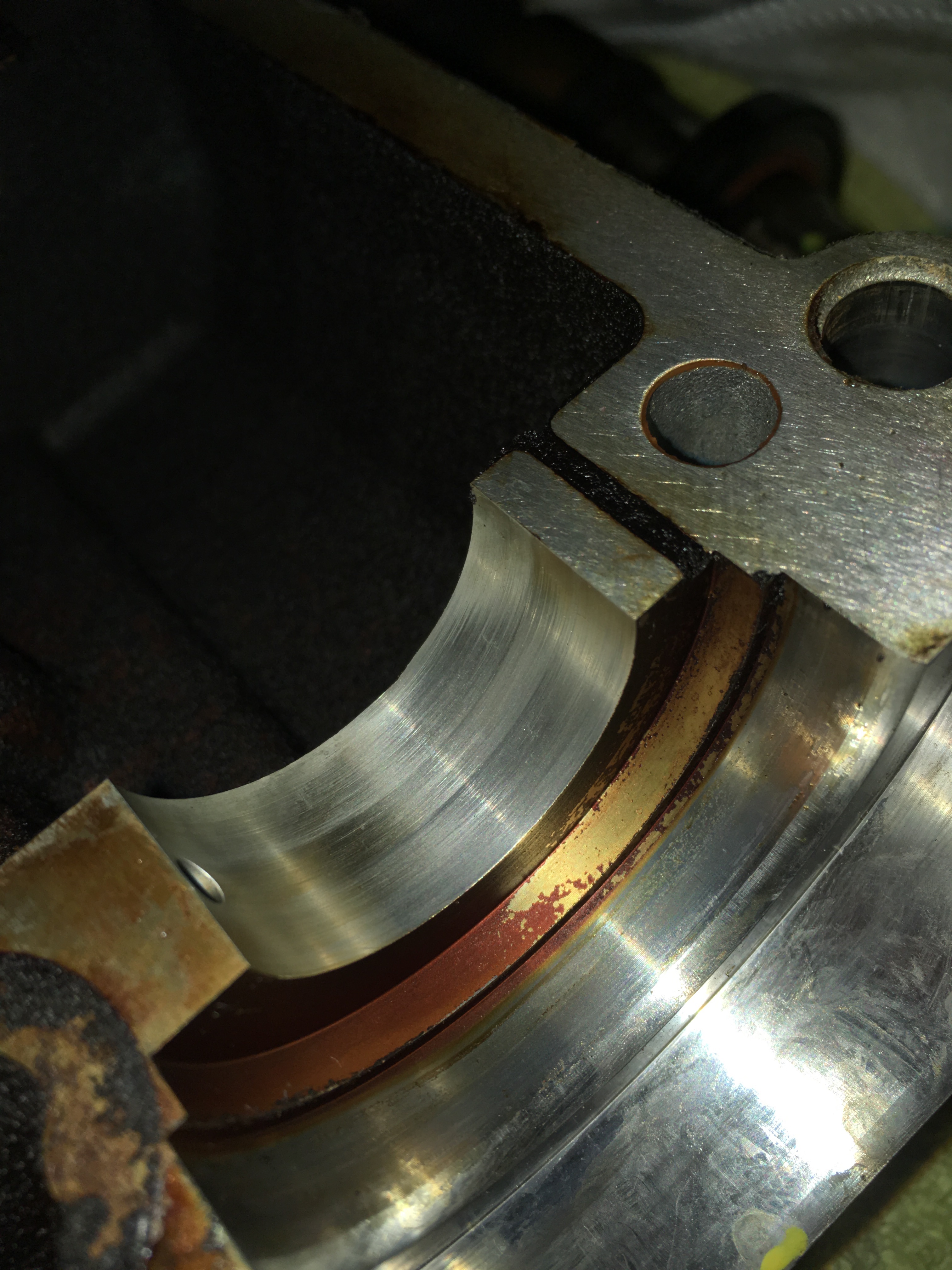

Varnish at bearing journals??
Front to back, more buildup at bearing journals
Normal wear or lack of oil?

I see the use of anaerobic sealant. When you scrape it off it will come off in flakes. This is what the red stuff being recommended is. Once it is sandwiched to the top and cured, other than the color, it will look the same upon removal.
The sludge build up is consistent with what I saw on my 2001 XC70 when I pulled the head. It may be the turbo heat causing the extra baking.
Are you planning on dropping the oil pan? When I did mine that is what I did. You will find a similar build up below. I cleaned the passages as well as I could and flushed out any junk with gas and brought the stew to recycling.
If you are doing all the clean up yourself, make sure you oil your cams after you wash them or they will rust.
I assume you are going to at least lap the valves, replace the valve stem seals and install new rubber o rings. Now is the time and it is not that bad a job, especially if you can work the head inside with talk radio or a ball game on in the back ground. I took my head and upper cam cover to a shop that did ultrasonic cleaning and had them cleaned and the head trued up before doing the lapping and seals.
The head is aluminum and the cams are iron - so the head journals will show more wear. I wouldn't be worried, plus there is really nothing you can do.

Some varnish is normal, doesn't look that bad to me.. I'd make sure the small oil passages in the cam hubs are clear as well.

Mild varnish and buildup, nothing to worry about.It is an engine, not a neuron.
Your cam bearings are fine - these are lightly loaded, unlike crank and rod.

Clean it up as best you can. Mine was slightly worse than yours - in your third picture you can see sludge starting to build up on the cam lobes. If not cleaned it will grow and ultimately could cause misfire issues as it could affect the tappets. Sludge attracts sludge and that is why you have build up areas. The few instances I have read about on the Volvo engines and valve issues is on #5 - which your pictures show why.
