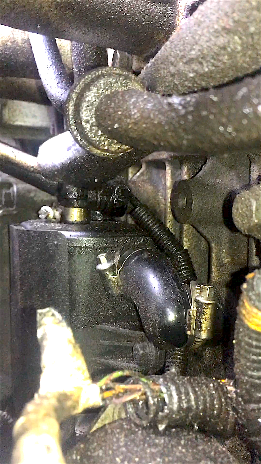

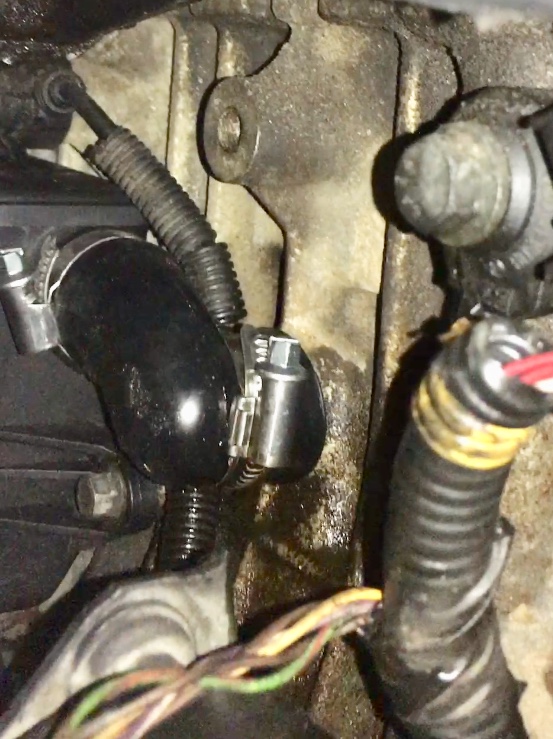

This is the best view I could get without taking anything apart. Using my iPhone in video mode with LED illumination, holding my hand in the vicinity of the intercooler-to-throttle tube and starter. You can sort of partially see the metallic sleeve around the lower hose from the breather box to the block, but the starter is blocking most of that view.
It seems like everything is oily, so I'm not sure if this is helpful in pinpointing anything.

Really oily up top but not enough for flow.
Crack in th ebottom of the box, maybe?

Inconclusive. Recommend using engine cleaner to clean and then try again. You can get a $20 usb borescope and get a better look at all angles.

Really wet on that knock sensor....

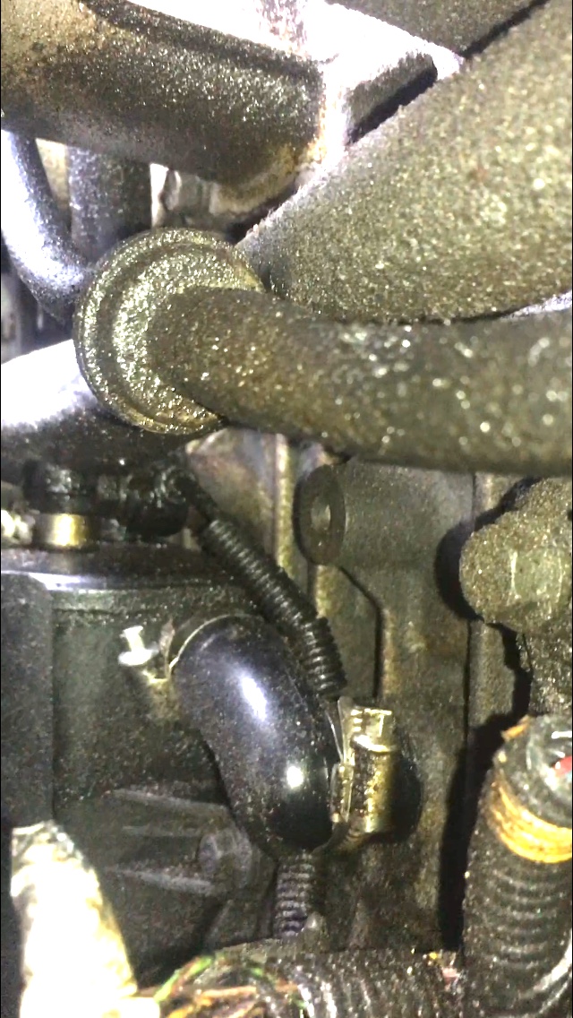

Okay. The endoscope wasn’t super helpful. I tried getting photos with both my phone and the endoscope after cleaning things up under the intake manifold. Frankly, the endoscope pictures aren’t worth posting. Anyway, here’s a phone photo from before the cleanup and then one from after cleanup and driving around for a while.
Before cleanup
Before cleanup
After cleanup and driving.
It looks to me like the leak is coming from the top connection between the engine block and the breather box. You can see what looks like fresh oil underneath the hose.

It looks to me like that hose clamp light be sitting too far out from the engine to seal the connection properly.

Definitely a leak there ( maybe clamp has cut hose?) but there is oilabove that too, maybe more than one leak?
