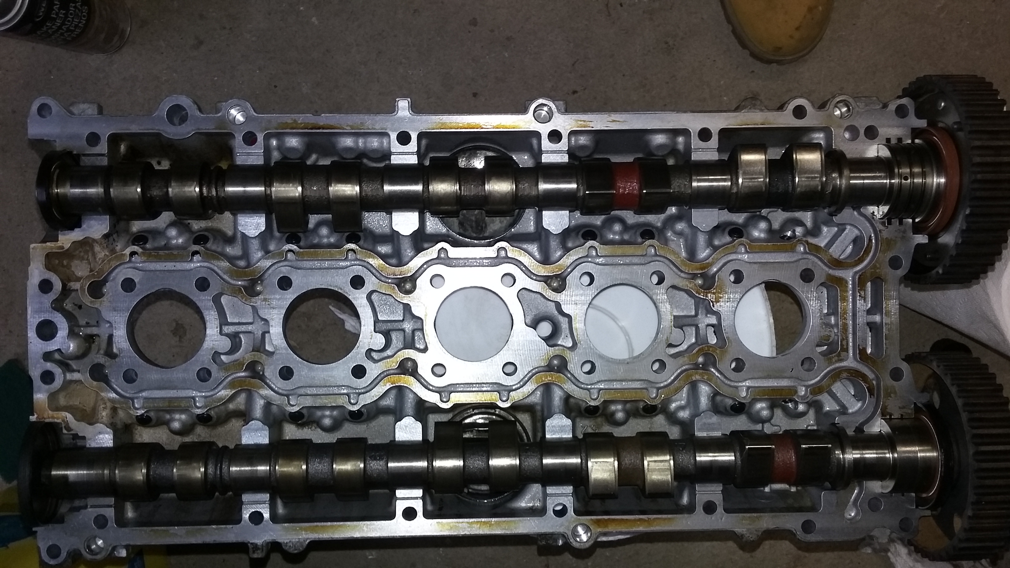

If you have a pressure washer give it a blasting. Any crud will act like a magnet for more crud. Apparently crud likes company.
Did you take out the lifters, springs and valves? Some of those parts could rust - I know the cam should be cleaned and then oiled to prevent flash rust. If you have the valve stem seals in there - not sure how they like the oven cleaner.
Taking the valve keeper out and replacing them is the hardest part of valve lapping. Otherwise it is mindless work - best with a game on (baseball works best on the radio, but college football on the radio is also very good) to pass the time.
Costs for lapping equipment is under $20 for tool and paste. Valve spring compressor another issue, but there are clever work arounds. If you have the valve stem seals, do the total top end refresh. The bottom end is very robust. Good for another 100k plus when the TB comes up again.
Are you going to sand the bottom of the head or have it milled?

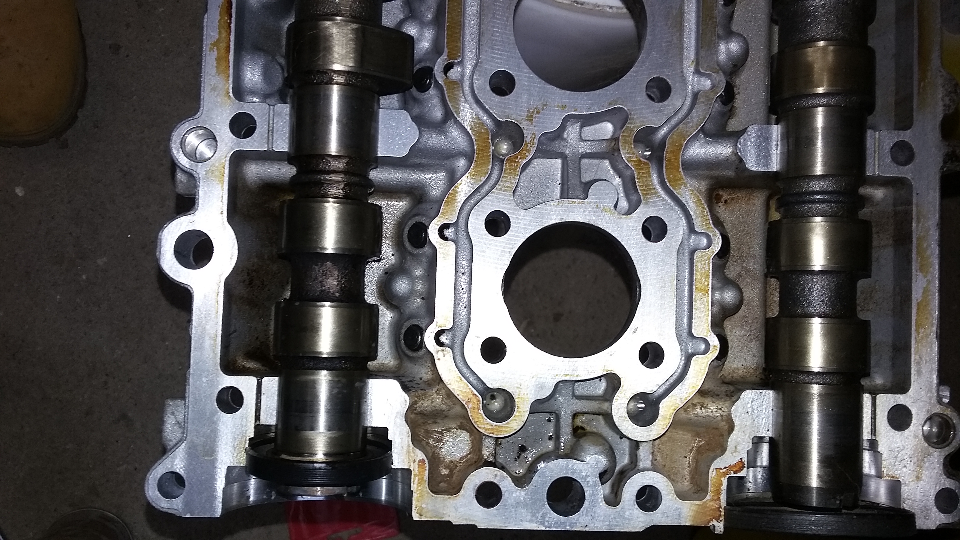

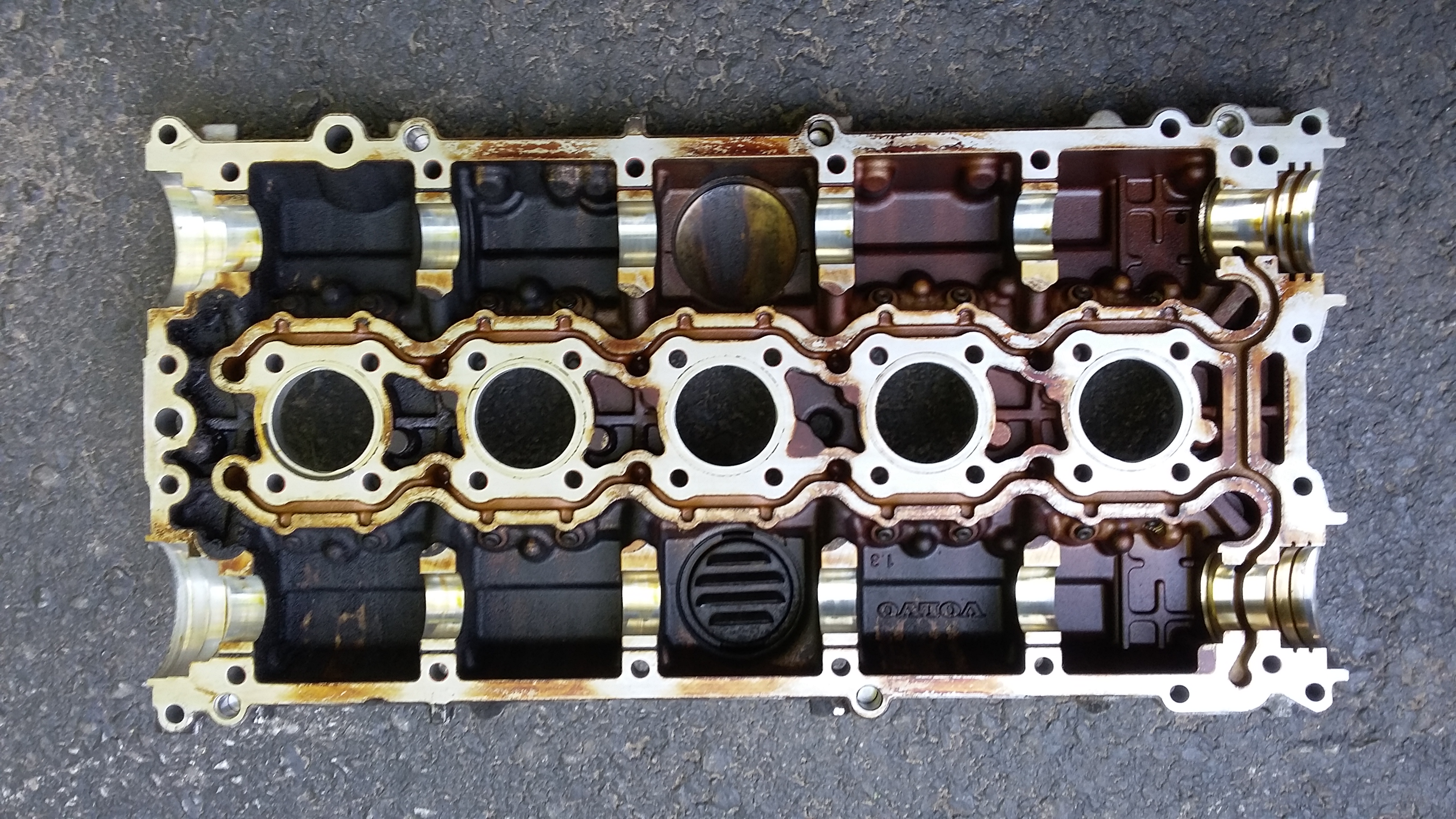

Only done the valve cover and cams.... Dont see to many places for crud to hide...I dried everything with compressed air and sprayed it all down with WD-40 and wrapped it in plastic.
This Budget repair If can get away without any shop work thats the route I want to go....
Ill look into the valve stem seal replacement, they come with the head gasket kit....
