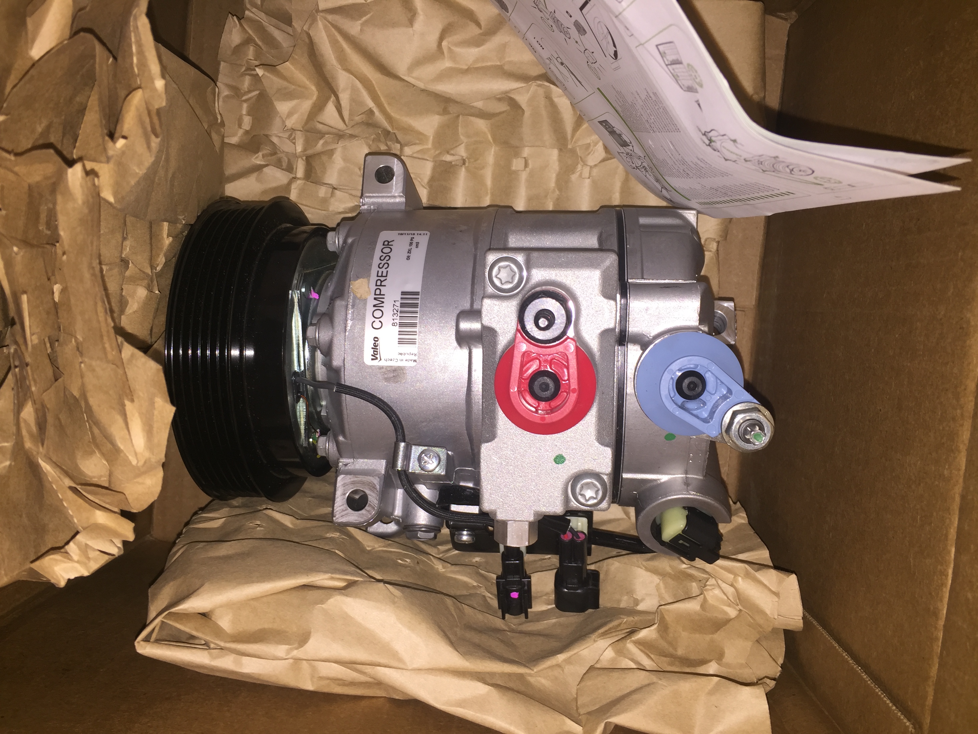

I decided to go aftermarket and buy a Valeo unit
I did this because the A/C in my LR2 is still blowing cold and its two years older than the S80 and has similar mileage and it came new with a Valeo unit (Volvo specified a Sanden unit)

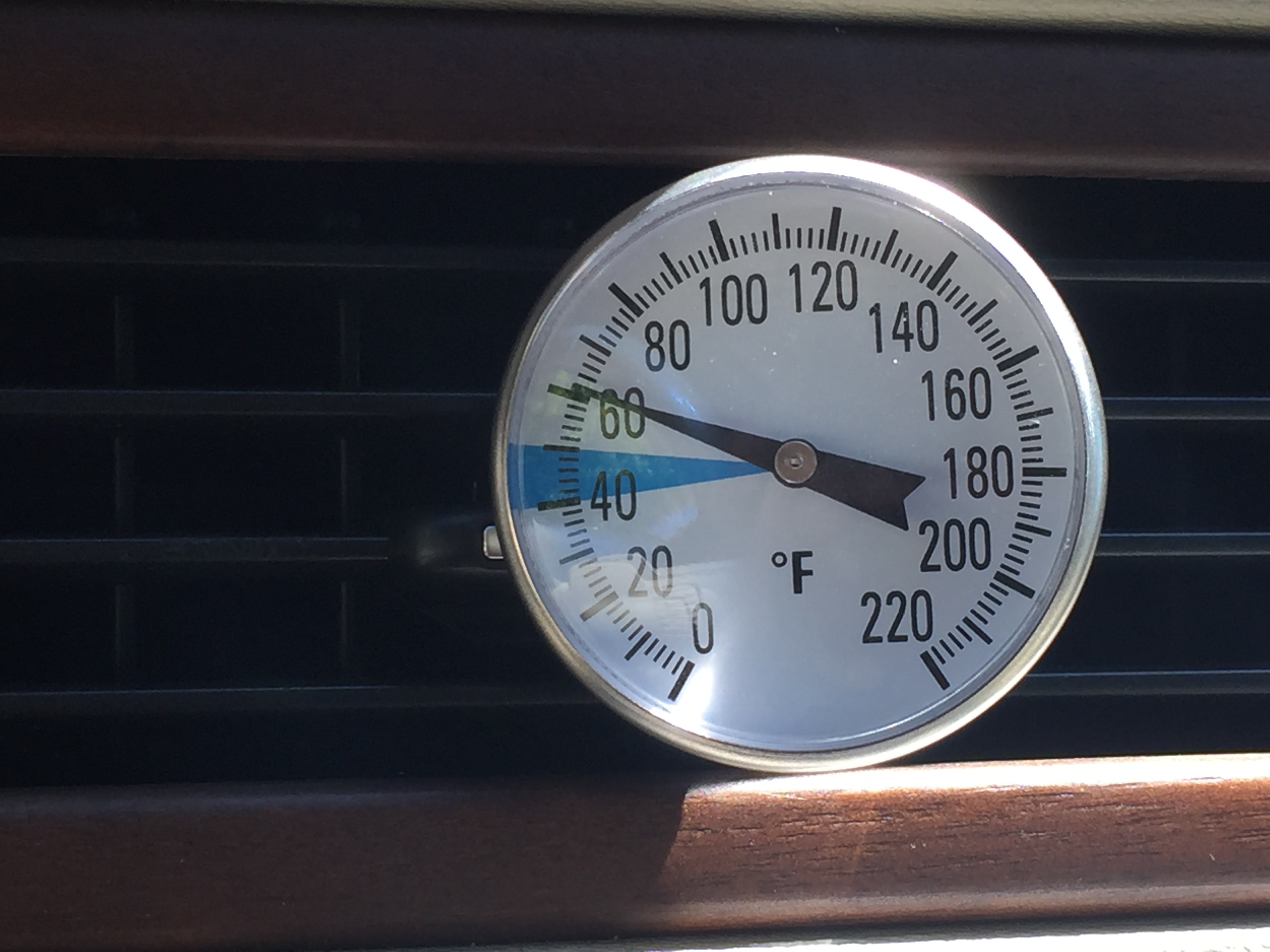

Vent gauge showing cooling but not enough (outside temperature was about 75)
The new compressor

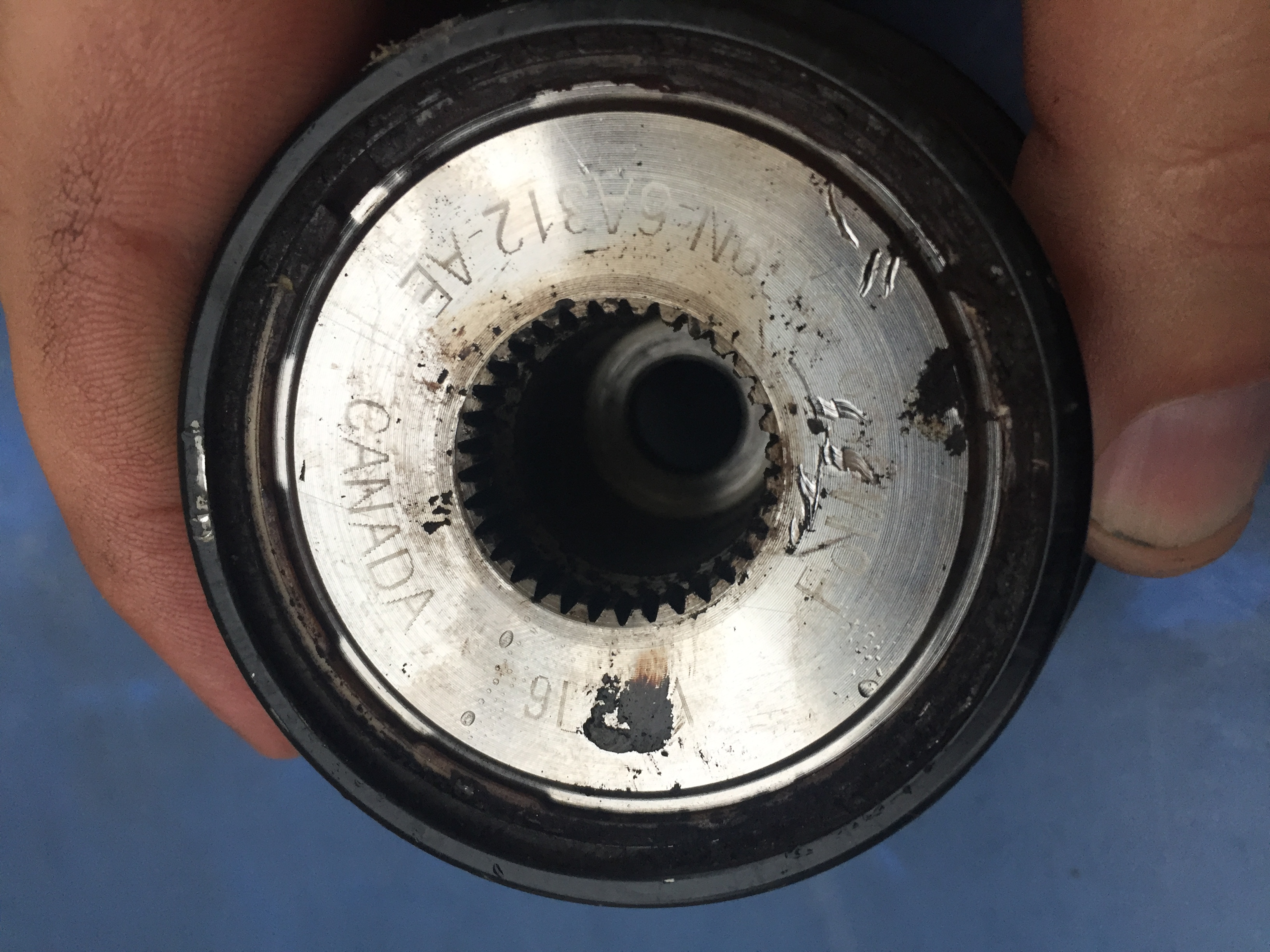

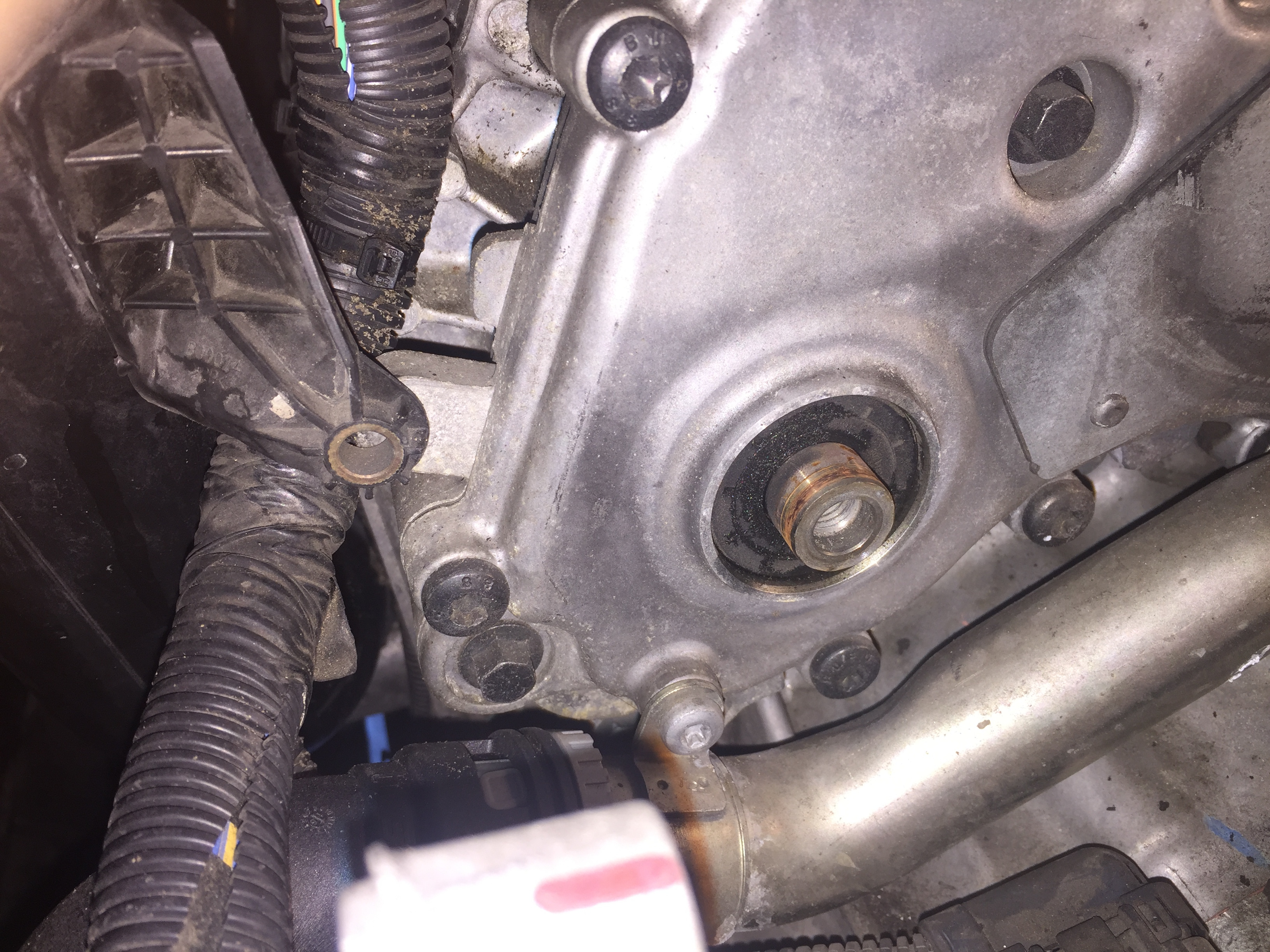

At the same time that I replaced the compressor I also replaced the overdrive pulley.
I did this because the old overdrive pulley wasn't allowing the one way clutch action.
It was frozen in both directions.
After putting everything back together I did notice that the belt now moves easily in one direction (engine off) and it doesn't move in the other direction.
For the Overdrive pulley I decided to try Professional Parts Sweden (I will post here if it fails)
The old Pulley

With everything installed the AC is now very cold.
The Vent temperature gauge is in the shaded region.
And the low side pressure is about 35 PSI and the high side is about 150 PSI

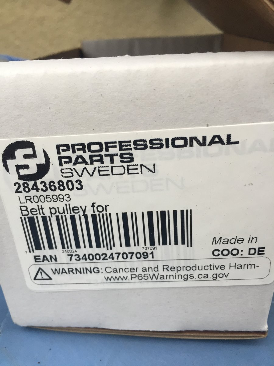

I forgot to include the cost of the overdrive pulley in my last price update so I am adding it in the update below.

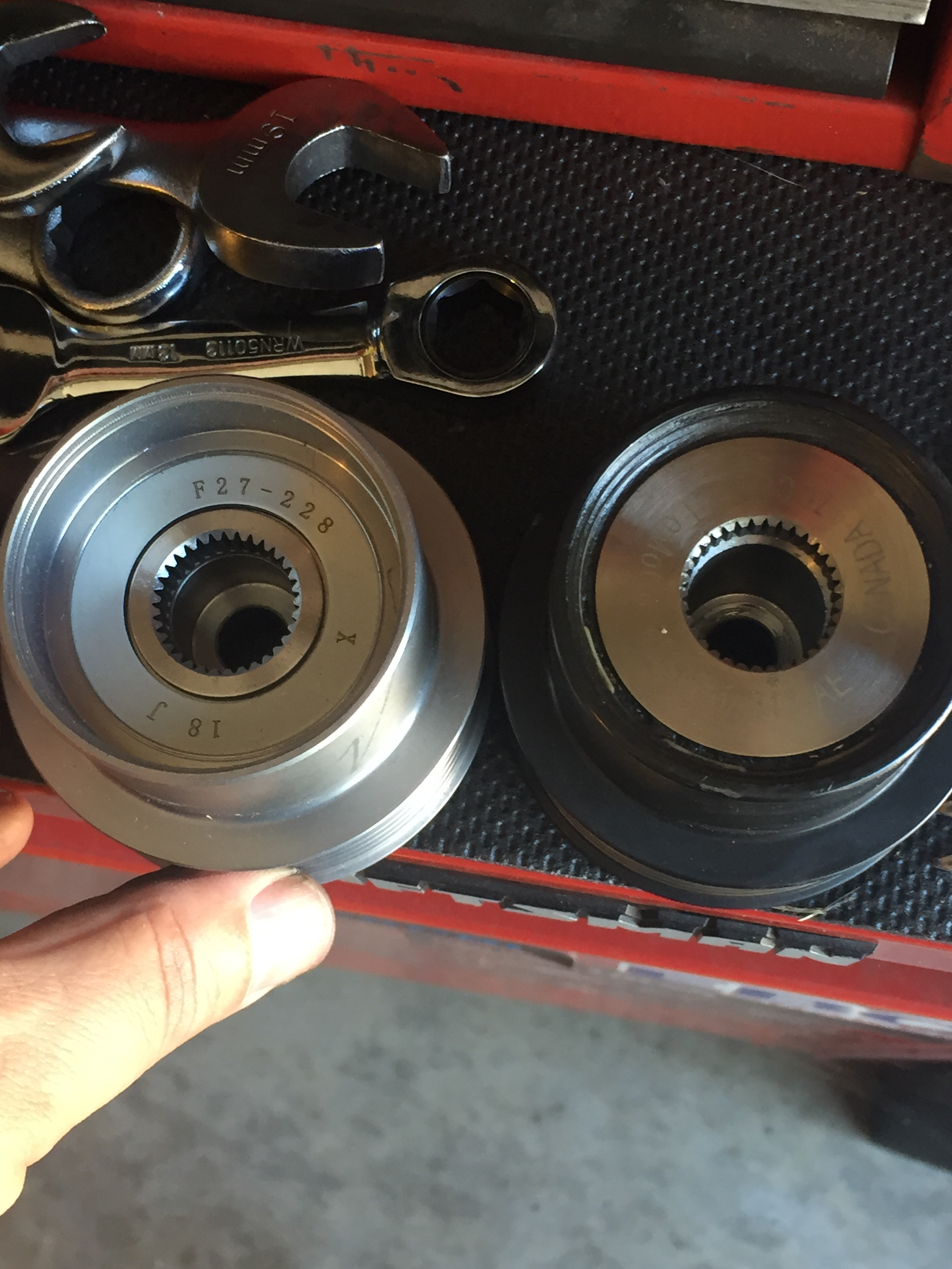

I wanted to share what I found when I replaced the overdrive pulley on my LR2.
Comparing the picture for the S80 (Post Above) to the LR2 shows how clean the LR2 is in this area
This is likely due to the use of synthetic oil since new (Mostly Mobil 1 0W-40)
Also because I didn't take a side by side picture of the old part and new part, I am including one here.
One last disclosure, the part that I bought is an Overdrive Pulley not a Overdrive Decoupler Pulley.
The difference is that the Decoupler has a spring to dampen the belt movement.
Because the belt tensioner also has a a damper I decide to get the simpler part and see if it lasts longer than the original part.
Note: the part that I bought is also significantly cheaper.

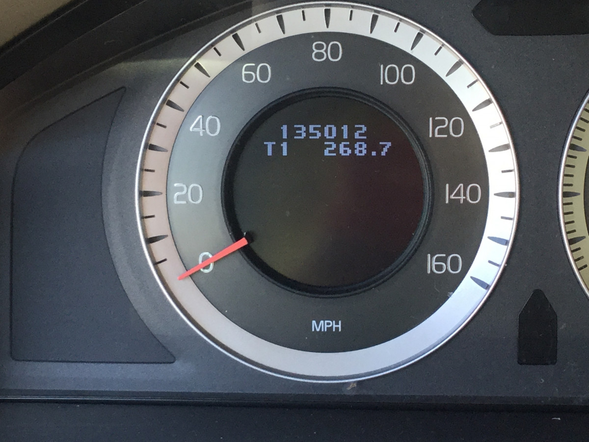

One more update, I don't get to drive the S80 very often but I did drive it once last week and it is running extremely well. The shifting is smooth and the engine is strong. I like driving it even more now as compared to when I purchased it.

2010 S80 purchased on 11/5/2018 with 123,636 miles
As the picture shows I am at 135,012
And I haven’t done anything for months (ok maybe lexol on the leather)
Volvo did an amazing job with the P3 and the 3.2
And MVS is such an amazing site with so much great information that my S80 drives like a new car.
I remember reading a post from Matthew1 (the M in MVS) about the cost of used cars and the impact on hard working people. Hopefully this thread inspired someone to buy a P3. Because as I’ve shown the P3 isn’t that expensive if you can do some repairs yourself. And the P3 Volvo is a very safe car.
Take care
Paul

All,
It's been 6 months since my last oil change.
I decided to use a different oil, I was using Mobil 1 0W40 and I did have to add a quart during the 6 months of usage.
I decided to try Motul X-clean 5W40 (and a new filter)
And because I was going to be under the car I decided to replace 4 quarts of ATF fluid as well.
Here is the oil
And here is the transmission fluid
I prefer to use the AISIN fluid because AISIN is the manufacturer of the transmission
Cost update
$7400 --- Purchase price
$62.53 --- (31401556) --- Booster O-rings
$16.36 --- (AISIN T-IV) --- ATF
$40.35 --- (DENSO 5344) --- Sparkplugs
$00.00 --- Filter housing
$51.47 --- (Mobil 1 0W-40, Oil and Filter)
$58.28 --- (LR006071) --- Thermostat
$00.66 --- (LR001505) O-ring for 30713530
$24.29 --- (30713530) --- Coolant hose
$23.99 --- (31439821) --- Coolant
$22.71 --- (14520, 14526) --- Michelin wipers
$68.85 --- (31272677) --- Oil Filter housing
$18.92 --- (LR006076) --- Idler pulley
$18.92 --- (LR006076) --- Tensioner Pulley
$08.97 --- (PK060473 CONTITECH) --- Aux Belt
$112.70 --- (LR021634) --- Motor Mount
$23.24 --- (30680474) --- Torq Mount
$20.95 --- (31390880) --- Cabin Air Filter
$15.76 --- (UD1306) --- Front Brake Pads (Amazon close out price, typical price is ~$75)
$523.23 --- AC repair
$43.37 --- Overdrive pulley ProParts Sweden 28436803
$52.39 --- (Motul x-clean 5W-40, Oil and Filter)
Total $8717.35
