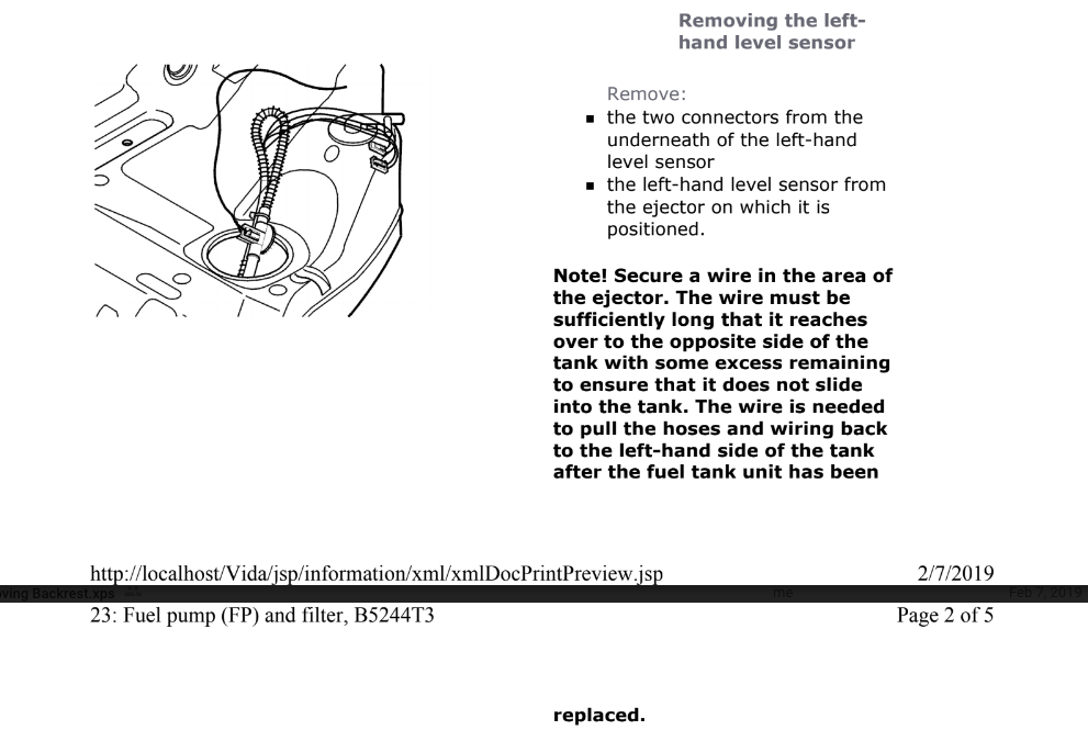

VIDA is saying that if I'm not replacing the fuel tank, I can use a wire to fish the cable back and forth, so hopefully that will make things easier:abscate wrote: 17 Feb 2019, 15:18 Peter
Watch out for the routing of the pipes it he tank. It is easy to kink something and then you get a horrible intermittent fuel delivery problem like shockwave did on th e XC90 forum
Removing the left hand level sensor, with note about using wire:

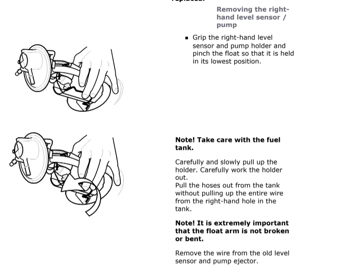

Removing right hand pump/level sensor:

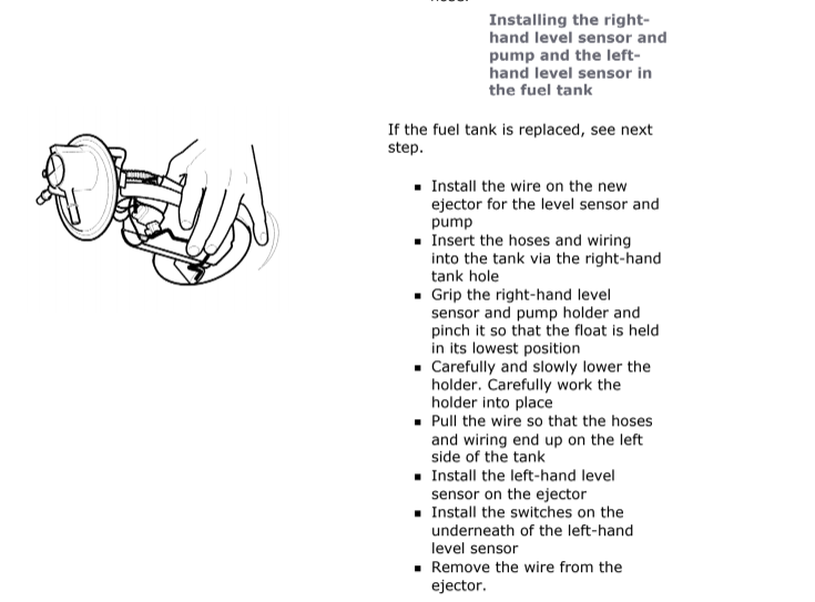

Installing right hand pump and level sensor:

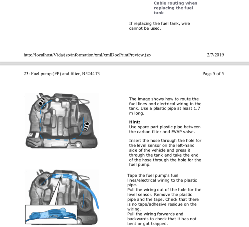

How to route the cable IF you are also replacing the fuel tank at the same time:

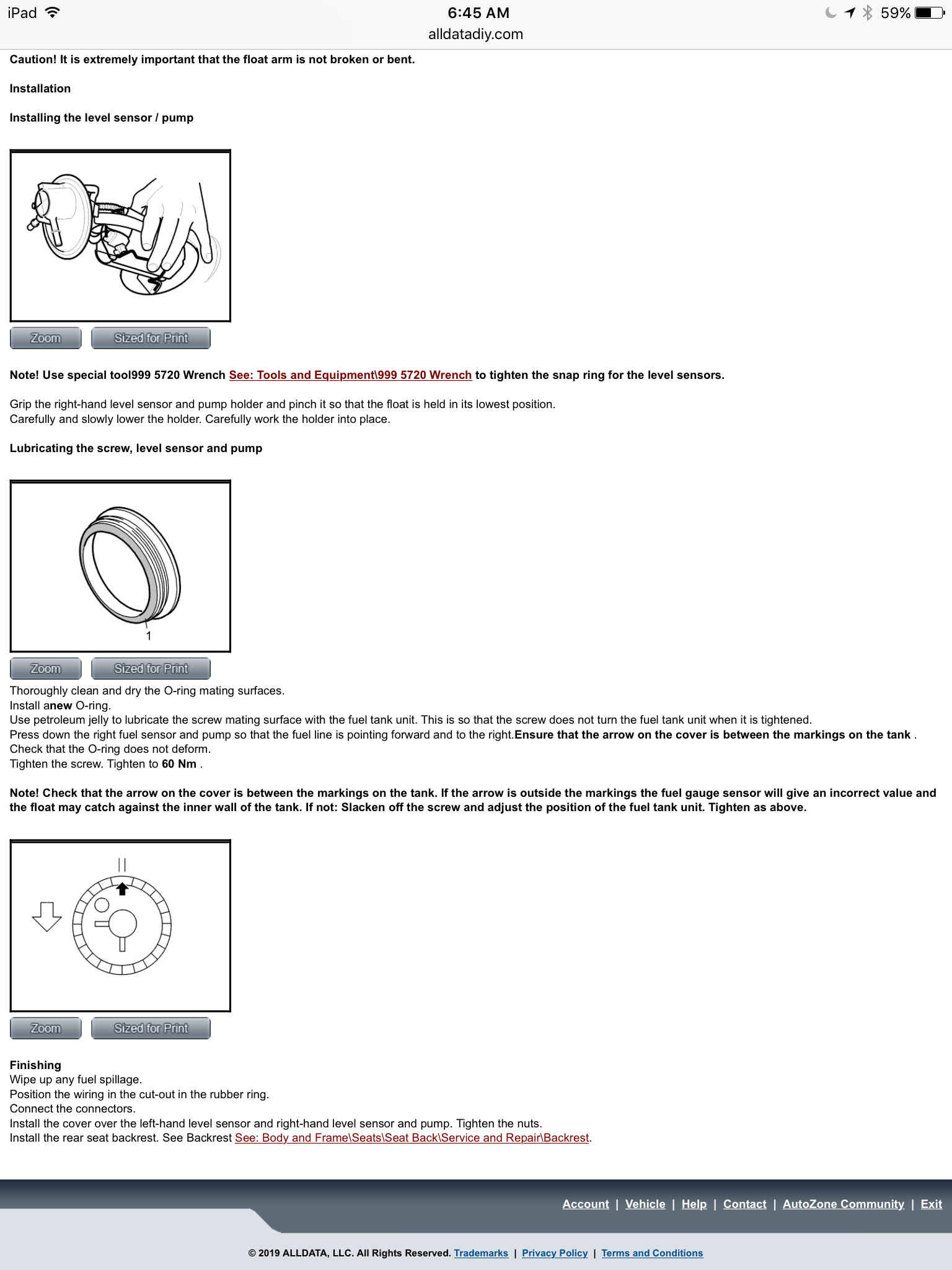

I installed the new pump on 2/23. Things seem good so far. Here are my detailed notes:
Parts and tools used:
* Bosch Fuel Pump: https://www.fcpeuro.com/products/volvo- ... 0-30761743
* 2 x Genuine Volvo O-Rings: https://www.fcpeuro.com/products/volvo- ... nk-9183708
* CTA Fuel Tank lock ring wrench: https://www.fcpeuro.com/products/volvo- ... 0-cta-2493
* Nylon fish tape (used w/zip ties to fish fuel pump umbilical from side to side): https://www.harborfreight.com/50-ft-nyl ... 66505.html
Procedure:
1. Depressurized fuel system per VIDA (start engine, remove fuel pump fuse, let run until engine stops (20-30 seconds), turn over engine a couple more times.
2. Disconnected battery negative terminal.
3. Removed rear seat cushions, side cushions, disconnected SRS cables from back rests.
4. Removed two bolts on hinges for back rests. Removed three captive bolts for seat belt ends. Removed back rests (right side/60% first, then left side/40%). The 60% back rest is HEAVY.
5. Removed remaining large bolt and two nuts holding seat supports in.
6. Removed foam insulation covering both fuel tank units.
7. Removed metal covers over fuel tank units.
8. Vacuumed out area underneath both covers around locking rings.
9. Removed both locking rings using locking ring wrench. Removed old o-rings from under locking rings. Used pick to clean dirt out of o-ring grooves. I used a breaker bar as recommended, but in my case I think it could have been done with a standard ratchet; minimal effort was required.
10. Disconnected cables for left side level sensor, pulled unit up, attached zip tie and fish tape to ejector, then pulled fuel level unit off ejector and removed. Cleaned and inspected. Seemed to be in good shape.
11. Completely removed old right side fuel pump, with umbilical from left side still attached to fish tape. Looked ok, obviously there was a fissure in the plastic, but it was too small to see.
12. Cleaned threads on locking rings and on fuel tank with pick.
13. Lubricated lock rings and new o-rings with petroleum jelly as per VIDA spec.
14. Installed new fuel pump and fished umbilical back to left side with fish tape.
15. Reconnected left side level sensor and reinstalled.
16. Torqued locking rings down (see notes below).
17. Reconnected SRS connectors from back rests, reconnected battery, started engine and checked for leaks.
18. Success!
19. Put everything else back together.

a. VIDA calls for the locking rings to be torqued to 60 Nm. I was ONLY able to achieve this when torquing the ring on the right side fuel pump unit. This was possible because there was enough molding for me to grip on top of the pump to counter-hold it while tightening down the ring.
b. On the locking ring for the left hand level sensor unit, I was NOT able to reach 60 Nm torque. The cover started turning out of position probably around 50 Nm. I made sure the cover was clean and that there was plenty of petroleum jelly on any surfaces where the locking ring and cover came into contact. There just isn't much to grip onto the cover on that side to counter-hold it. There's a thin ridge where the wires emerge, and even with my father-in-law using a chisel to counter-hold against it, the cover still started turning before I had torqued the locking ring to 60 Nm. So I'd estimate it's torqued down to somewhere between 50-55 Nm. It *seems* plenty tight, and I didn't notice any leakage or fuel smell emerging once we tightened it down.
c. Trying to counter-hold the tank units while tightening the lock rings with the special wrench is a PITA, since anything you put in place to hold down the unit (finger, hand, chisel, etc) blocks the wrench from turning after 180 degrees of rotation, at most.
