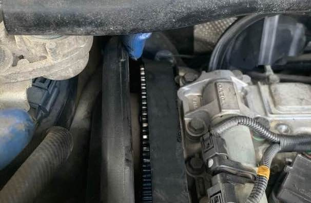

From previous post here, the high-mileage VVT walks in and out, causing the timing belt to "walk". You can clearly see the timing belt walking the exhaust side (back side). I am going to check how much play I have in my VVT this weekend.
Therefore, the VVT is bad or starting go bad and causing oil leak?
Should I replace the PCV first and see if there are any leaks later or just go ahead and VVT gear and PCV now?
Thanks
Waid

It very well could be the VVT causing the leak and the belt to walk. other possible causes could be the tensioner. I would first check the oil trap for correct vacuum at the oil dipstick tube, then check the timing tensioner. If the oil trap checks out and the tensioner springs back appropriately then change the VVT. While you are in there I would replace both cam seals regardless of what you find to be the problem. Also change the timing belt, tensioner and pulley. The oil saturation on these components can cause premature failure on any and all of these components. And that failure results in valves or at worst an engine replacement. At $100 a valve either way it’s an expensive fix. So no matter how you slice it, to do it right, you’ll need to replace the timing belt pulley and tensioner and both cam seals the only question is the oil trap and VVT.

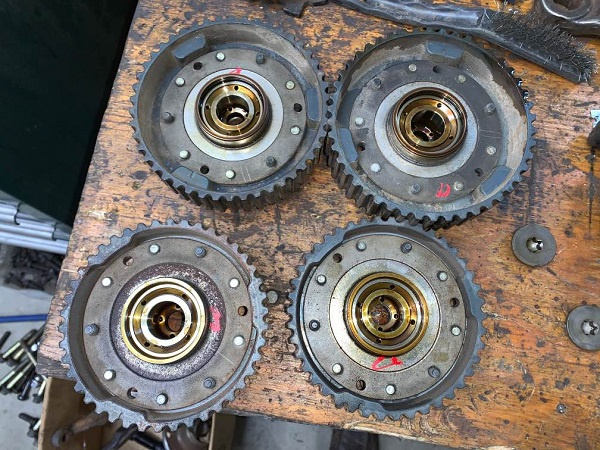

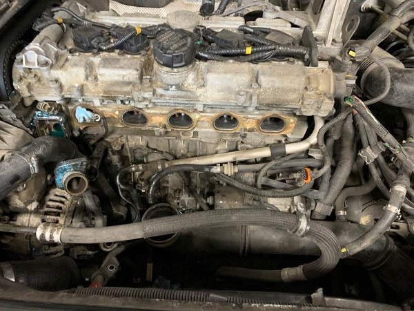

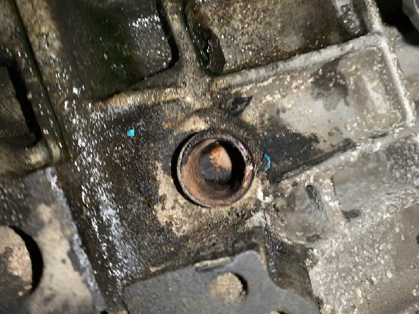

Took my PCV catch can out today and it was actually pretty clean. This was not the source of my problem! With little carb cleaner, I was able to clean it up really good. The PCV can was also in really good shape and I am soaking it while I wait for new rubber hoses. I will re-use the catch can. Went to junk yard and got 2 intake and 2 exhaust VVT gears at $6 each. They have very little play and there were no leaks on the two motor that I pulled them from. For $6 each, I am willing to try used ones with new o-rings! I will replace the intake and exhaust cam seals along with oily timing belt.

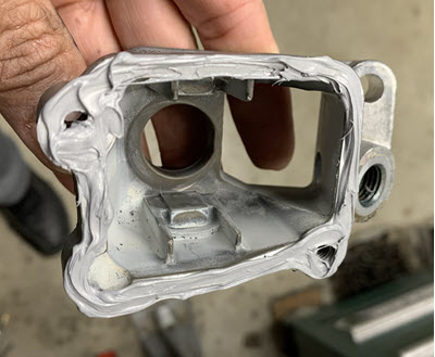

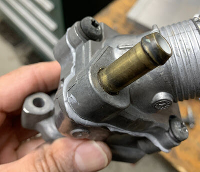

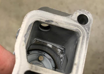

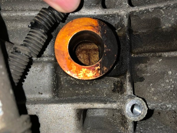

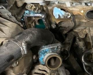

I have another problem. I had a small leak on my Thermostat Housing so I removed the two bolts. It looks like 2.5T uses two piece Thermostat Housing and I am not finding gasket any where.
Is the inner gasket for Thermostat Housing available anywhere at all?
If not, will just use good old RTV.
Waid

- Re thermostat leak, 2 options:
1. Get a new thermostat assembly and replace both the thermostat and ECT w/o the need to remove the PS Pump.
I posted detailed DIY for thermostat in forum:
viewtopic.php?f=10&t=79031
2. Get generic paper gasket from local auto parts store and cut a paper gasket yourself.
The generic paper gasket is very cheap. Just cut a template to follow the upper tstat housing.
Make sure the holes are drilled in the correct places.
There is a youtube video somewhere...

I ended up using RTV from Permatex specifically formulated for Thermostat Housings. I have used RTV many times in the past and never had any issues.
