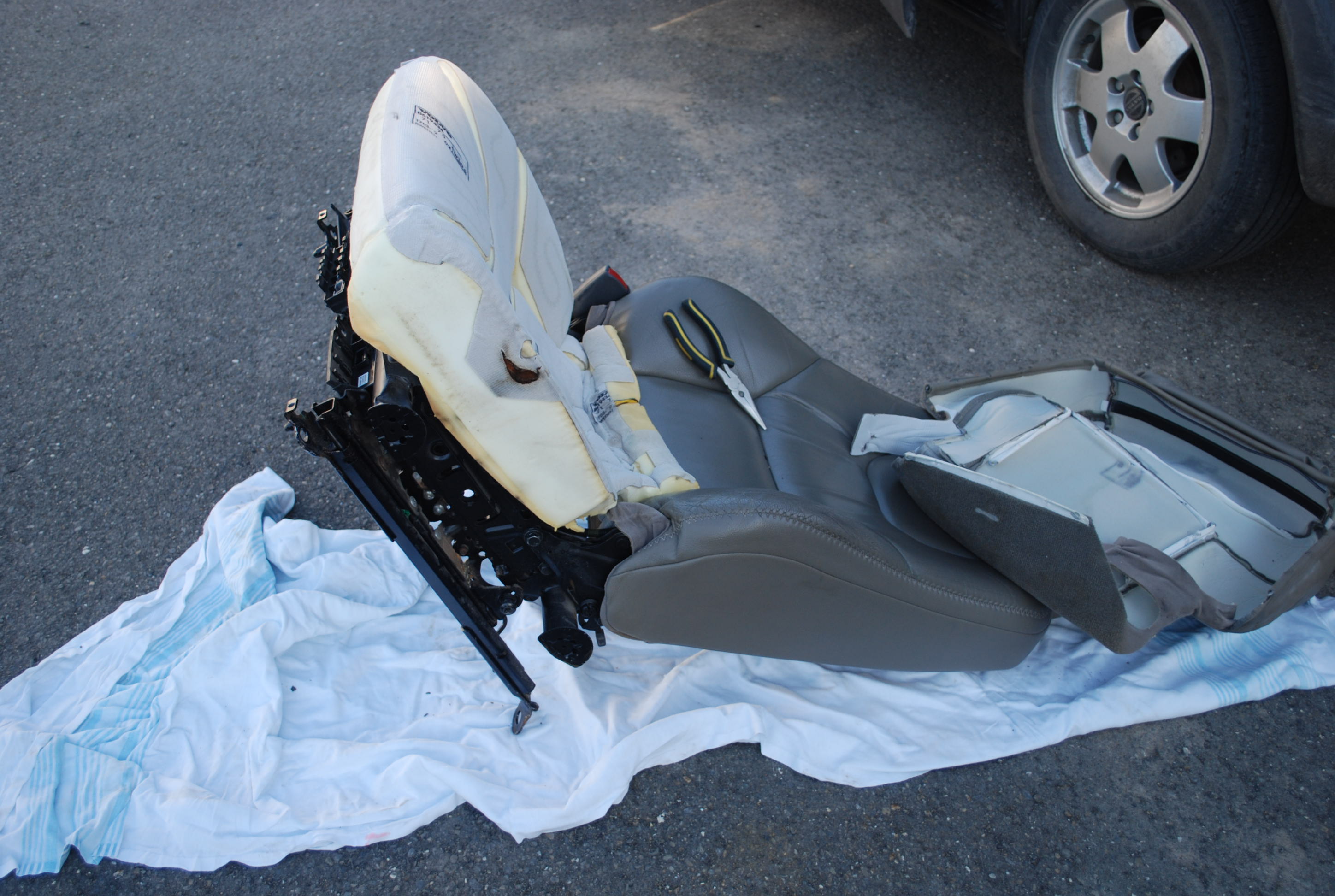

The part number for the replacement pad in the v-70 XC and s-60 2001-2007 is 30675155 aval at FCP Gr_ or the dealer. The thermostat is built into the heating pad in this model unlike the 850 seats referenced above. The rest of the write up is still applicable to these later years.
If there is no heat and no continuity on the large wires the element has burnt out. Mine went on the side of the seat were it flexes past one of the leather seams.
Thanks Matt for the forum and the post on the seat replacement
Volvo XC-70 seat heater p# 30675155
v70-XC 2002 seat heater failure.
