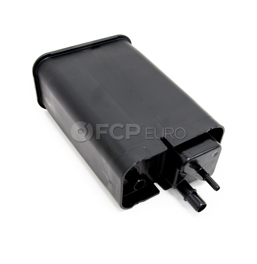

wczimmerman wrote: 27 Feb 2020, 20:48 Does anyone have a picture of the evap canister so I know what I'm looking for?

I do see it. So, drop the exhaust and remove the heat shield should reveal that canister? Then I just check the lines for signs of leakage.vtl wrote: 27 Feb 2020, 20:56 I hope you see the picture. Box with a cross is the canister, white box to the right - EVAP diagnostic pump.
