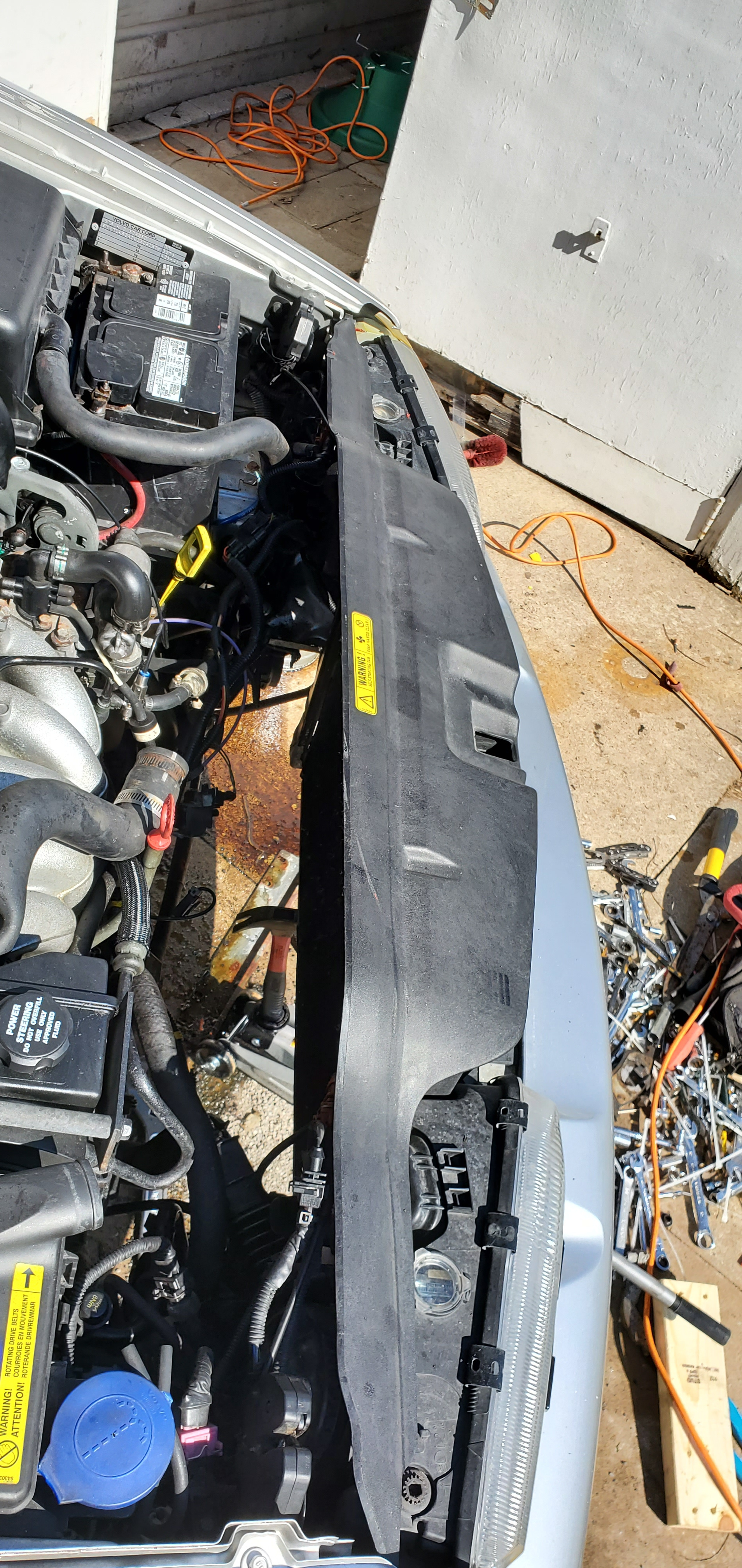

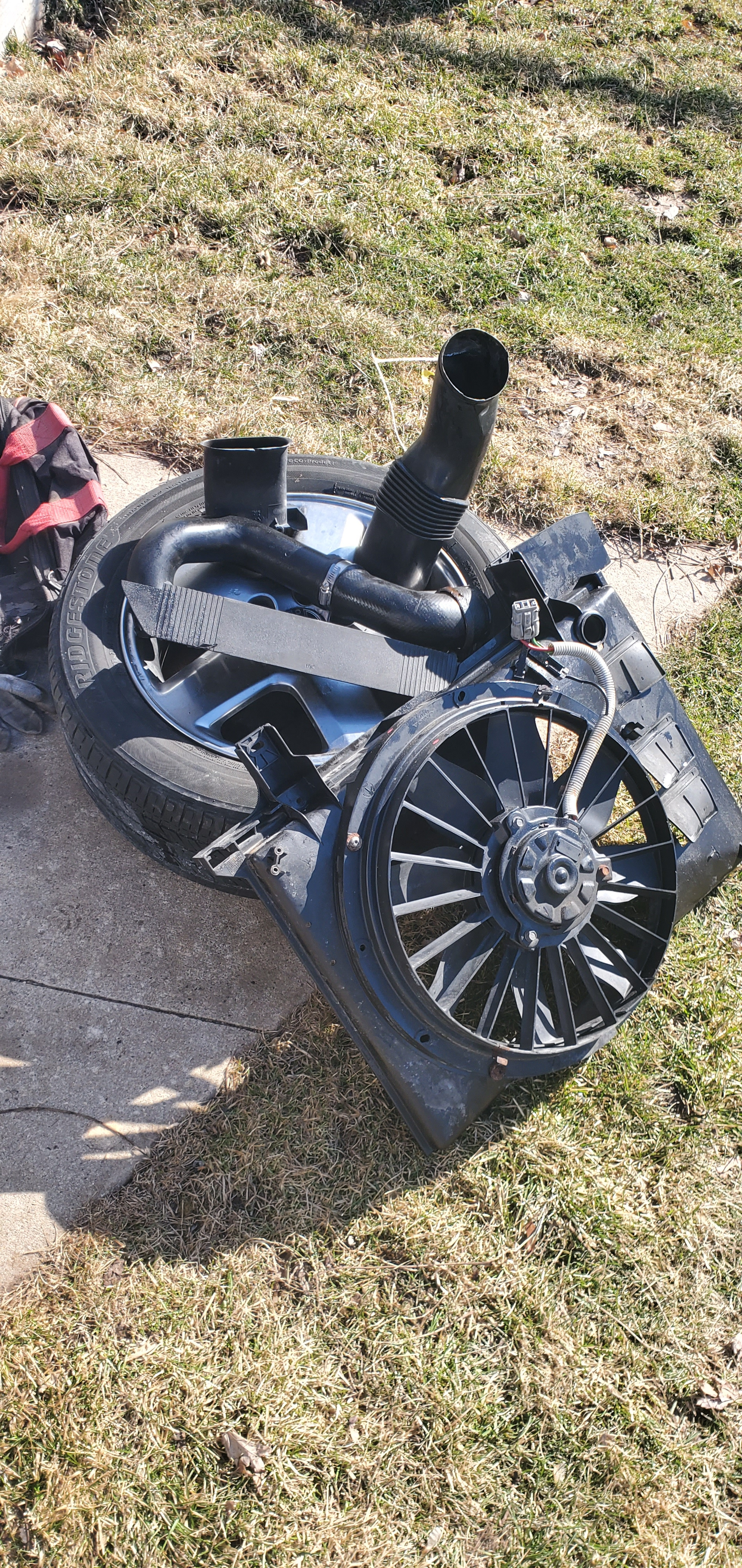

Fan is out.
Thanks to RobertDIY. LOL

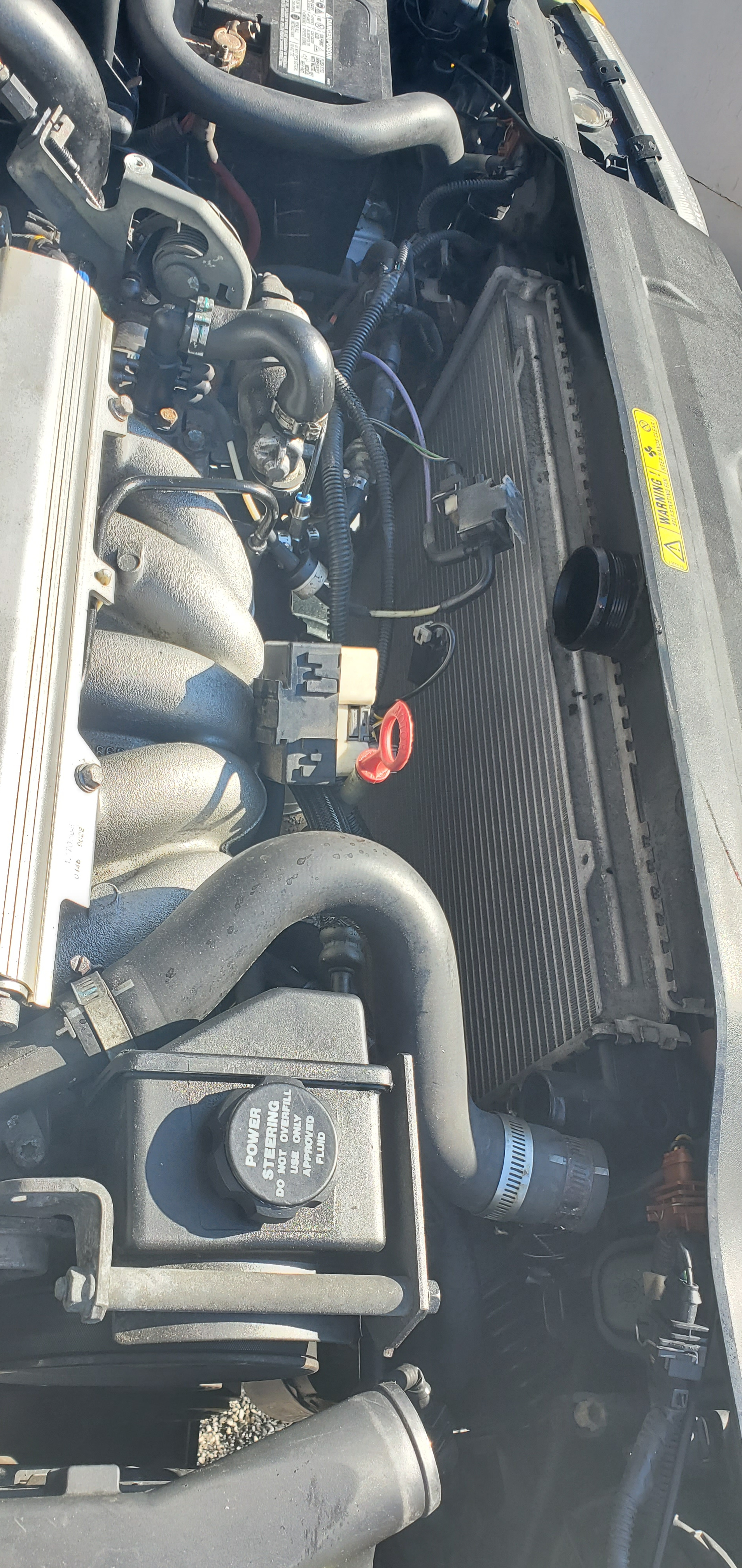

Radiator shelf thing circle nuts are broken and seized. F$@K this thing!!!

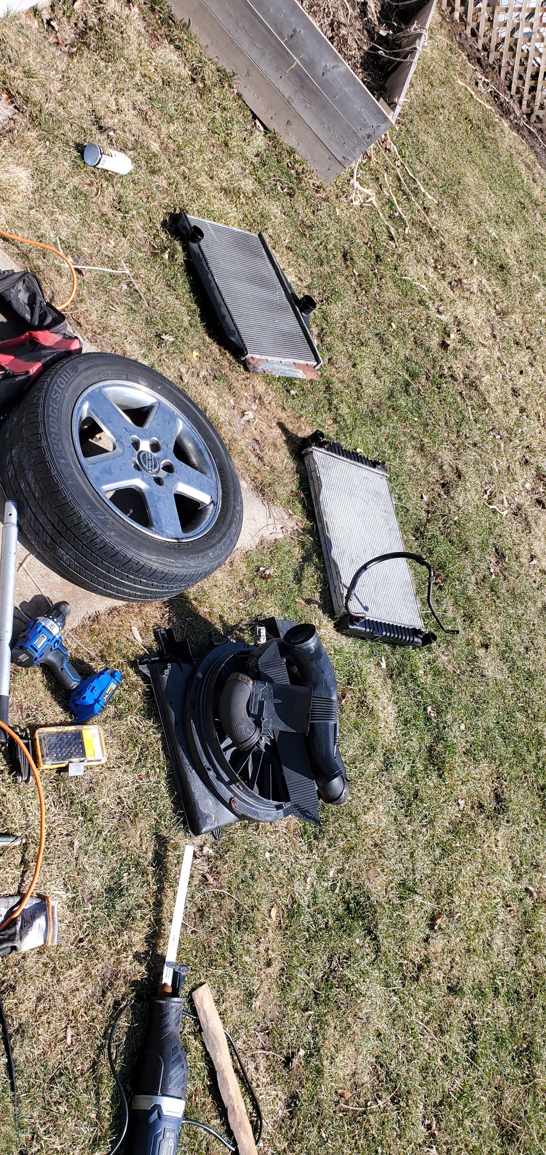

Off to buy a hack saw.

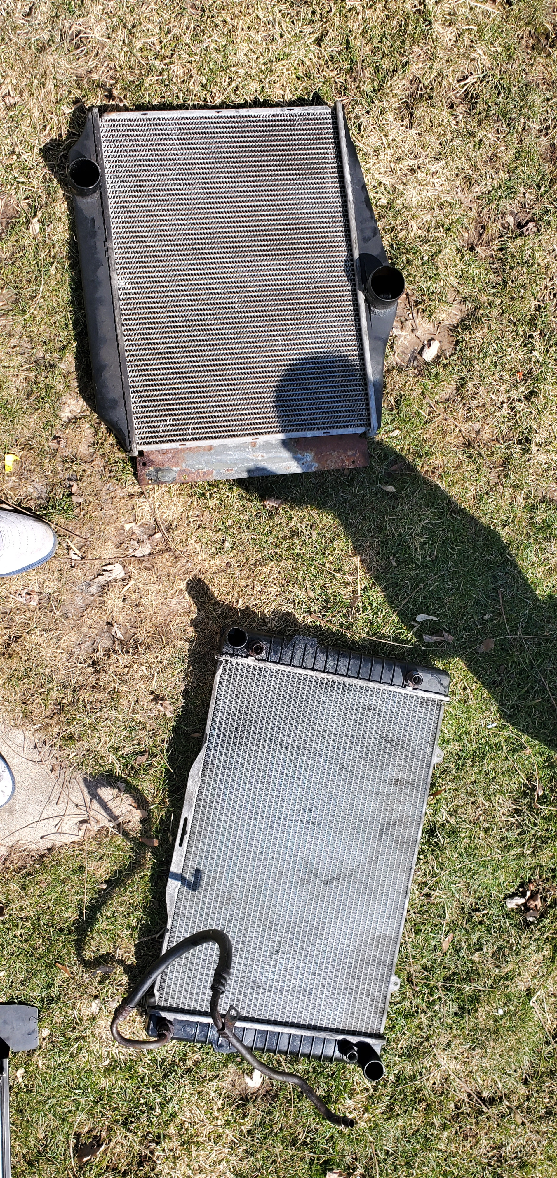

This was NOT fun...
Putting it back in is going to be worse...

TheOtherside wrote: 17 Mar 2020, 10:45 Radiator shelf thing circle nuts are broken and seized. F$@K this thing!!!
Yeah, and you can't heat unless you are really careful not to melt/set afire the rad.
Go SS on those - even cheap Lowes SS will work

Was the intercooler supposed to fall out also? Lol.
