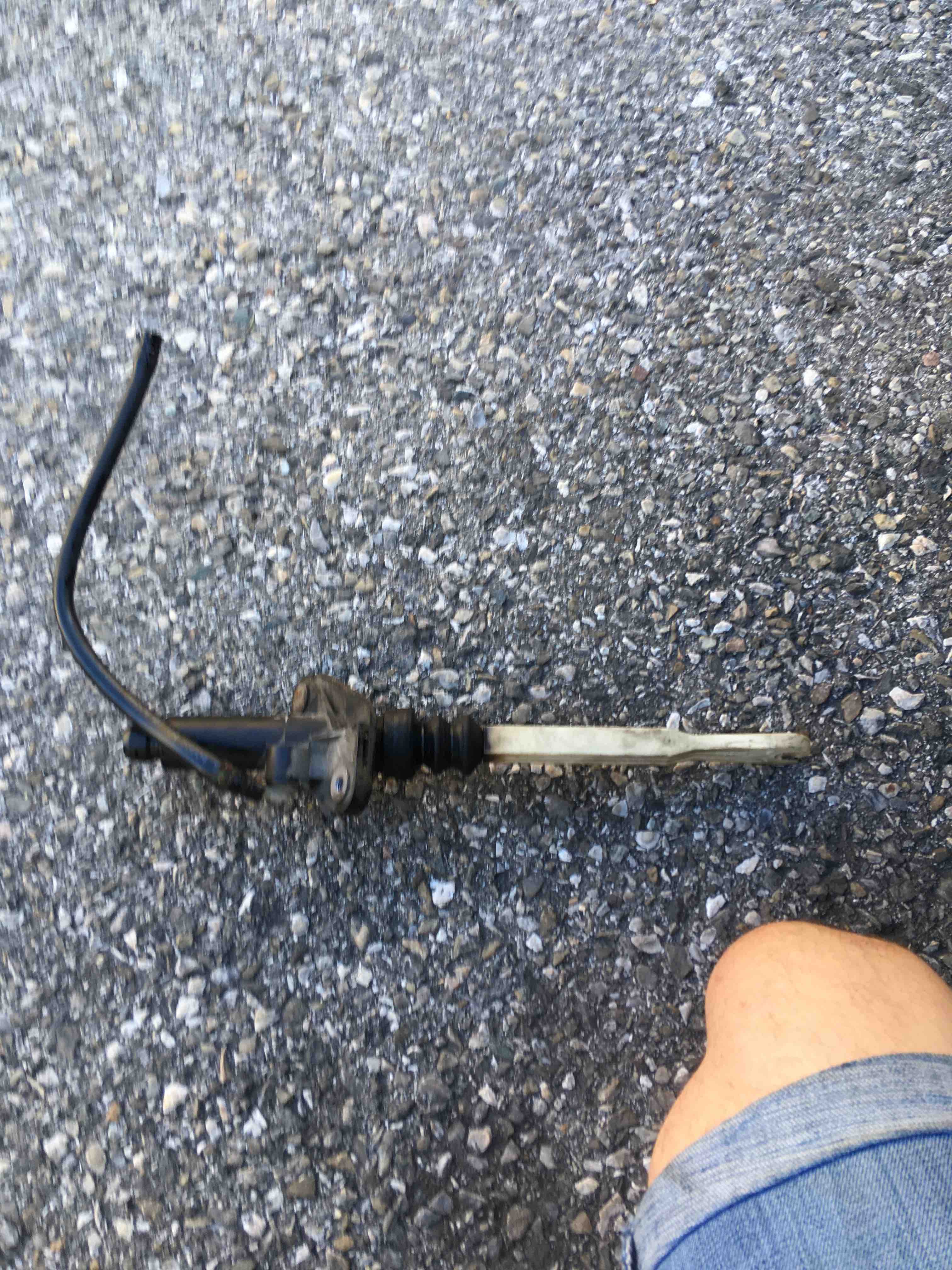

Here is the part I've taken out. As you can see, the hose has a clamp and the hose is a stiff one. The one I have installed is a soft one, and I have forgotten the clamp. I will put everything on place and see how it goes.
Manov
Manov

So, the issue comes from the soft hose I have installed to replace the old one. This hose is too soft. I have to unbolt everything between the master cylinder brakes lines, the master cylinder itself, the brake booster (a bit to be able to move the pedal clutch cylinder), and replace the hose by a good one.

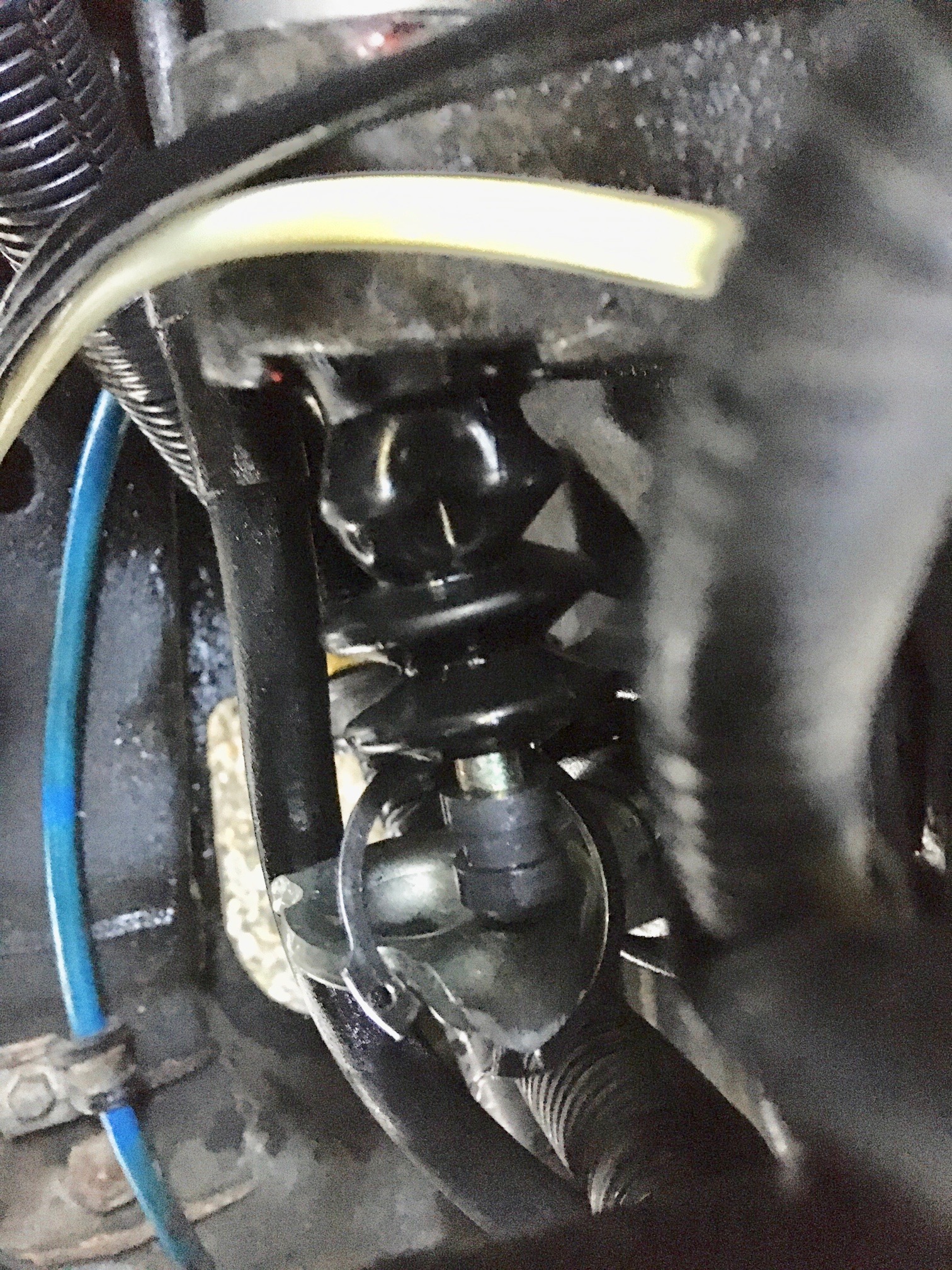

What is that mess ? For the second time, the slave cylinder on the gearbox has exploded ! I don't understand... The first one, ok, let's admit that as a newbie, my IQ is low enough to be unable ton hold wrench. But two times at a week of distance, it can may be not be my fault...
I've emptied the all system properly, removed the hose that was too thin to me, replaced everything with clamp, screw the right way, feed up the master cylinder reservoir, everything was fine. I've pressed 2-3 times the slave cylinder to see if it was ok, then I sat behind the steering and when I pushed the clutch pedal, there was a "normal" resistance, it came back to its normal place , I've pushed a 2 time, the pedal stayed glued in front of the bay. I've look to the slave cylinder on the gearbox, it was full of liquid, in extension, the piston out !!!
I don't understand. Any idea ?

It looks more like that c-clip is not staying seated. That's why it looks over-extended. I've had that happen to me on my current manual swap in my '97. Got it bled, pumped things a couple times, then *clink* *pop* mess all over.
My suggestion (After cleaning everything up
) is to reinstall the slave, seat the c-clip as well as you can, checking all around to make sure it's seated. Then take a hose clamp that is big enough to go around the slave cylinder body, and tighten that down to help secure the c-clip.
The transmission I have was damaged before I got it, and the boss on the bellhousing is a bit dodgy. I wound up installing that clamp years ago when I replaced a clutch in the car I pulled this transmission from. I'd forgotten about it until this happened on my project.
Your c-clip may also be damaged. It looks to be pretty bent and "open", so it also is probably time for a new one anyway.

I'm just basing this on the picture you posted above. The gap in the c-clip looks to be well over 10mm. On my spare clip I have in the garage, that clip is closer to 3mm.manovlov wrote: 06 Sep 2020, 00:43
@Chuck W : Yes, it seems to be what happens.The part is called by Skandix a "Pro version" on their catalog. I'm leaning towards the idea of the throat holding the c-clip not deep enough to keep it in place, a manufacturing defect. Your explanation sounds a good track to me. I'm not going to re install it using your tip, because it's not normal to the this part to do its job this way. I will send back the part to Skandix For me the part is defect, because using a clamp, you will admit... The c-clip is brand new, ordered and received it last week.
If the c-clip is in good order, that groove on the cylinder is plenty deep enough to hold things in place IF the c-clip is fully seated all the way around. When installed that gap should be no more than 3-4mm or so, as you have to expand it slightly to get it over the cylinder body, and it then snaps back to size once it seats.
Post a picture of the c-clip not installed, just to see if it's bent or deformed at all, because in the picture above, it looks bent and pretty useless.

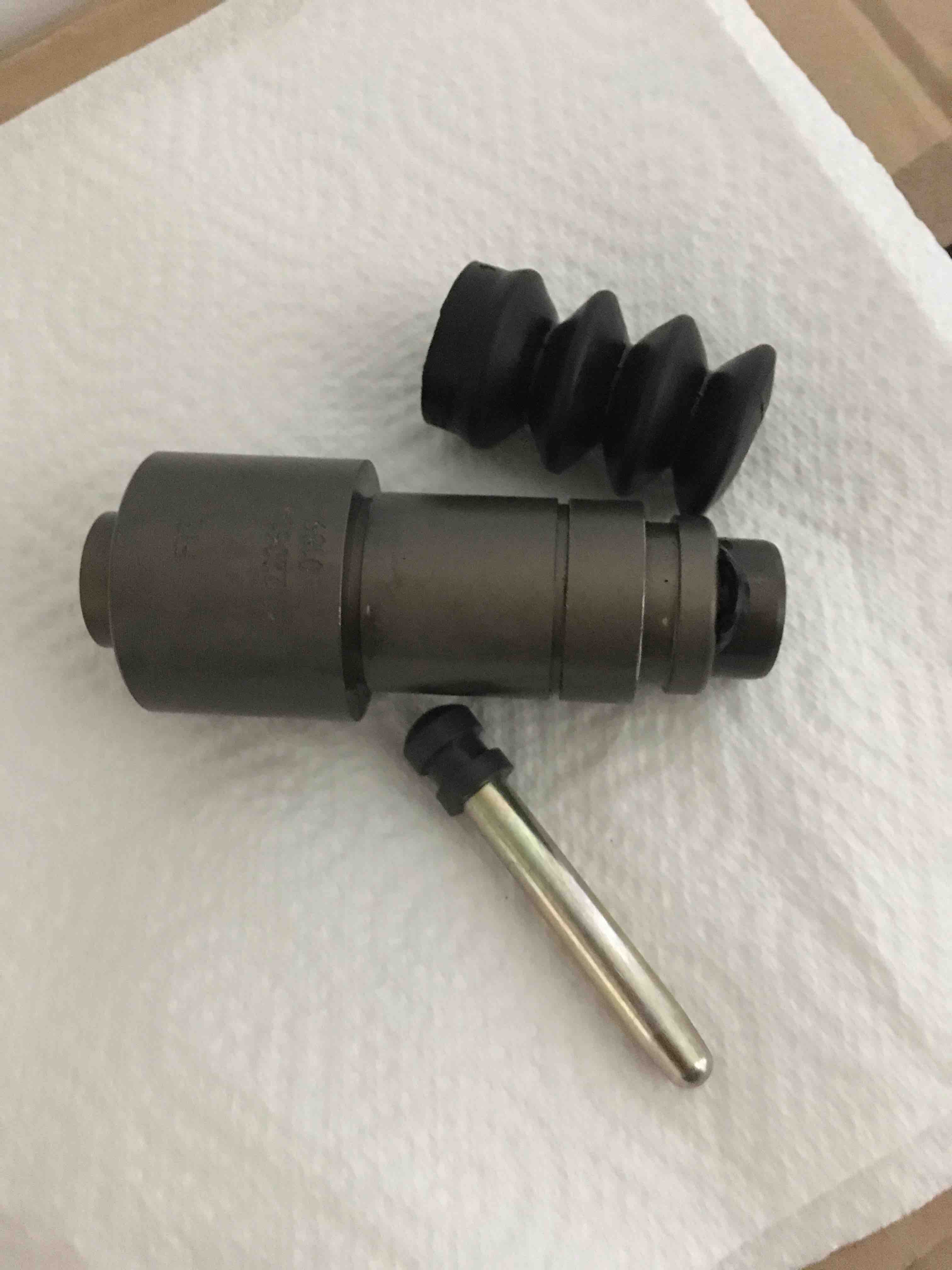

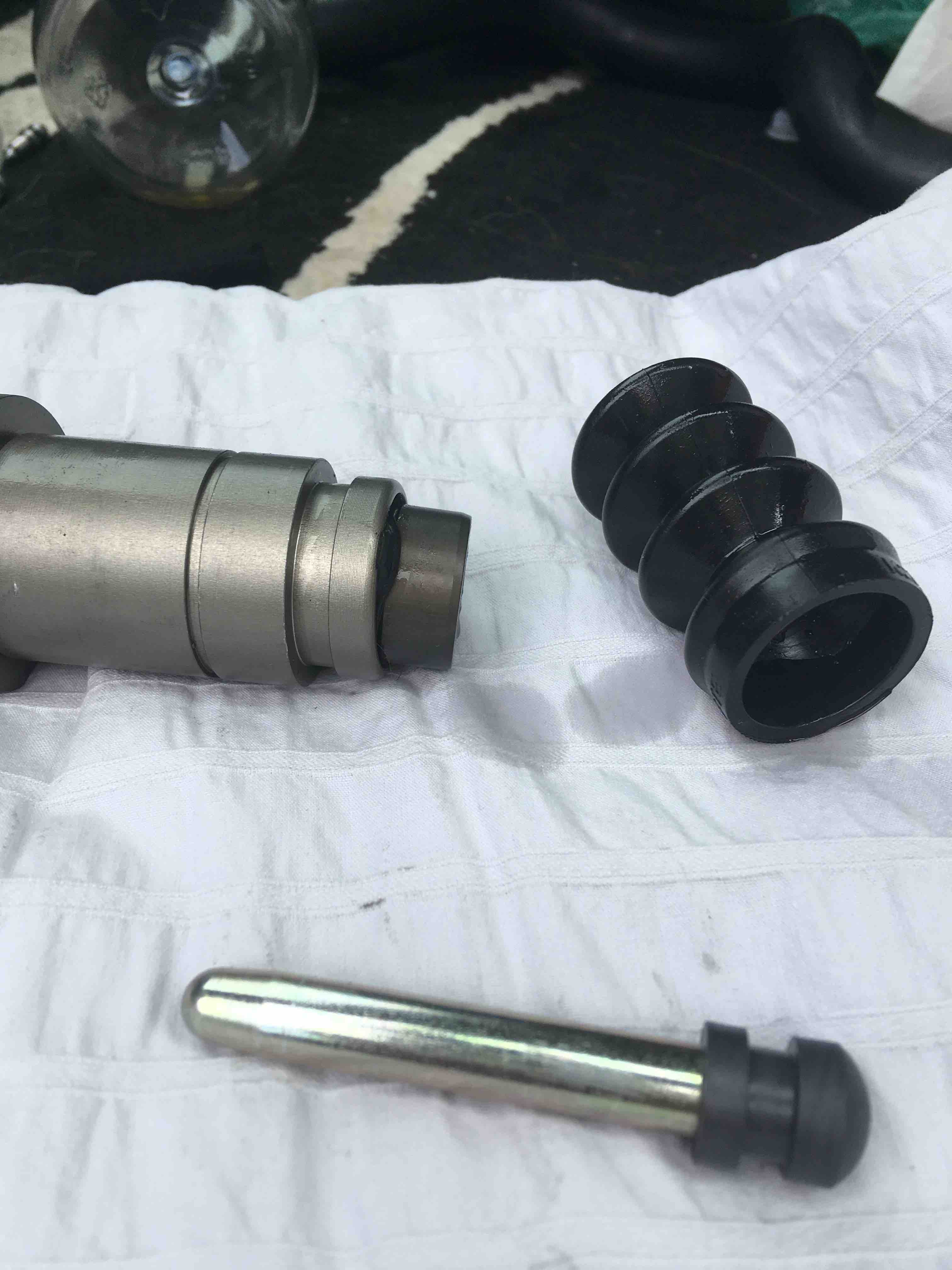

I will post the picture as soon ASAP. For the moment, here's the second cylinder. Curious to see that the inside seal broke the exact same way. I still bend for a defect part.
I don't know if the inside seal has been hurt, so to try to re install this slave cylinder, if the trouble still stay, not a good idea I think.
Manov
Manov
