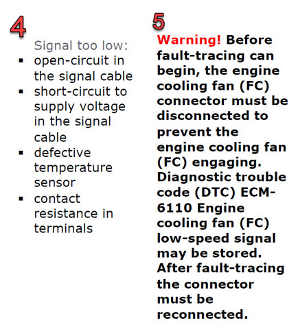

1. New Thermostat (89C/192F)
2. New Engine Coolant Temperature Sensor
3. FAULT CODE:
ECM-2000 Engine Coolant Temperature (ECT) Sensor - Signal too low.
Please, educate me. Why should I get the ECM-2000 code if I have #1 & #2
All the reading I did on the ECT, I did not come across #5.
Thanks you!
3. FAULT CODE:
Thanks you!

The wires going into the electrical connector get damaged, either exposed - possible short, or simply cracked

You mean the one connected to the Coolant Temperature Sensor? If you mean that, I have really not checked it's integrity. I really should.oragex wrote: 26 Sep 2020, 00:23 The wires going into the electrical connector get damaged, either exposed - possible short, or simply cracked
