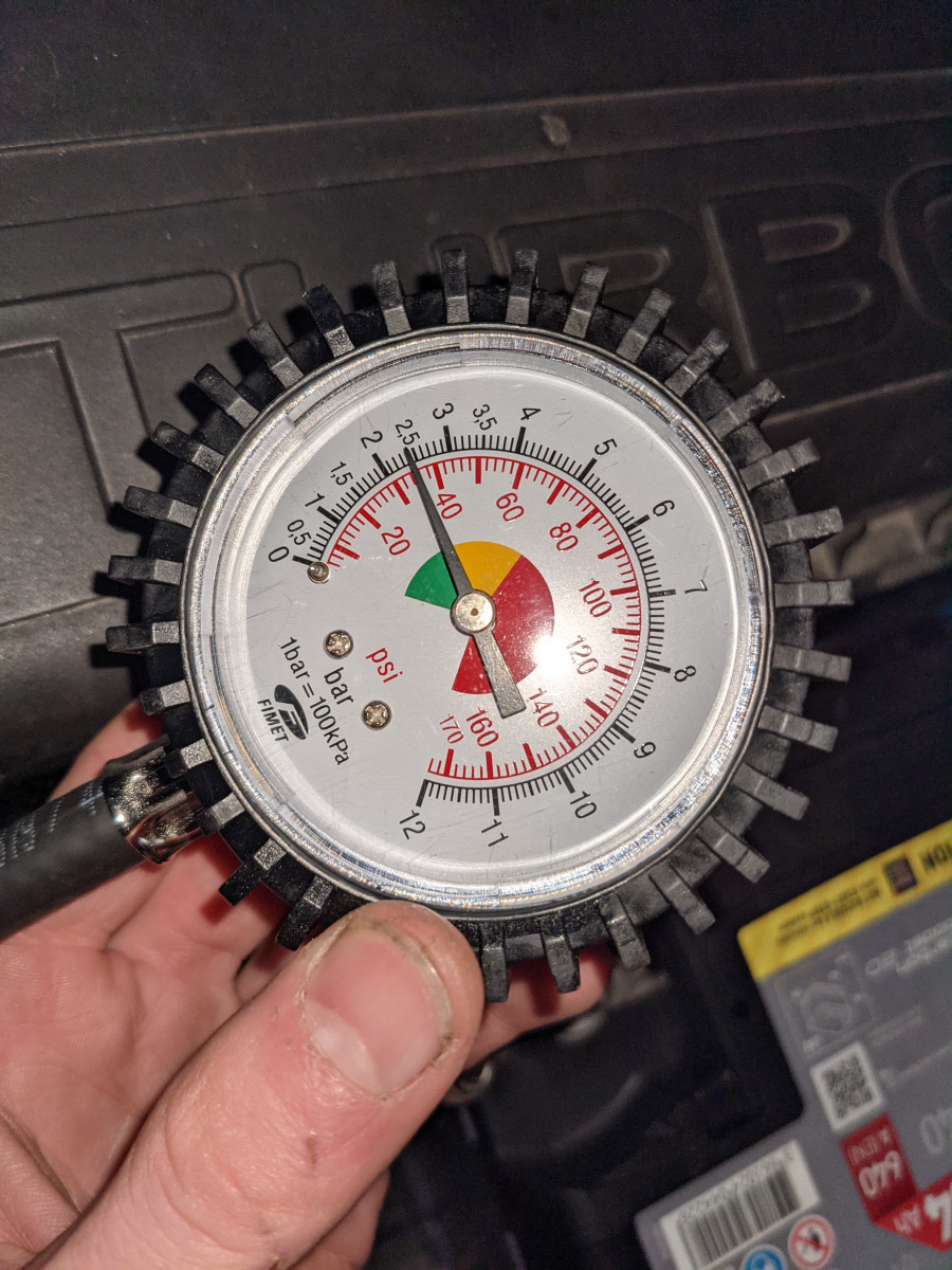

Okay, tested the fuel pressure today, seems fine to me.
Key on position 2 At idle Blipping the throttle while stationary

I believe at idle you should be at 43psi. So you might be on to a problem.

No,Sveedy...it have vacuum controlled FPR at fuel rail.Sveedy wrote: 15 Mar 2021, 18:43 I believe at idle you should be at 43psi. So you might be on to a problem.
M4.4 with FPR at fuel filter have steady 43 psi all the time.
With FPR at fuel rail,fuel pressure changes at idle and at WOT...but on 1st prime it should be at 43 psi and at WOT.
At idle it should be around 35 psi because the vacuum controls it.

So quick question: If I'm set up with M4.4 but have a FPR on the rail, what should my pressure be ? 35psi at idle ?
If so then I'm getting a little too much pressure myself.

Yes...if FPR is stock.Sveedy wrote: 16 Mar 2021, 08:48 So quick question: If I'm set up with M4.4 but have a FPR on the rail, what should my pressure be ? 35psi at idle ?
Now back to Fiodor's problem...
With factory setup,M4.4 cars have constant 43.5psi fuel pressure no matter if engine is idling or at WOT.
