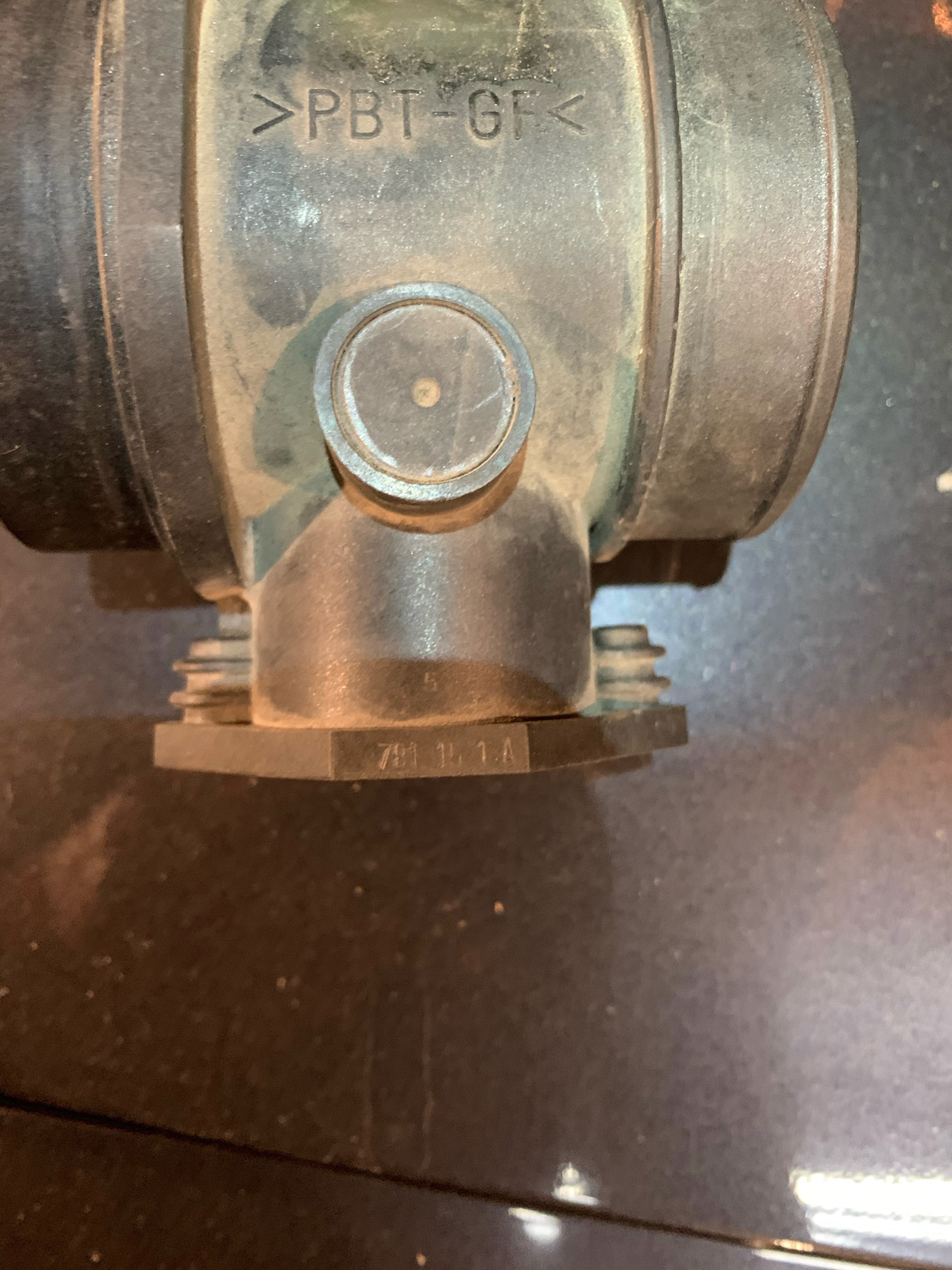

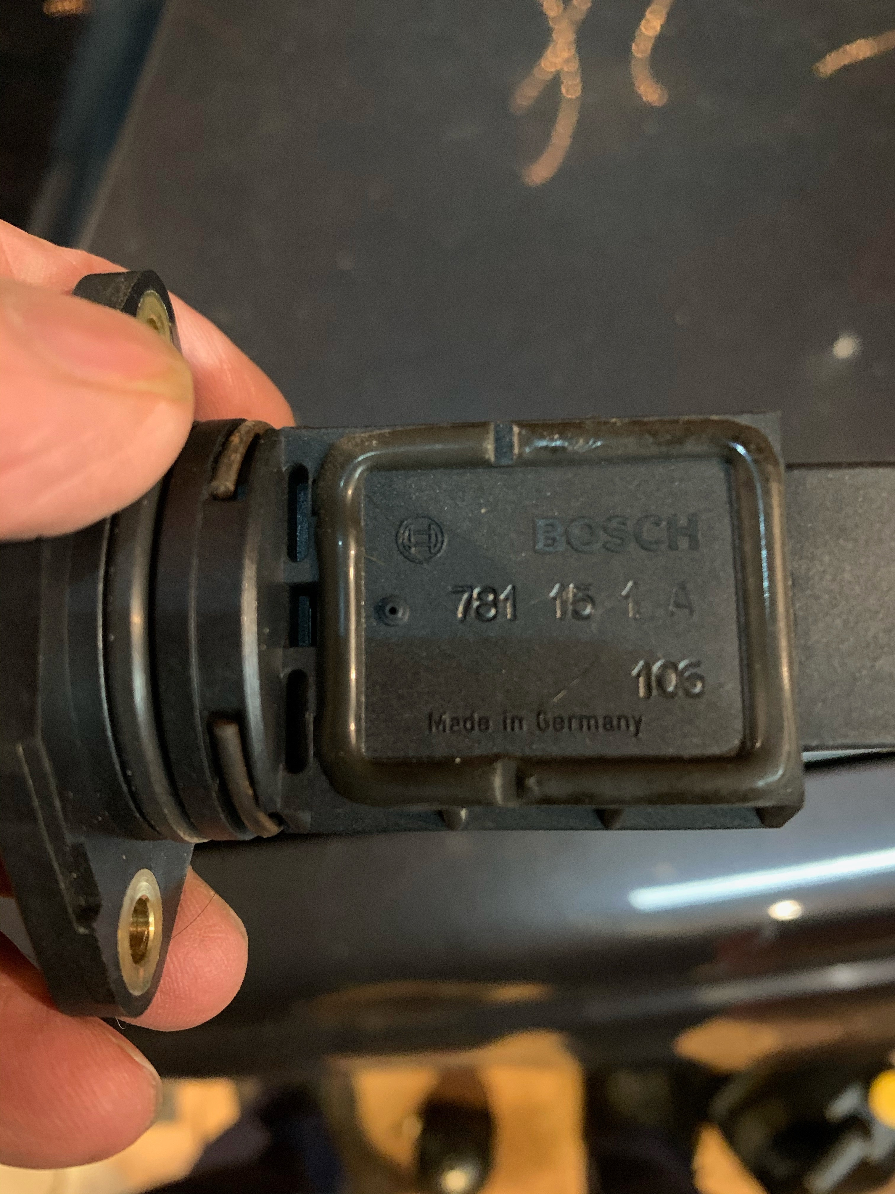

OK so it is just speculation, no actual data, fair enough. Yes, taking apart the MAF is simple and the sensing element should never be touched. Fortunately the sensing surfaces are still pretty well protected even when the sensor is removed from the housing.
As misha has posted a couple times in this thread, the most common P80 MAF and the subject of this thread is the ubiquitous Bosch 0 280 217 107, used in most later-year P80 cars (all 95 turbo, all 96-98 both turbo and NA; US model years).
For Bosch 0 280 217 107, the sensor-only part number appears to be 781 15 1 A, possibly with 106 appended: Note the number 781 15 1 A is also stamped on the housing where the sensor inserts: I anticipate it will be difficult to match up this info and find another source of 781 15 1 A as Bosch doesn't make these numbers available (obviously, or we'd already have them without looking at one for the sensor number). But any patient internet search pros are certainly encouraged to click away!
