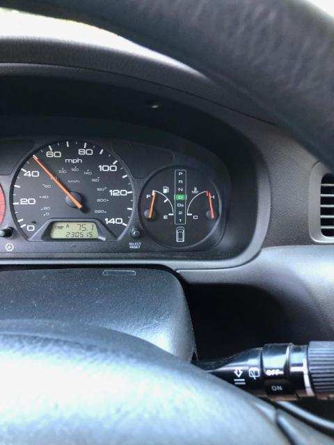

Don't mean to hijack this thread but we encounter that question today with our 03 Odyssey. 90 degrees weather and 2 miles into a 12 mile trip with a van full of furnishing and it's above the red. Pulled over, AC fan on, coolant level good, no coolant spewing so drove on. 2 mile before destination gauge drop to slightly below half which is normal for our van due to a radiator trans-cooler bypass.
Pretty fresh Rotella synthetic change and Havoline synthetic in transmission (complete flush) with a radiator trans-cooler bypass. Cooler is ahead of radiator. No engine lights and the car ran normal. Was thinking Thermostat the entire trip. After returning we think the impeller had spun freely on the water pump shaft and than on / working again. Waterpump is very noisy and burning smell right above it so parking now for sure.
Winter saw a very large coolant leak so parked it. Warmer weather sealed the leak and after a dozen moving trips in the last week in hotter weather it's finally time to repair it before damaging something.
