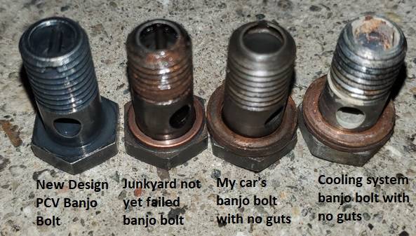

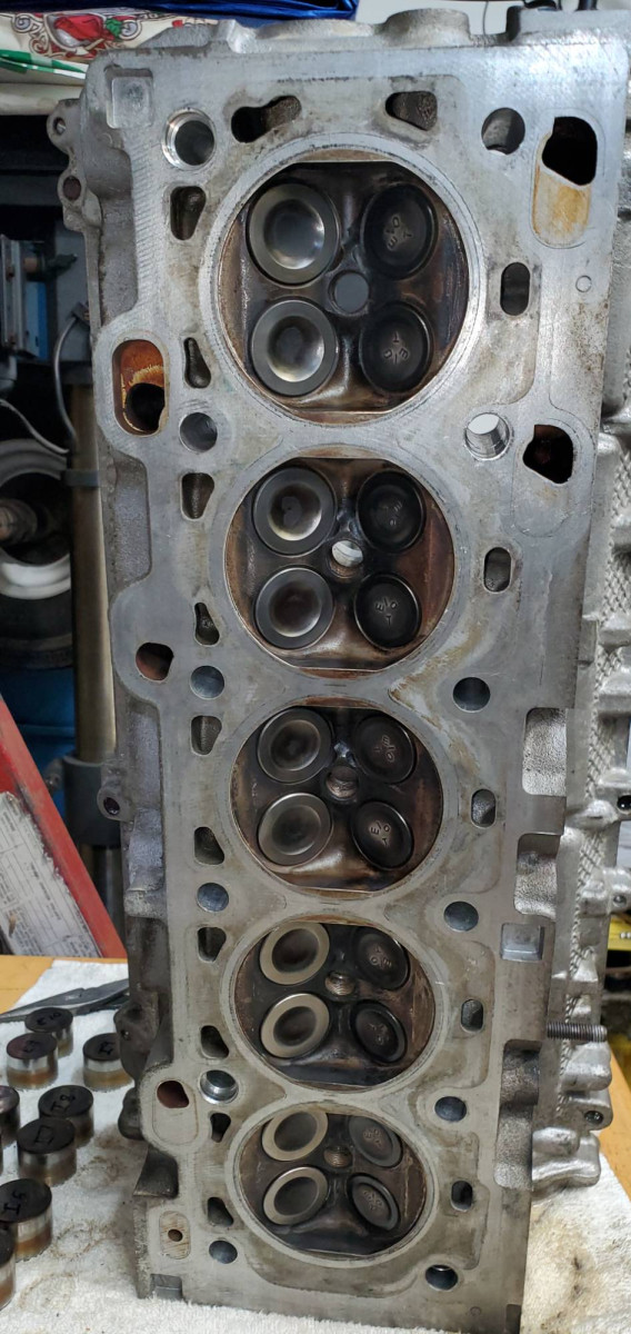

This forum posting for a disassembled PCV check valve banjo bolt was key for me to figure out what happened to my 2007 Ti S60 that had bad compression on cylinder 3.
After a bunch of research, I opened the engine and found damage from the pin and ball: I purchased a replacement head at a pick-n-pull junkyard along with a like new PCV system. The valves were all cleaned, seats and valves lapped, valve stem seals replaced, and clearances verified to all be in tolerance for the solid tappets. The protrusions on the piston were all smoothed.

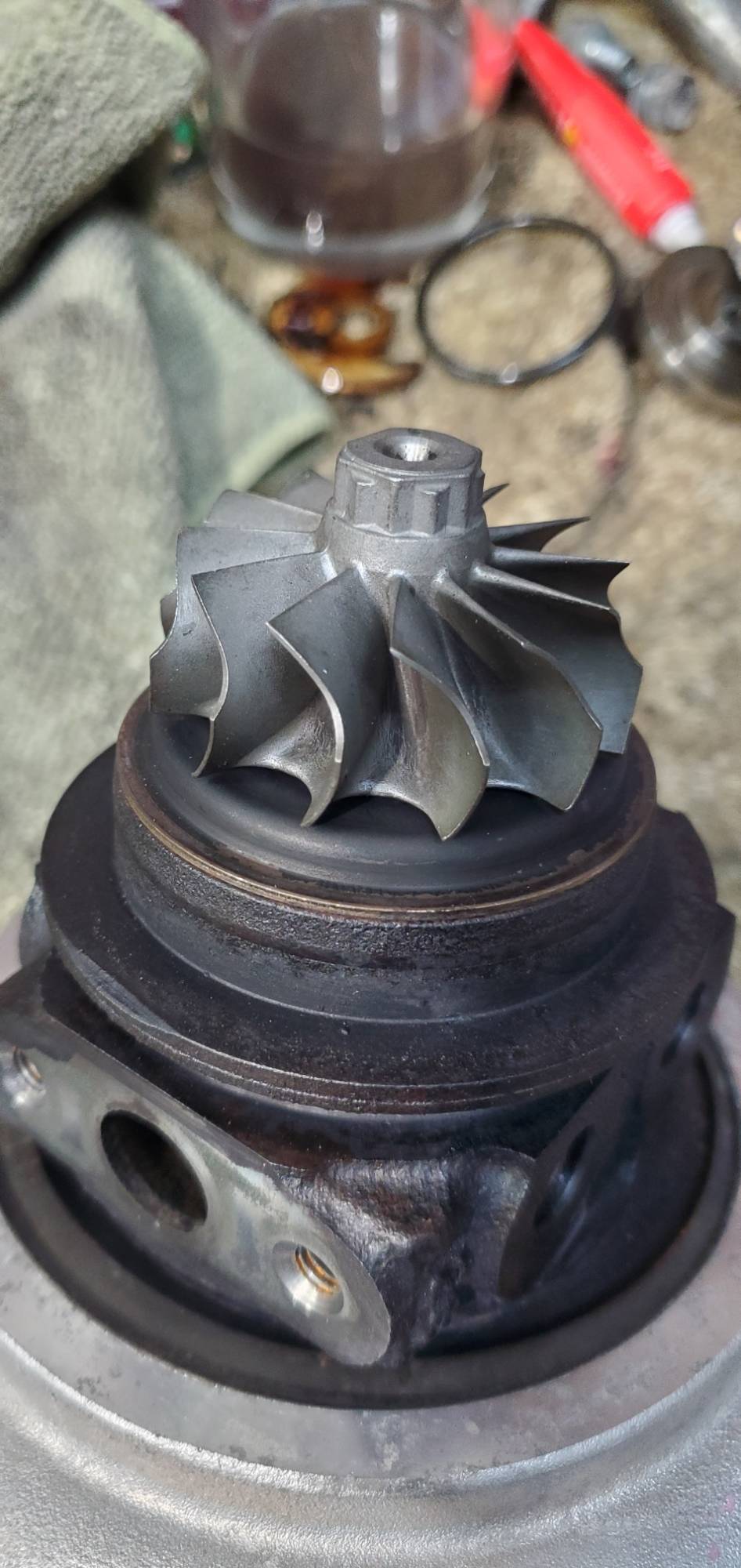

Then I learned that the PCV valve guts had also gone through to the turbo: I got a turbo out of a low mileage junkyard car and rebuild it with a kit recommended on this site. (Soaking in strong phosphoric acid does a great job removing the buildup of exhaust contaminants on the impeller.) I temporarily used a PCV check valve from the junkyard car and then replaced it with the new design check valve. Here is a complete lineup of the 4 Volvo P2 platform banjo bolt versions that you will encounter:
[attachment=0]Banjo_Bolts.jpg[/attachment
The information on this website plus Vida/Dice, junkyard parts, FCP Euro parts, and a bunch of new tools and time got my S60 back on the road.
I hope this post helps some other Volvo owners get the message that replacing your PCV banjo bolt is a very good idea!
