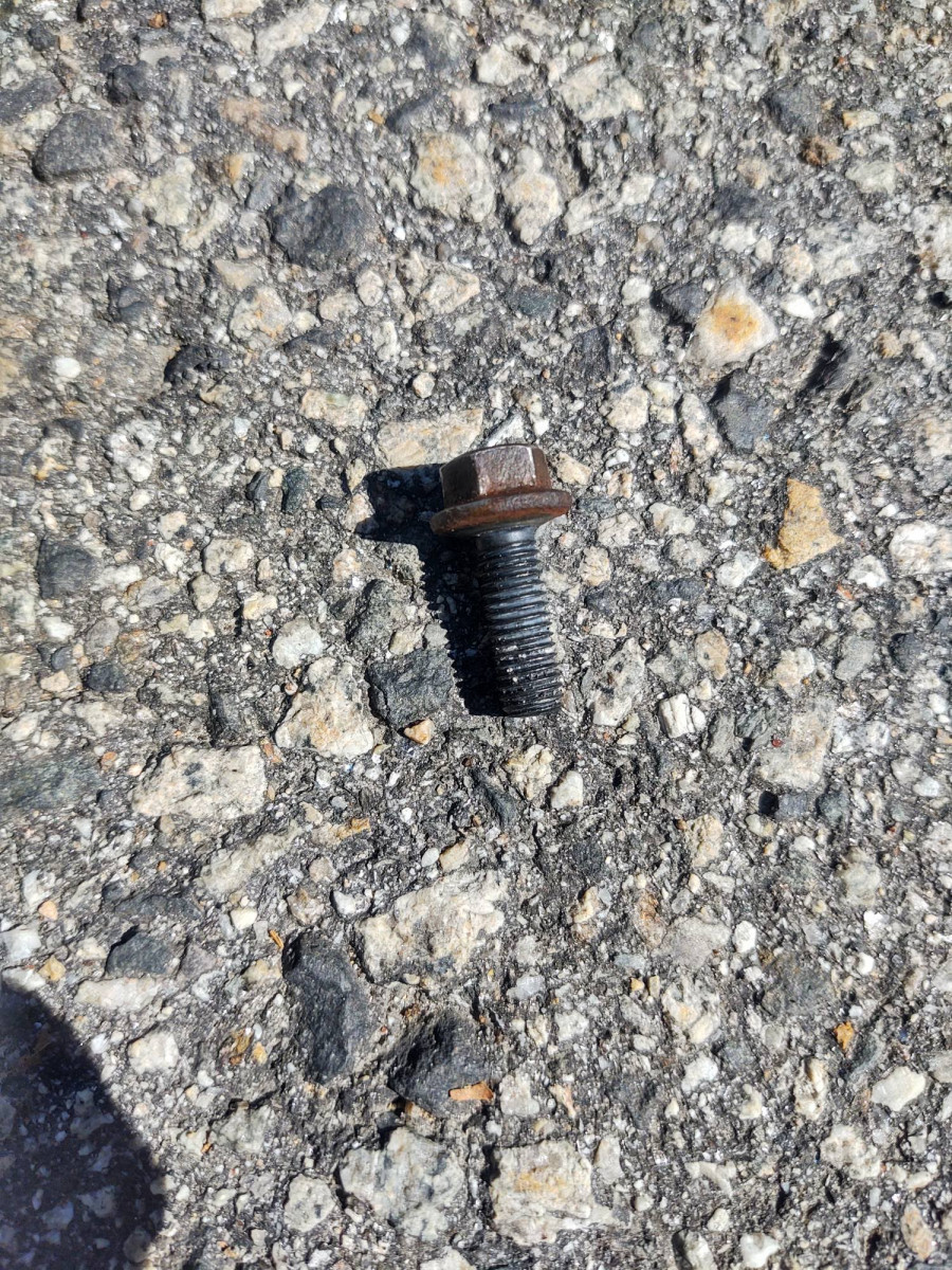

Check it Out!
It's out and it took next to nothing to turn it - just cracked it and I was able to turn it with my fingers.
Good thing too bc that's about all the space I had once I got the offset in there.
Huge Thanks to Scott 850 and Abscate for putting on the right path.

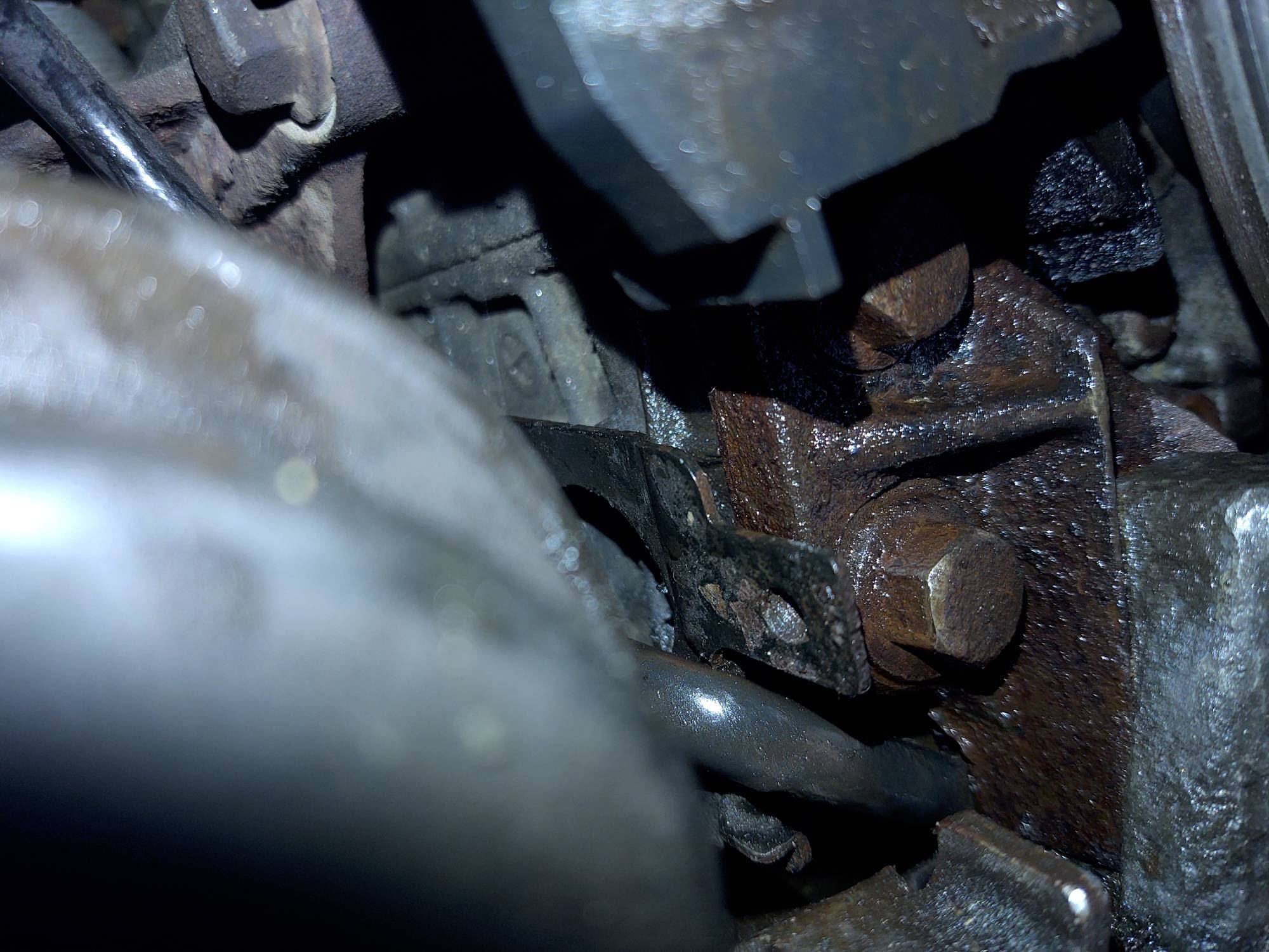

The side 14mm seemed to have tightened up after yesterday's rain, I was able to crack them both easily enough a couple of days ago but they feel very resistant today.
I am currently soaking in PB Blaster.
Since the bracket isn't threaded - should I be putting some heat on the block behind this bracket where the bolts thread into?
Seen in the second picture.
It's a very tight fit for a torch and obviously, I want to be as careful as possible in removing these bolts in this location.
Thanks to everyone here for helping to get me this far.
Job completion is in sight!

I guess it must be the rain yesterday, but I was able to lightly crack the 14mm bolts a few days ago and it felt like they were going to turn
but today they felt Very tight and resistant, so I didn't push it and just soaked it with PB
I really can't get much of flame on the block where they are really threading in too crowded and a little concerned about melting oil pan gasket right there?
If I heat the bracket itself until it is white-hot will it transfer enough heat to the block and threads to free up the bolts?
Any suggestions to make sure this job finishes strong and those bolts come out safely is much appreciated.

No red or white hot heat needed. Just get 30 seconds of propane heat on the bolt head. Use wood to deflect the flame ftom plastic stuff
