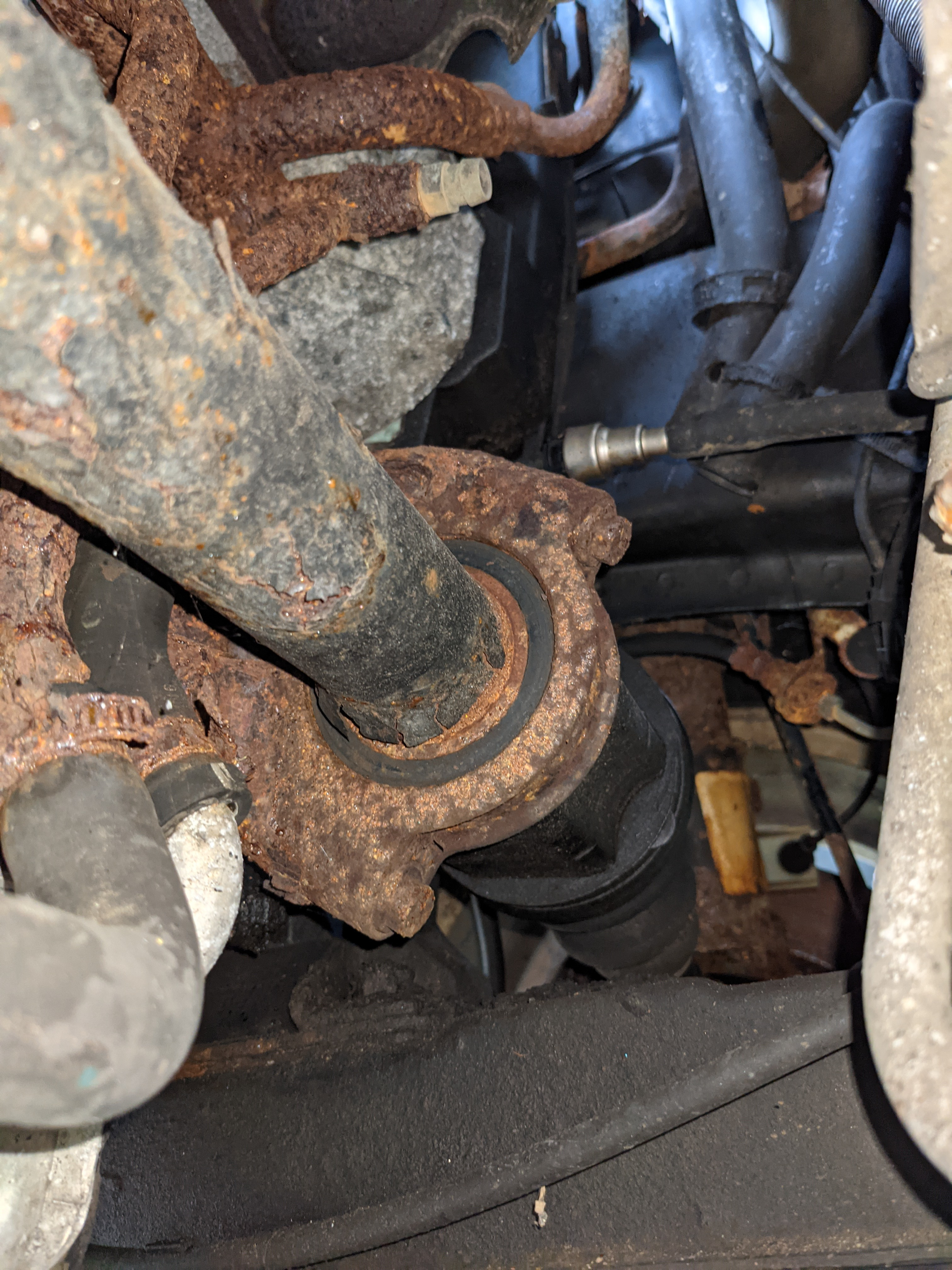

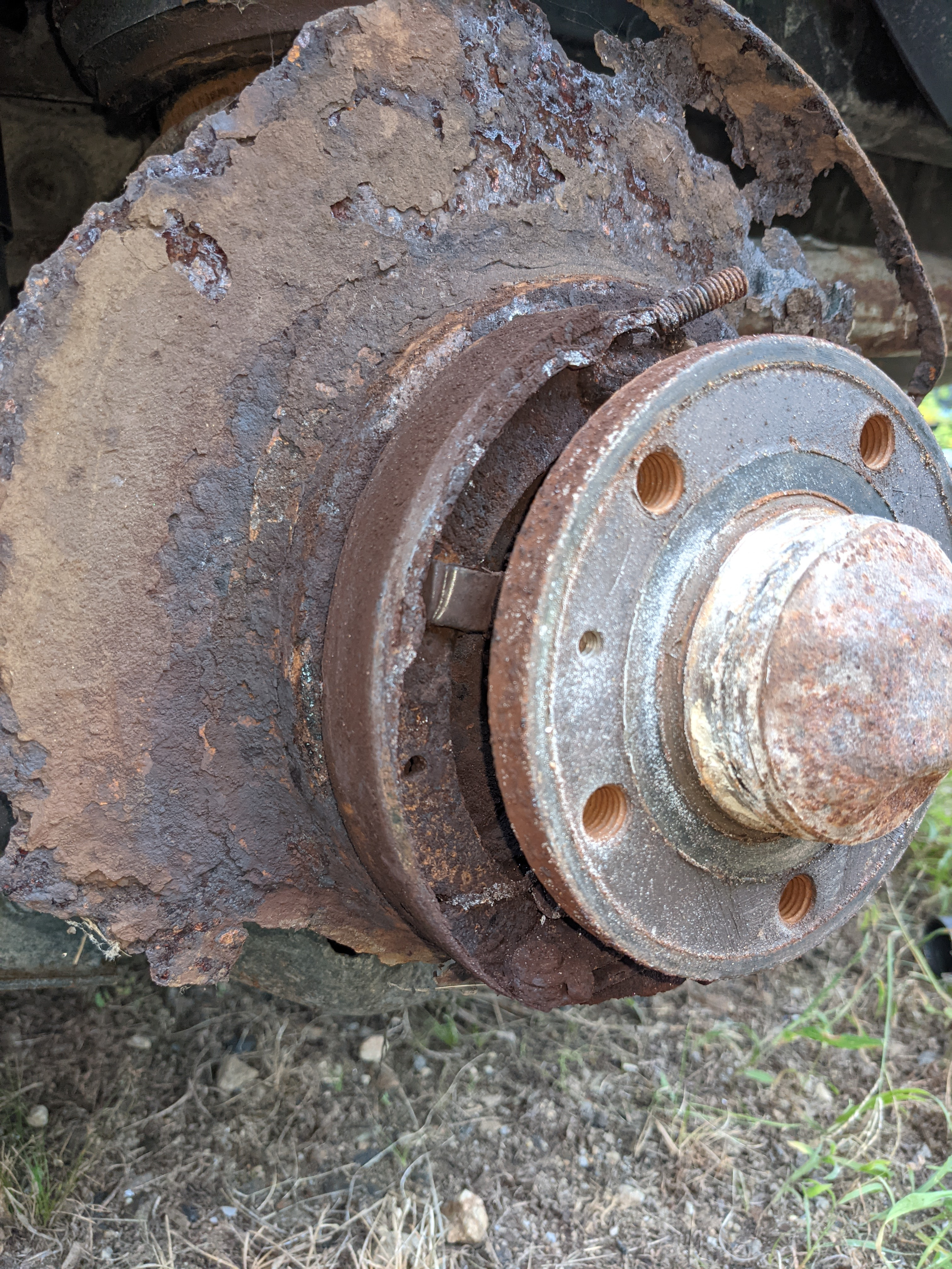

I thik I damaged the ABS system, causing the dashboard ABS light to come on. To remove the rusty front brakes, I used a pad spreader on the pad ears. Typically this works, pushing fluid back into the reservoir. Unfortunately, I had the brake pedal depressed half way to "close the valve" and the pads didn't move. When I opened the bleed valve, I was easily able to spread the pads. Dumb move, always open the bleed valve.
So I put a bunch of back pressure against the valve which was closed by the pedal bring half depressed. Do you think I ruined it?

It is possible based on what you did. I normally remove or loosen the brake fluid cap but also recommend using the bleed nipple before trying to move the caliper pistons back into place.
Again, before expecting the worst, it could be a couple of other issues in the ABS system which are more common:
1) The ABS modules are prone to age related failure (see Mid-West ABS website as Matty Moo has a lot of good info on there)
2) The cables to the ABS sensors can break their wires near the hubs internally. The resistance can be checked on these.
Should add a 3rd to that. The connectors at the ABS module can also get crusty with age and sitting. Carefully removing, cleaning the contacts and reseating a couple of times may help there.
While anything is possible, the ABS hydraulic units are usually fairly robust. It would be the last place to check.

Just bleed them out first. Read codes and clear. You won’t put enough pressure on anything with a pad spreader in the damage category.
You might have tone ring problems with that much rust though.

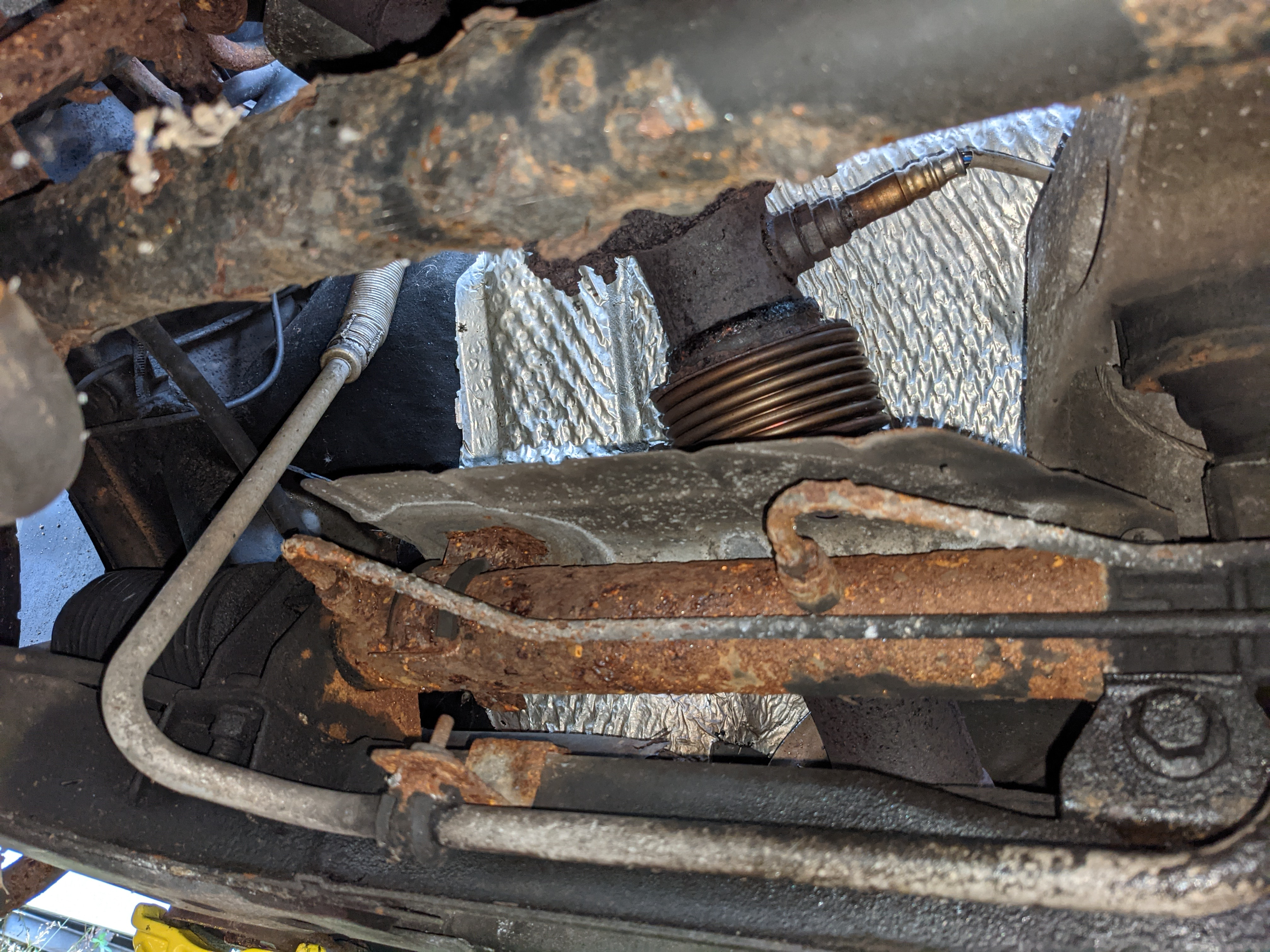

After a third visit to work on Geronimo, I think it might be best to retire the car. Just because it can be rescued might not mean it should be. The owner and I would love your input.
The car appears to have been neglected and poorly repaired for at least the last 11 years and 125k of its 350k miles. It originally lived in Canada and now is in Maine so its accumulated rust is a huge concern. There is severe rust on the steering rack fluid lines, the coolant hard lines behind the engine, and the front right axle. The brake pads are worn very thin from frozen calipers dragging them, so that heat could have hurt the wheel hubs. I could restore the engine, brakes, and suspension, but I fear the next significant failure due to age, mileage, or rust.
Now is the perfect time to retire the car because all the preventative maintenance is due but hasn't been done. It needs all brake calipers / pads / rotors / dust shields / rear fittings / fluid, parking brake cables / shoes, oil change, spark plugs, timing belt, coolant pump and flush, thermostat, accessory belt, PCV, power steering tank and flush, fuel filter, both air filters, headlights, windshield, and snow tires. I will recommend replacing all brake hoses, coolant hoses, poorly repaired transmission hoses, a transmission fluid flush, and airbox flap. I will recommend next year replacing all engine and subframe mounts, and all shocks, springs, sway bar bushings, and rear trailing arm bushings.
All this and I still haven't driven it. I have to replace the entire braking system before it can drive. I have to tow it to my shop for that brake work. Only then can I clean the engine bay to find the leaks and drive it to check the transmission. The initial investment in brakes is the first hurdle.
