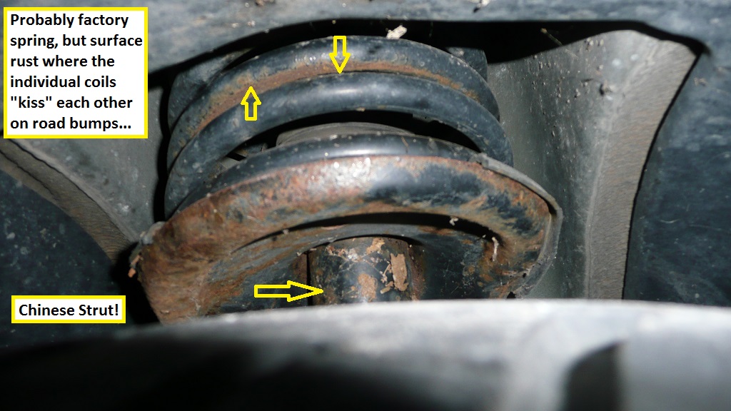

Hi guys,
The P.O. installed some junk Chinese struts from Autozone, needless to say, it is kaput causing the coil springs to rub against itself when hitting potholes. Just surface rust where the spring coils touch each other when compressed.
But I have decided to replace them for peace of mind...

The photo shows Chinese strut.
I assume the springs are from Volvo factory.
Could someone check your car and tell me if it is normal for the spring to develop rust where the individual coils "kiss" each other on road bumps? If so, I might keep these springs bc the S60 springs are known to last some 200K?
If the strut is good, the individual coils won't touch each other.
OTOH, when the strut is kaput, there is no more dampening action, the individual coils are allowed to "kiss" each other?

Not sure why you assume that, do you see Volvo factory paint markings or something else that is not shown in the pic? My first assumption would be that someone installed a quick-strut, with junky springs to match the junky struts. Hence the rust. Similarly assume the spring seats, strut mounts and other hardware are junky until proven otherwise. Is either spring seat broken now?cn90 wrote: 01 Mar 2022, 20:42 The photo shows Chinese strut.
This idea does seem possible but we've never seen or heard of it before in however many forum posts so I'd go with Occam's razor - very unlikely, or unlikely with an actual factory spring at least. Especially given that this car has such very low mileage. As above, a junky spring might make more sense.cn90 wrote: 01 Mar 2022, 20:42 ... If the strut is good, the individual coils won't touch each other.
Are there other signs of sketchy maintenance history where Volvo parts were swapped for imposters? Speaking of coils check the ignition coils - did they change them out for no-name ones?
Also those coils (springs) look unusually close together right now with the car at rest, unless that is just the camera angle.
