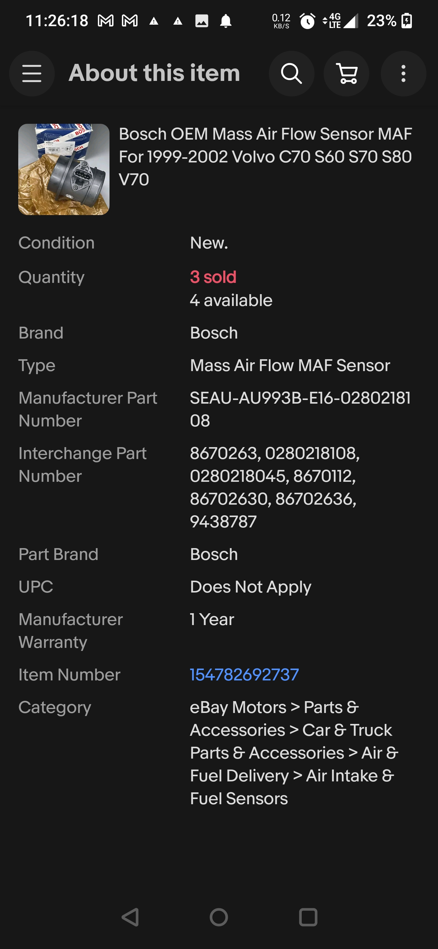

Okay the car has been running fine with the MAF disconnected but I can notice I'm getting worse gas mileage.
Is there a difference with the MAF on a 1998 V70 GLT which is what I have.
And a 1998 V70 r or a V70 t5 which is a MAF that I found on eBay
Can I put the v70r V70 t5 MAF In my V70 GLT

You need Bosch # 0 280 217 107
For pre '99 cars.
'99+ have Denso management.
For pre '99 cars.

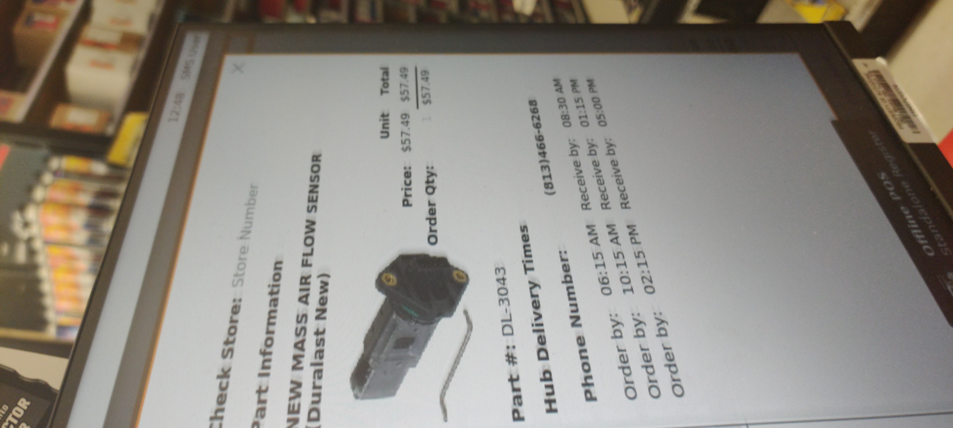

misha wrote: 05 Apr 2022, 09:45 You need Bosch # 0 280 217 107
For pre '99 cars.
Ok cool. Thanks!
May try to clean it with MAF specific cleaner one more time.
I used brake cleaner. (Maybe I messed it up with that? )
Should I try once more with MAF cleaner?

After a brake cleaner it would be toast even if it had a chance to be cleaned with proper cleaner.
Don't waste your time and money in anything that isn't Bosch # 0 280 217 107.
You will be chasing your tail.
Used Bosch one from a junkyard would be better than anything aftermarket when it comes to sensors on these cars.
ECT,O2,Maf,TPS....etc...must be oem.
MAF connector can also be a culprit.
All of them eventually fail at this age.
After a brake cleaner you will need new one anyway...but if problem persists...maf connector is next suspect.
