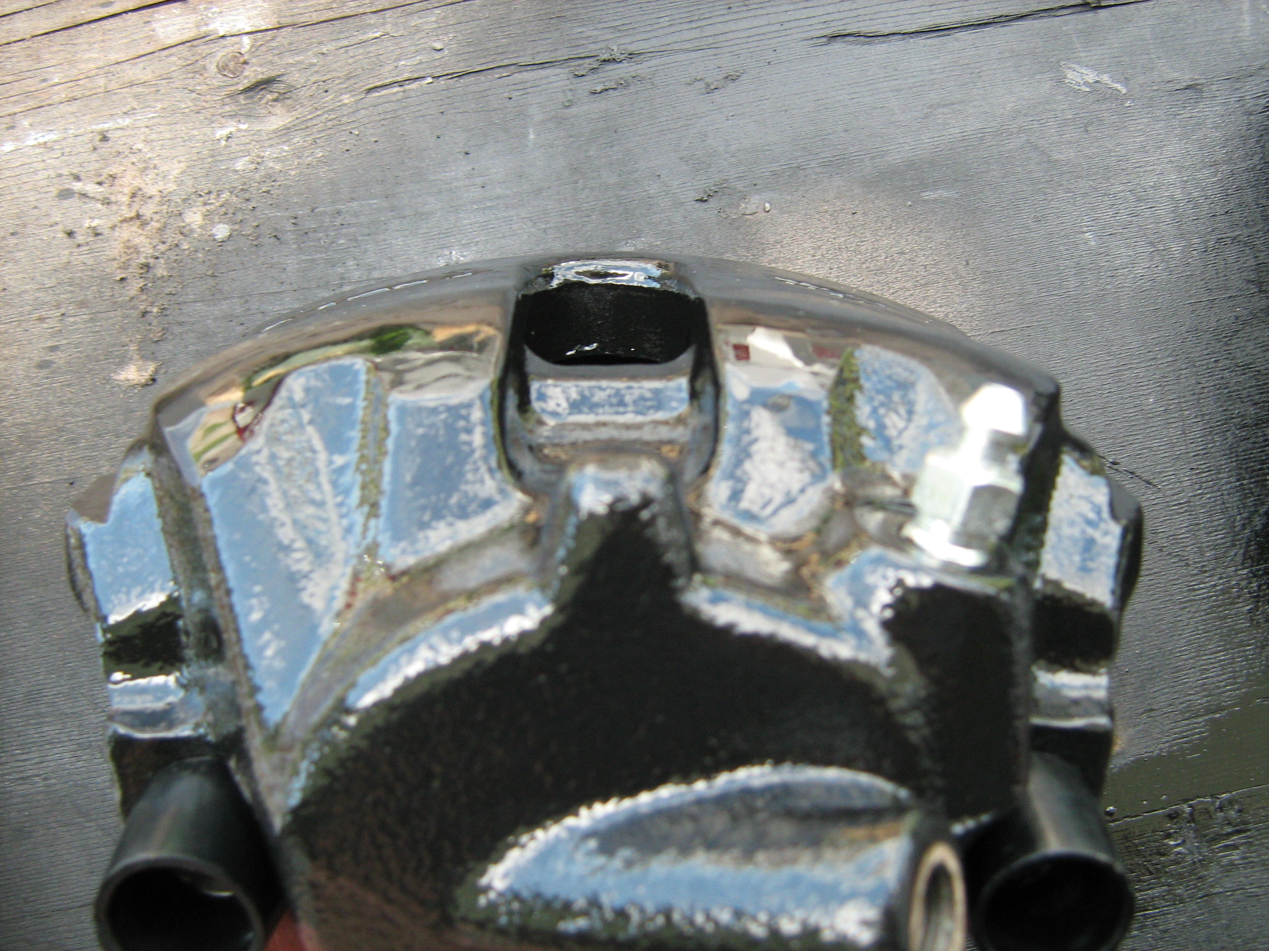

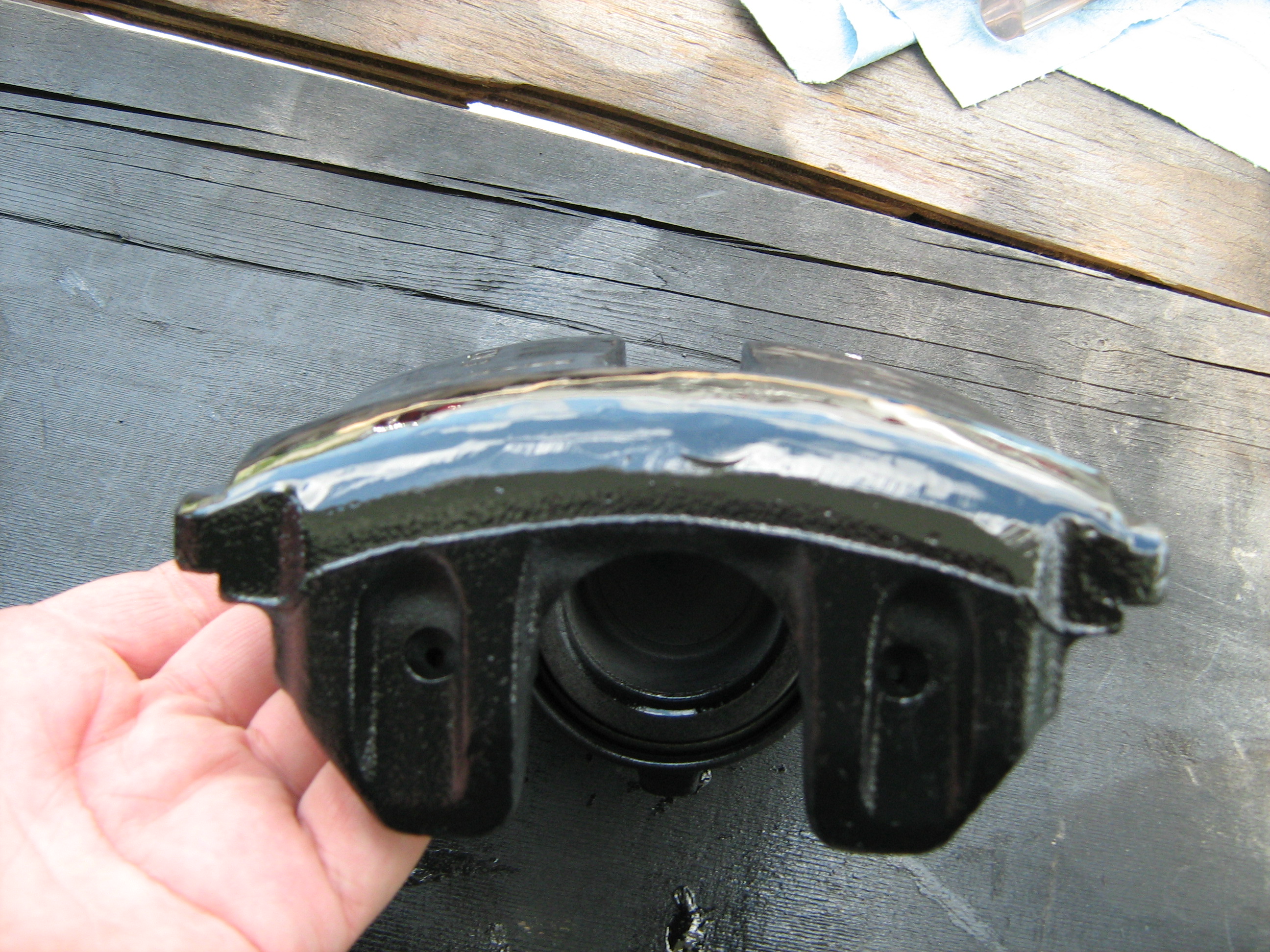

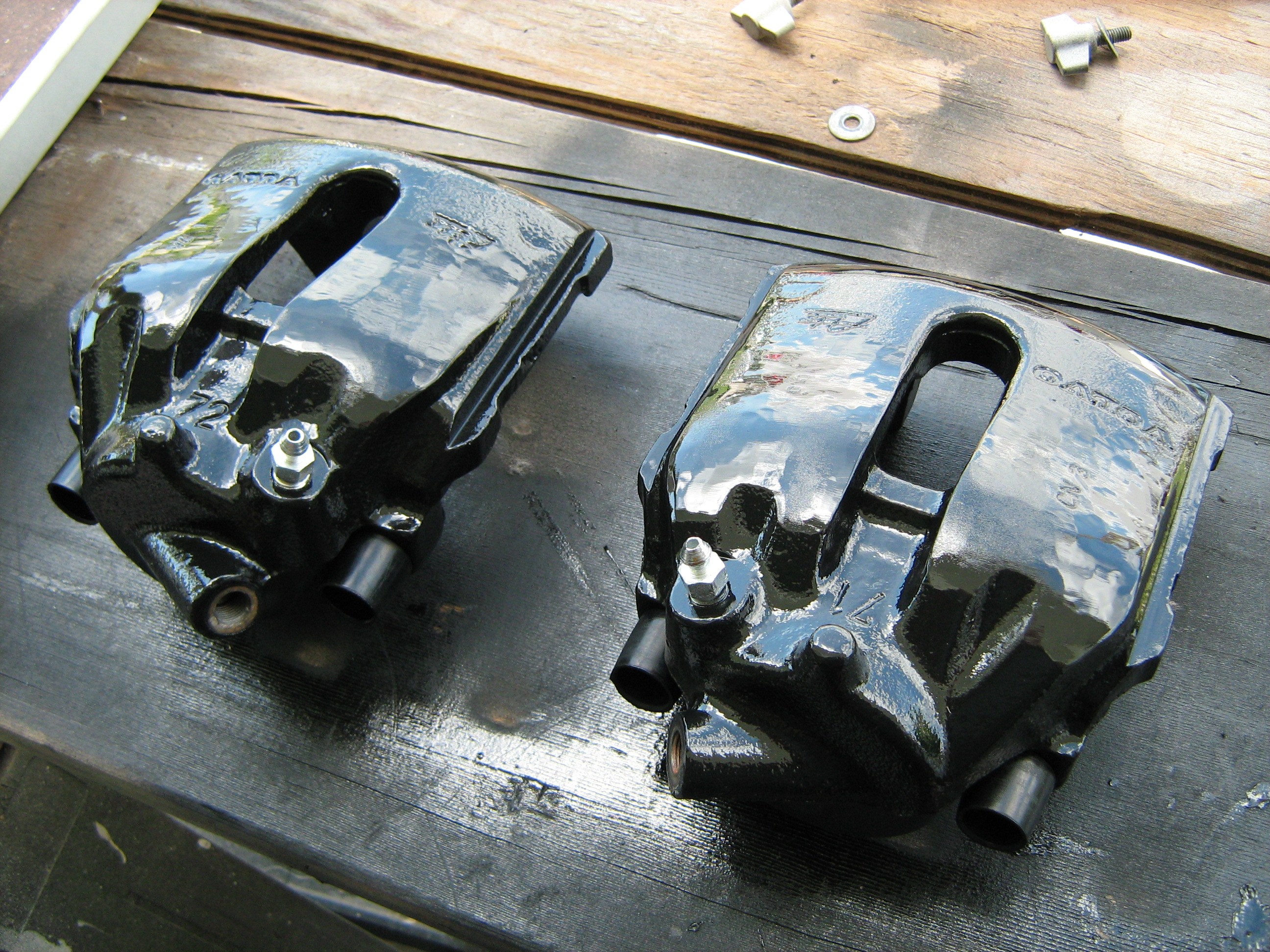

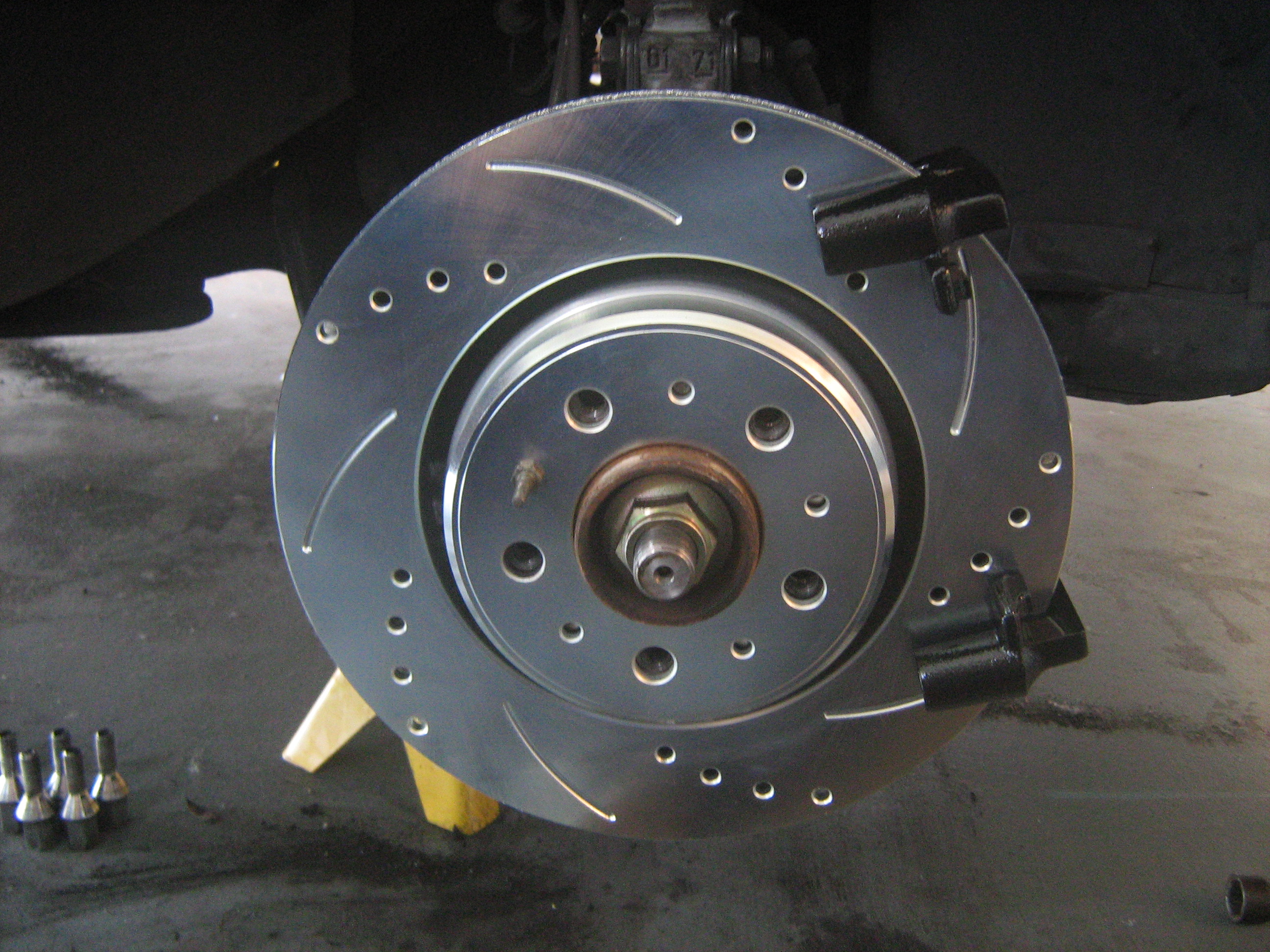

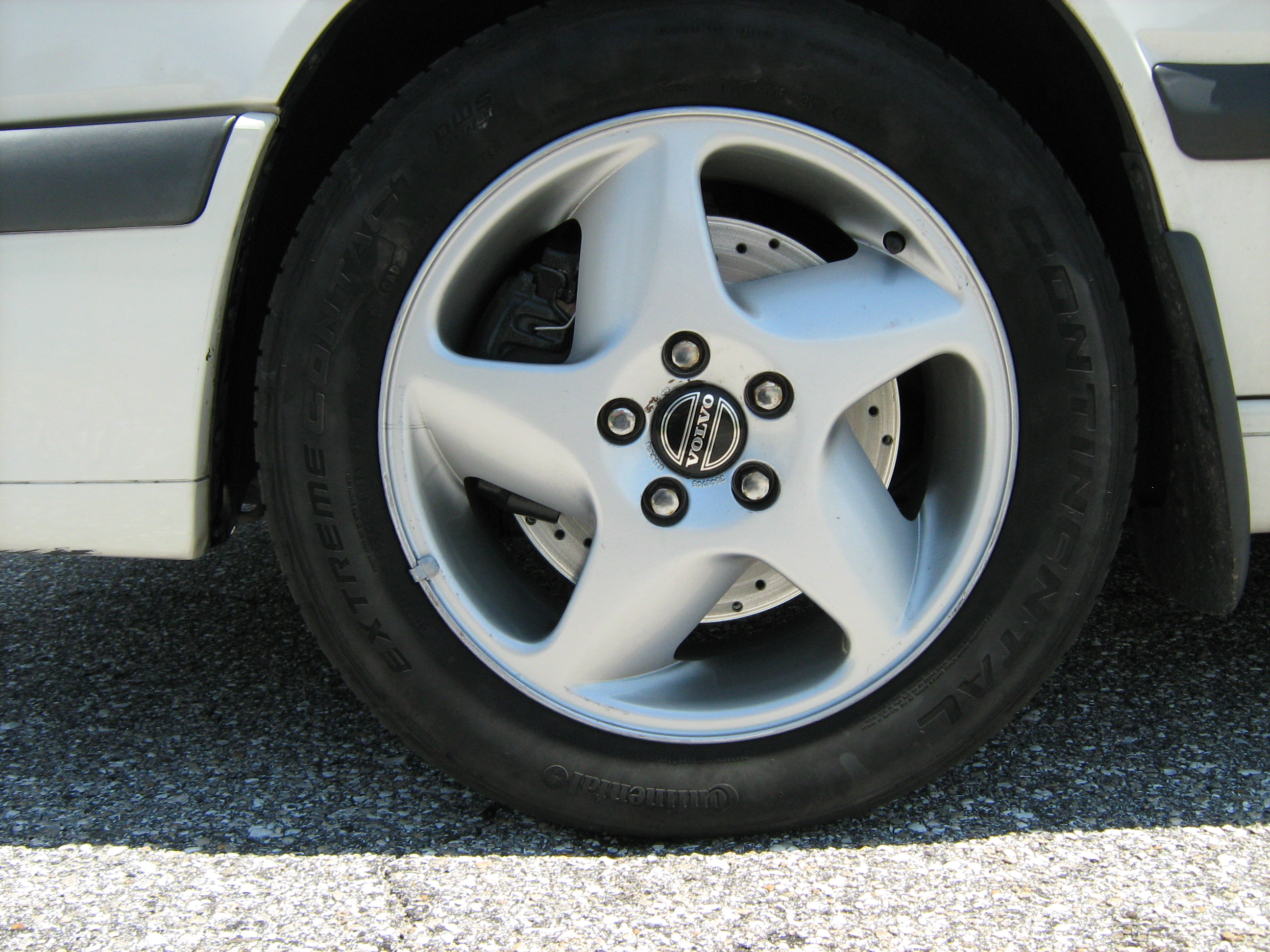

I read somewhere that the Columbas might not fit the discs and calipers on my 99 T5. Someone posted that they were fine if you ground some fins of the calipers.

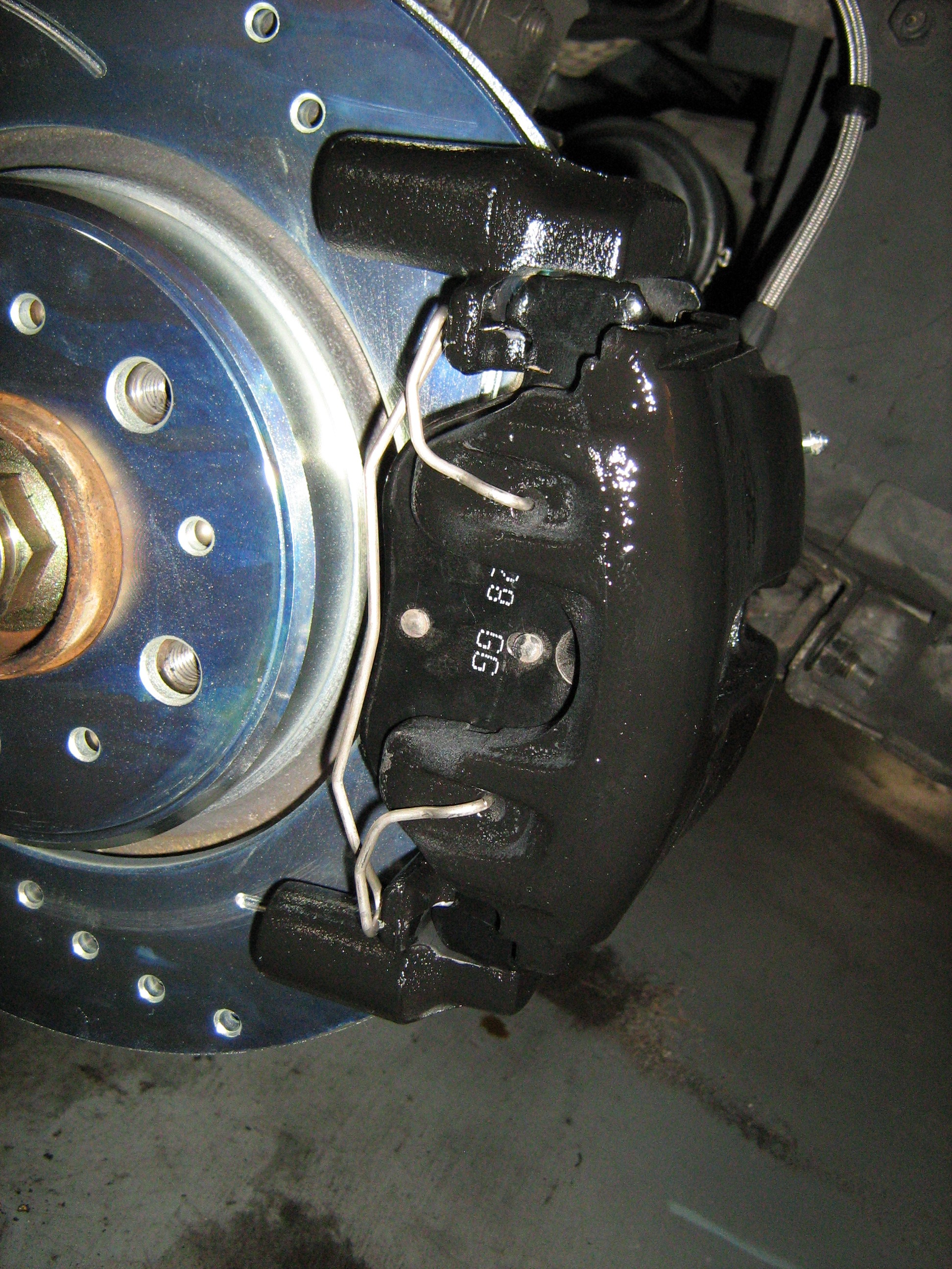

Yeah, that was me. I put an FCP 302mm big brake kit on my Columba-equipped 850 and after I knocked down the ribs on the calipers, the Columbas fit fine.
I did that conversion in 2012 and it's still working today, 70,000 miles later. I can't speak highly enough of the combination of Zimmermann rotors and Akebono pads. I'm not nice to my brakes and those parts WEAR LIKE IRON.

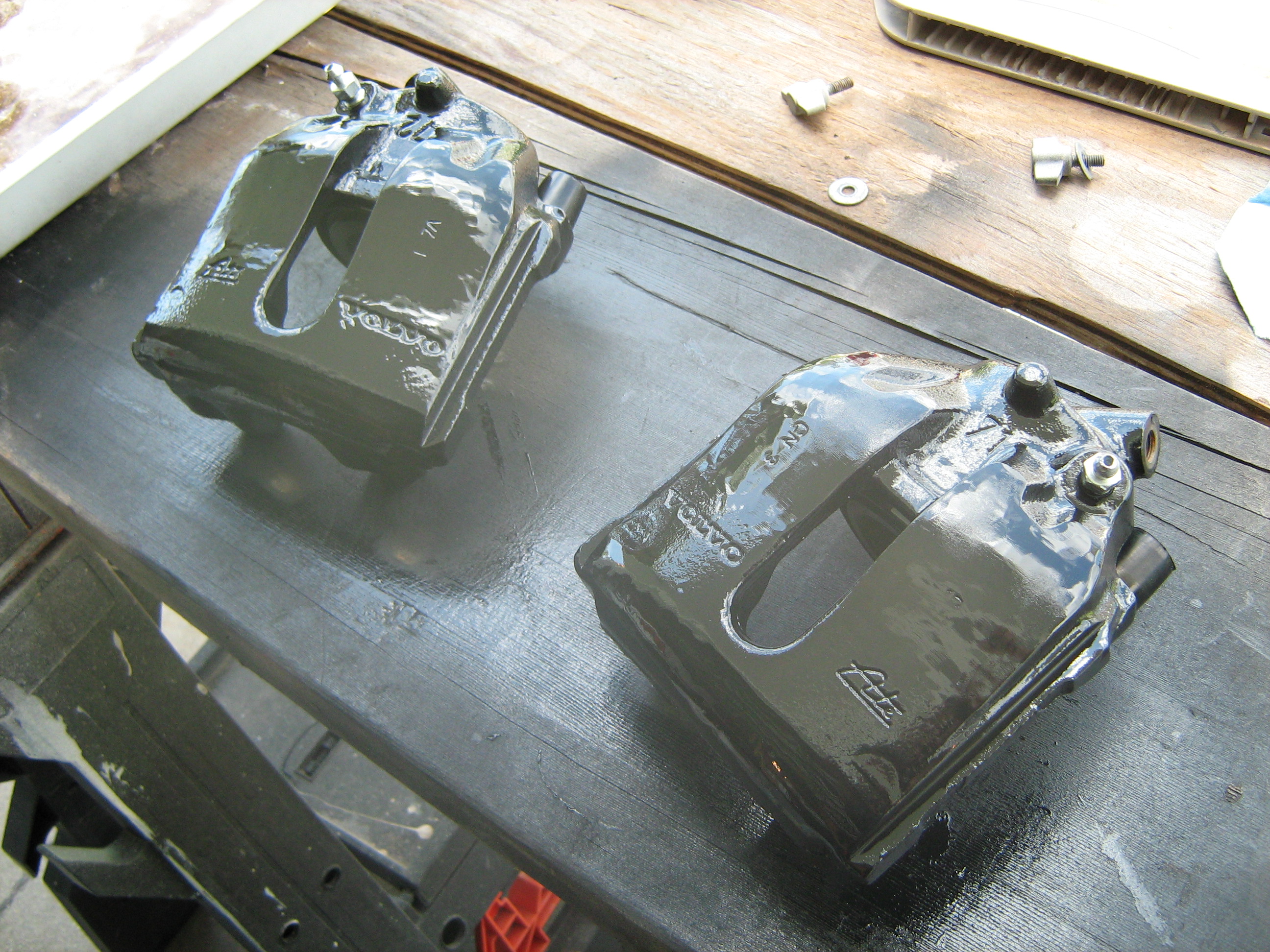

What paint did you use on the calipers? Looks a lot more substantial than the Duplo? caliper paint I get here.

I used VHT engine primer and engine paint. Plus, I stripped the calipers and degreased the hell out of them before I primed them.
Two coats of primer and two of paint.

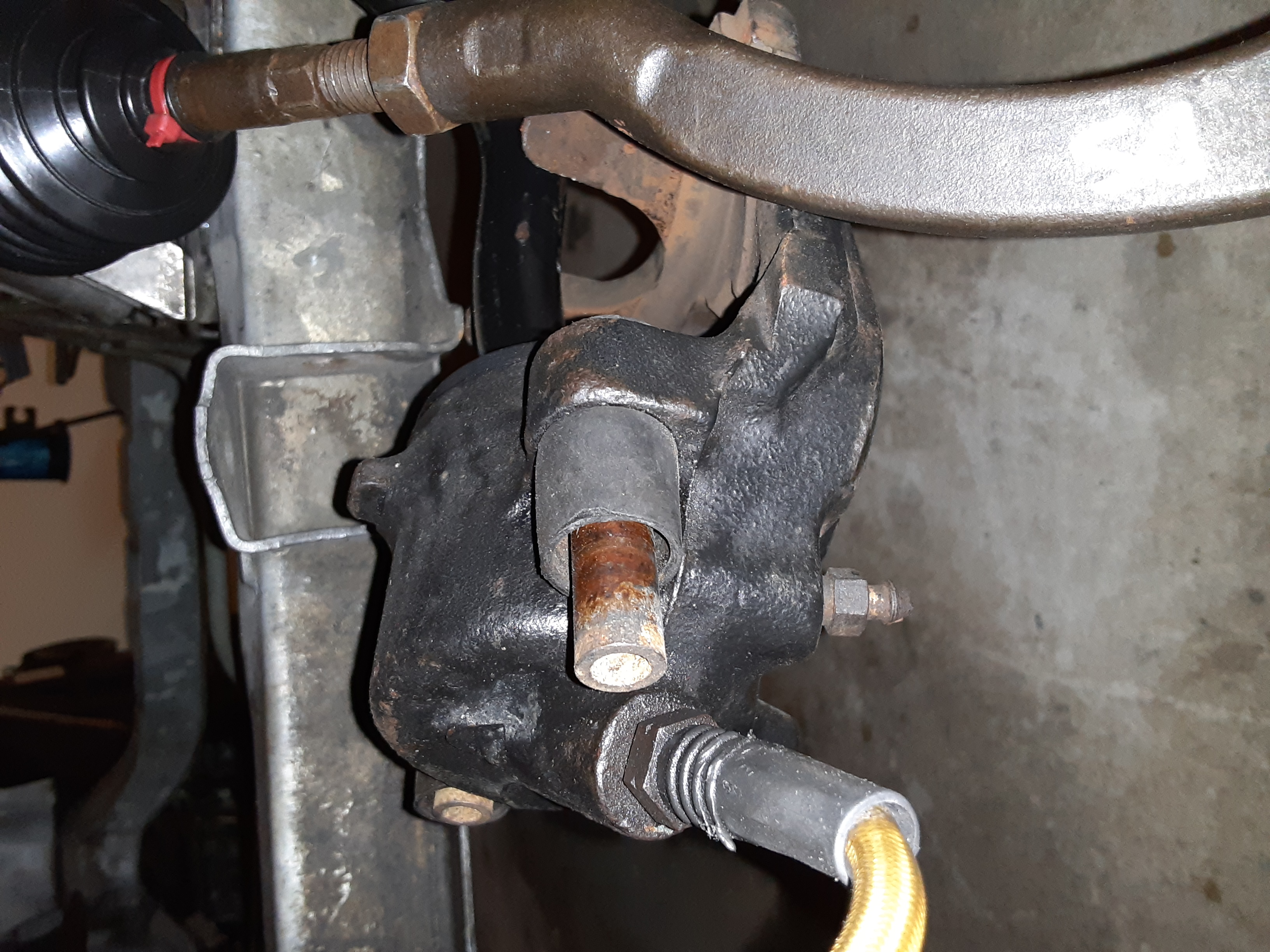

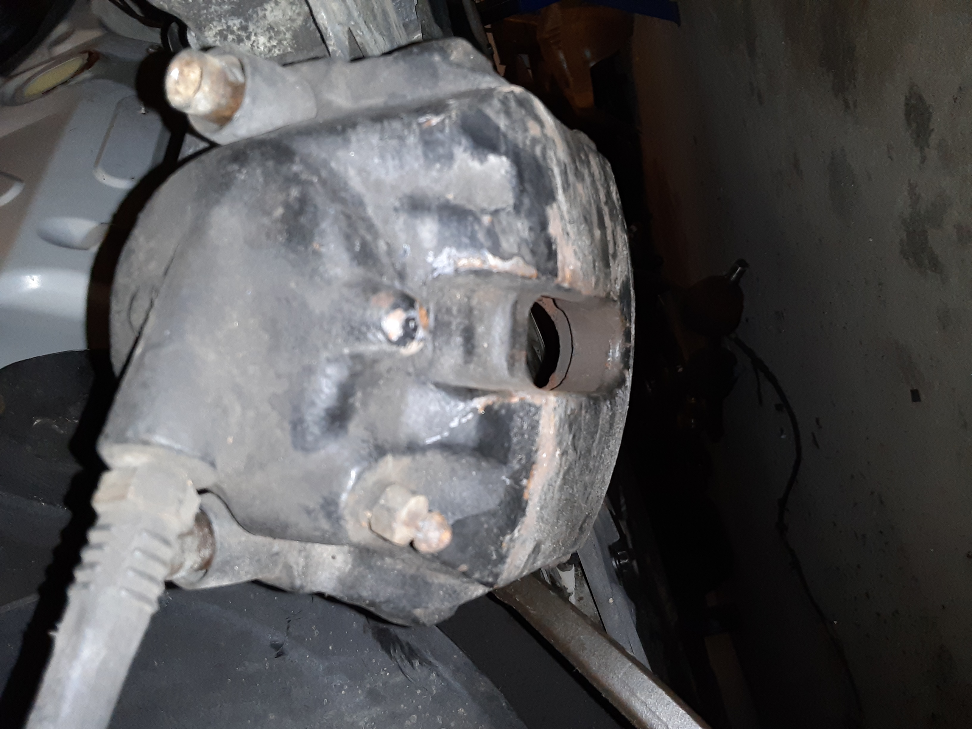

Your winter weather is a lot different to ours, and probably a lot less salt and de-icer on the roads. How has the paint held up so far?

scot850 wrote: 16 Apr 2022, 12:54 Your winter weather is a lot different to ours, and probably a lot less salt and de-icer on the roads. How has the paint held up so far?
Thanks,
I painted the calipers in Florida, which is where they spent about six years. The car's been in Virginia since then. This is what they look like today.
