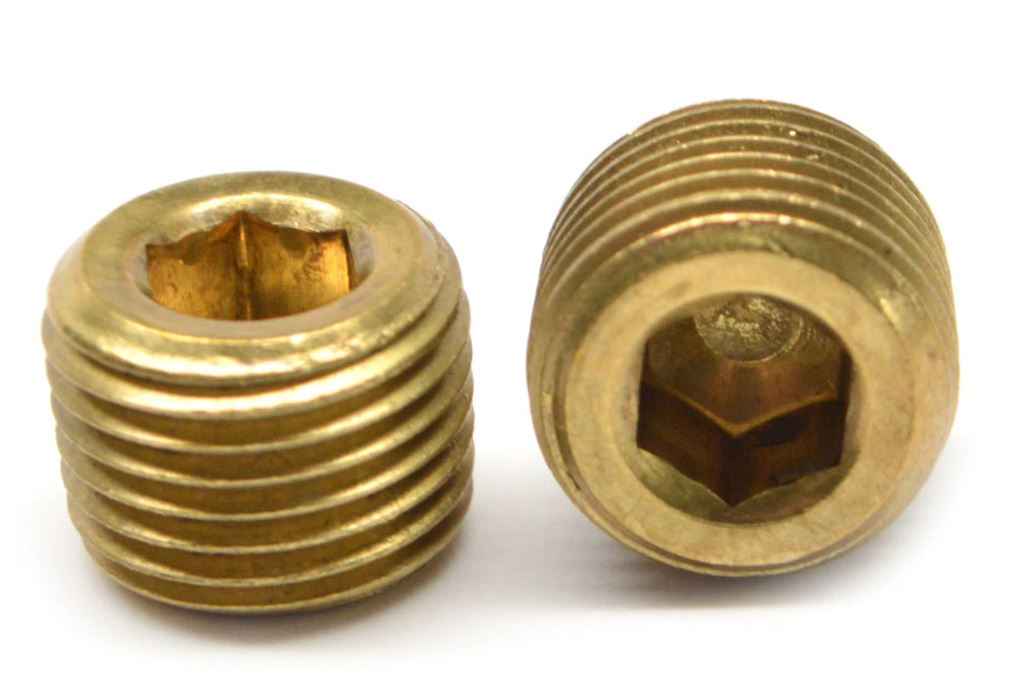

I see from this thread that people are punching holes in the filter via the skewer method. In order to open the filter medium further, what about bending a hook in the end of the skewer, such that it catches on the filter material when being pulled back out? That might rip the filter open further, and possibly even pull some of the plugged filter material out the hole. I'll experiment with this idea tonight. I found a 3/8" NPT pipe tap in my toolbox, and plan to use a pipe plug like the one shown below to seal up the wound.

The transmission has been drilled, tapped, and filter poked. I was unable to pull any filter material out. It feels like a fine metal mesh to me, and by inserting and levering back and forth with a poker, I was able to hear the filter screen tear open. On first puncture, a large quantity of oil gushed out, seeming to confirm a plugged filter screen.
To flush any remaining metal chips out of the transmission, I've repeatedly poured 3 liters of diesel fuel down through the dipstick hole, allowing it to run out the newly drilled hole in the bottom of the transmission. As temps are cold in Canada, the ATF pours too slowly to get good flushing action, which is why I switched to diesel. The catch pan is examined after each flushing, and contaminants filtered out prior to pouring through again.
I plan to do a Gibbons flush immediately on startup, to again try to ensure a clean system prior to trying to drive the vehicle. The filter is due to arrive shortly, and the test drive will need to wait until that time. Fingers are crossed!
