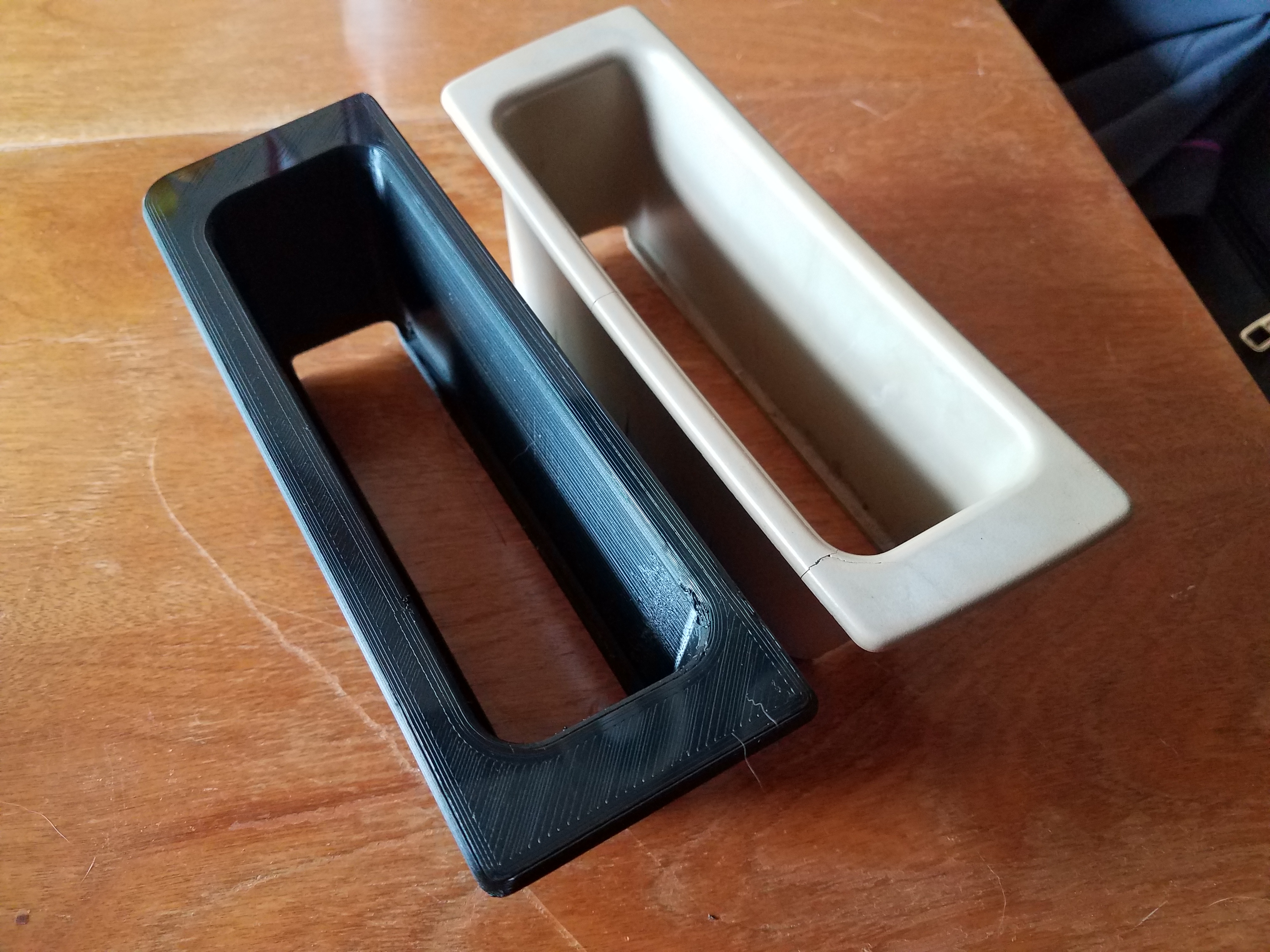

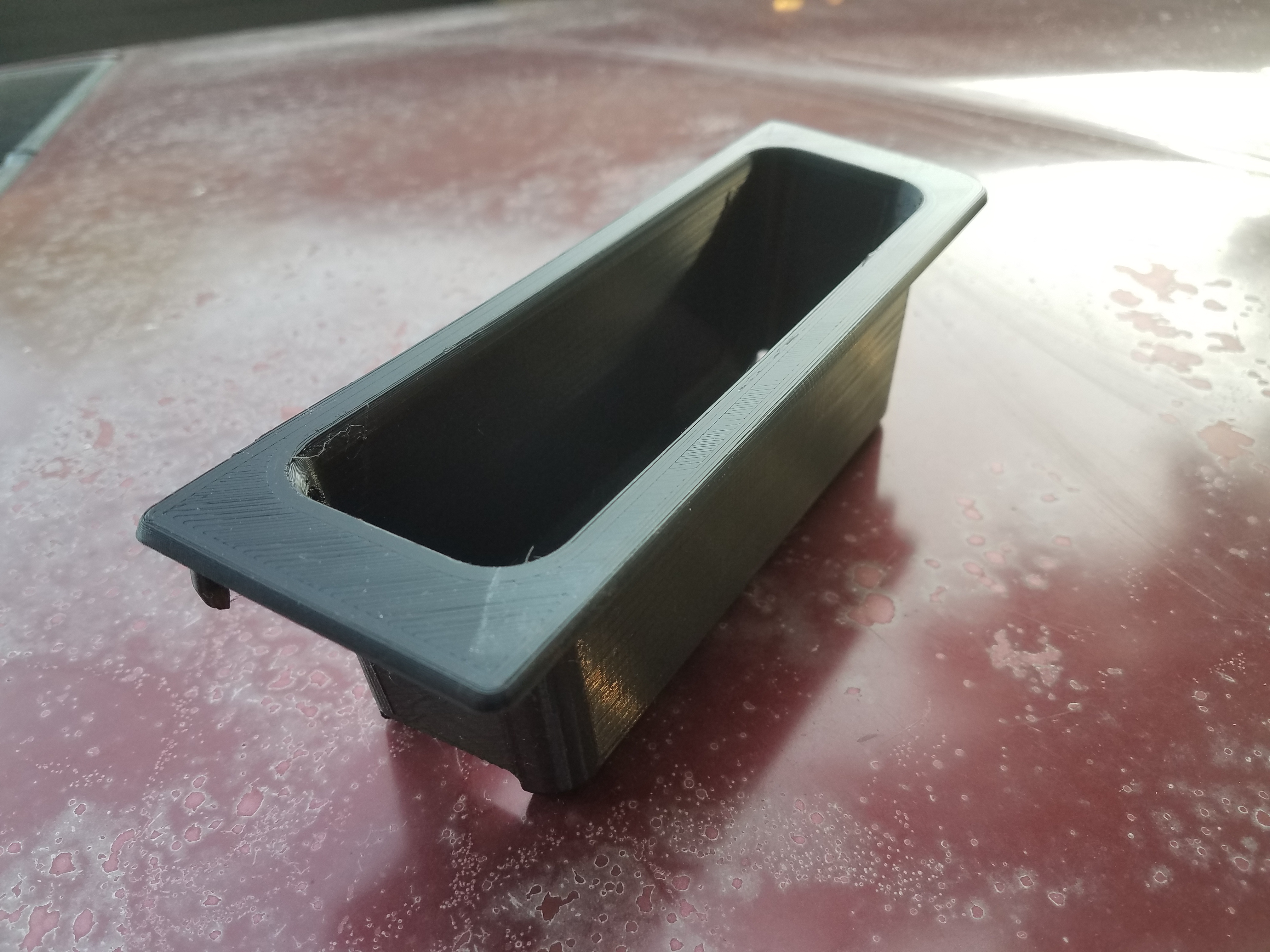

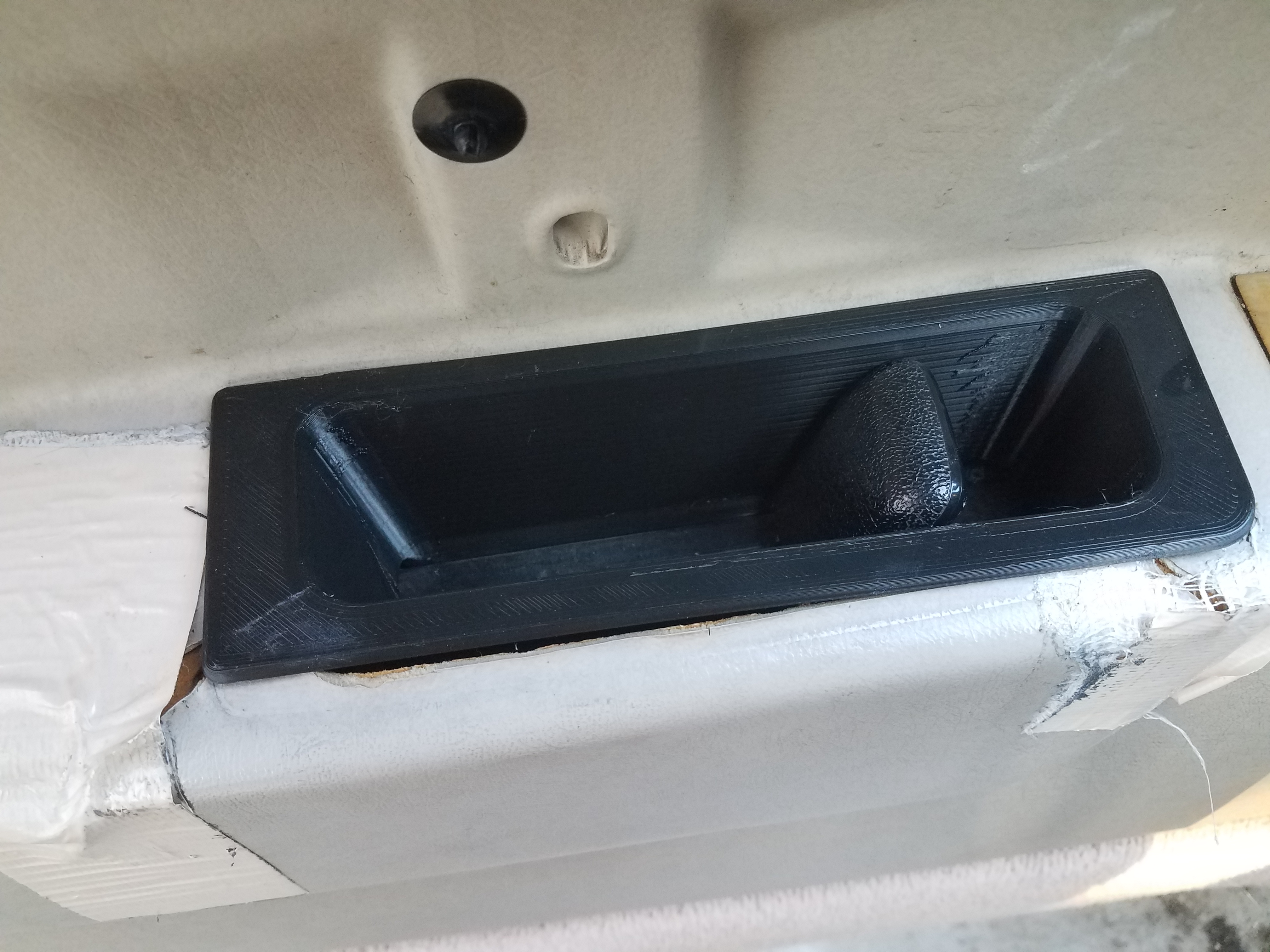

Over the past few days I have been working on making a 3d printed door trim piece. Specifically the piece that surrounds the inner door handle. I wanted to start with something simple to learn from it and hopefully start designing more of the complex parts. For now I am prototyping using PLA in black since I have it lying around. The final piece will be printed in a color that best matches the tan interior.
Today was my 4th iteration of the design and finally produced a piece that fits quite well.
Please excuse the duck taped panel. She survived a tornado so she gets a pass.

Nicely done! 3D printing fascinates me... I love that we have the ability to reproduce these sorts of parts now. Maybe the material will be better and last longer than the old Volvo plastic!

That is the goal! I'm thinking the final part should be made of ABS or PETG. I've only worked with ABS but both are supposed to have high heat tolerance which is a necessity here in Texas.

It's not so much heat and cold tolerance that's the issue. The plastic needs to withstand extreme temperature changes. On top of that, the plastic HAS to be UV stable, which is expensive and hard to do.
Nice work on the trim piece. I really think 3D printing is the future for reproducing old car parts.

In my research I came across ASA filament which is like ABS but much more UV resistant and intended for outdoor use. It's a bit more expensive but not much. It's like $10 more per roll than ABS. The real challenge is finding good colors.

That 3d printed part looks good :wink:
