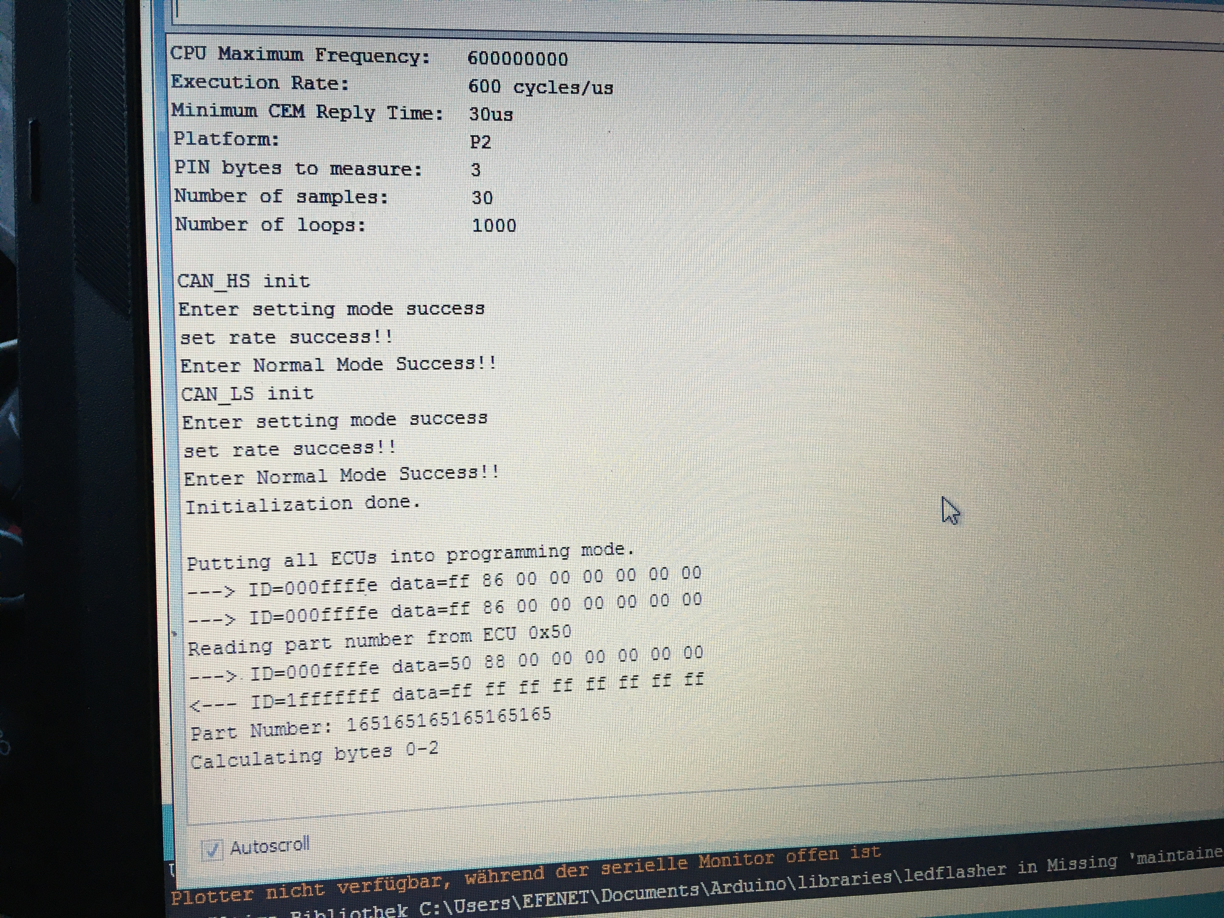

>>> more is not possible >>>
why does the program not continue 😖

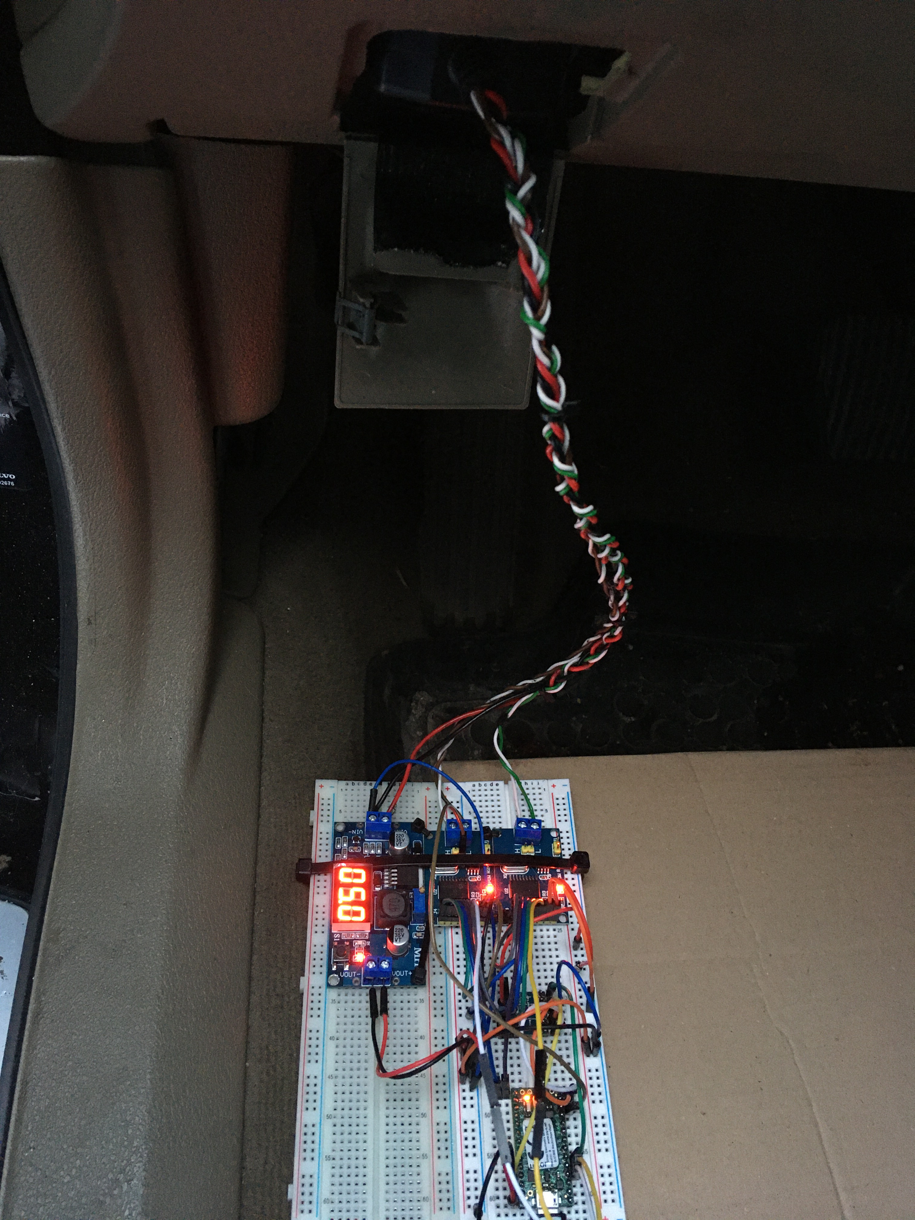

Post by vtl »
You have no jumpers on J1, the end of bus is not terminated, lots of signal reflections.

Post by efe09 »
Should I set a jumper on both CAN bus shields
put a jumper on J1?
Can you please help me out,
I do not have so much experience with it,
but I would like to complete this project successfully.

Post by vtl »
On both shields.
