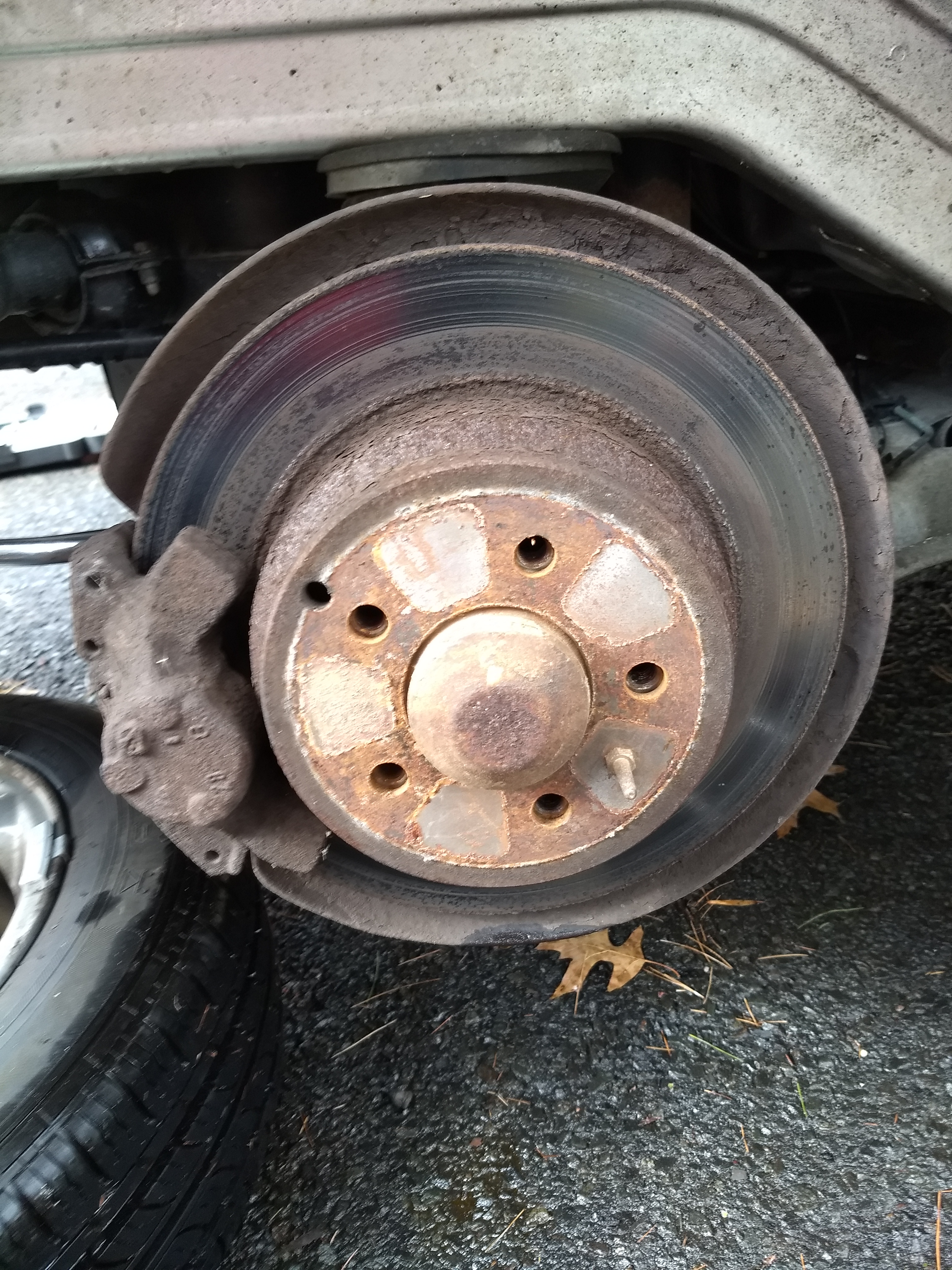

I picked up a silver MT 2000 V70 last week for cheap, and started with the rear brakes / parking brake. Things were pretty rusty back there, but everything went off without a hitch! Need to readjust the parking brake after a short test drive, but otherwise a marked improvement.

Heard about this one from the Marcomm department, Bruno. Watch those rear rotors to see if the get shiny as you drive it to make sure those calipers are free.
Next time you order parts , add some bleeder screws to the order and replace them all, after you push 500 ml of fluid through each one of course.
