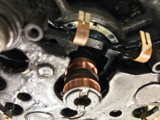

A few pics:
Alternator shaft
Alternator shaft
Alternator shaft different view
Voltage regulator and brushes
Stay tuned for short video of the car running!

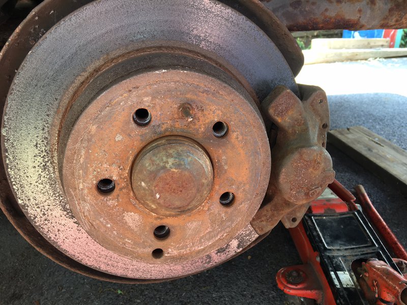

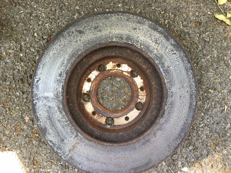

drum
drum
back of rotor
back of rotor
front of rotor
front of rotor
No major nicks or gouges, just surface rust and spots where the rotors/pads sat!

Posts: 35301
Has thanked: 1505 times
Been thanked: 3818 times
Try polishing those with some coarse sandpaper and then test brake action. I think you will be ok after a few hundred miles of hilly driving. If I'm driving by soon I'll bring my 3/4 bar and BFWG

abscate wrote:Try polishing those with some coarse sandpaper and then test brake action. I think you will be ok after a few hundred miles of hilly driving. If I'm driving by soon I'll bring my 3/4 bar and BFWG
+1 coarse sand paper is your friend, don't be afraid about 'scratching the surface, give some love to those pads too. Same for the brake shoes friction surface.
