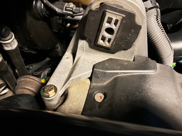

xHeart wrote: 27 Jan 2023, 12:29 The two M10x1.5 bolts on the engine stabilizer mount, locations as shown in the pix, won't take the the 50Nm torque. Is it a helicoil or time-sert repair; long bolts where the threads are deep below the surface?

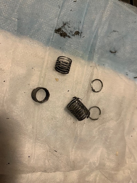

Winter storm in the forecast offered idle time to look further into the stabilizer mount's failing fasteners. Pieces of helicoil came out with the two of the four M10x1.5; these are from the 70mm. Is it normal to find these pieces?

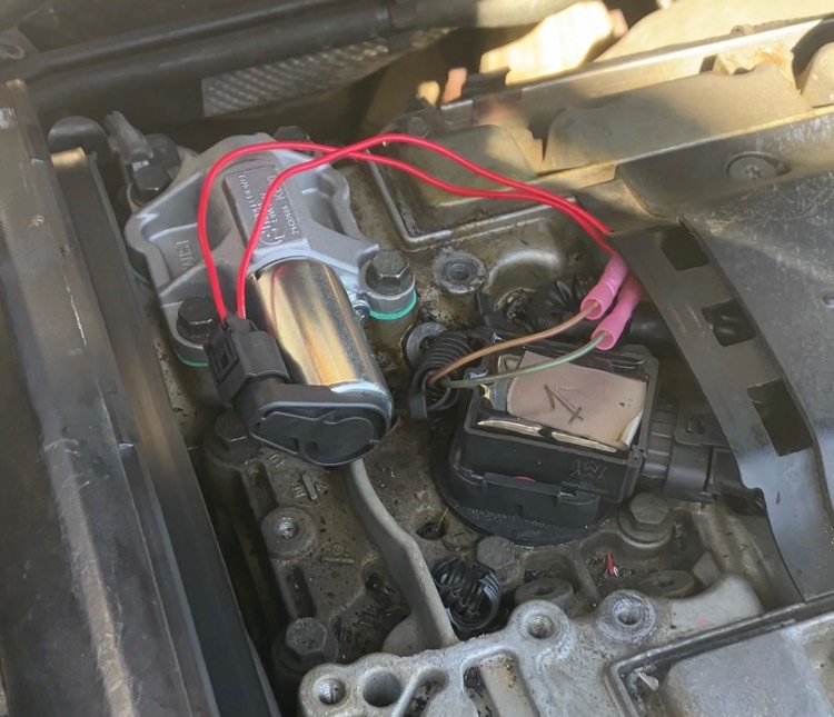

Swapped in a new CVVT solenoid on my 01' S60 T5

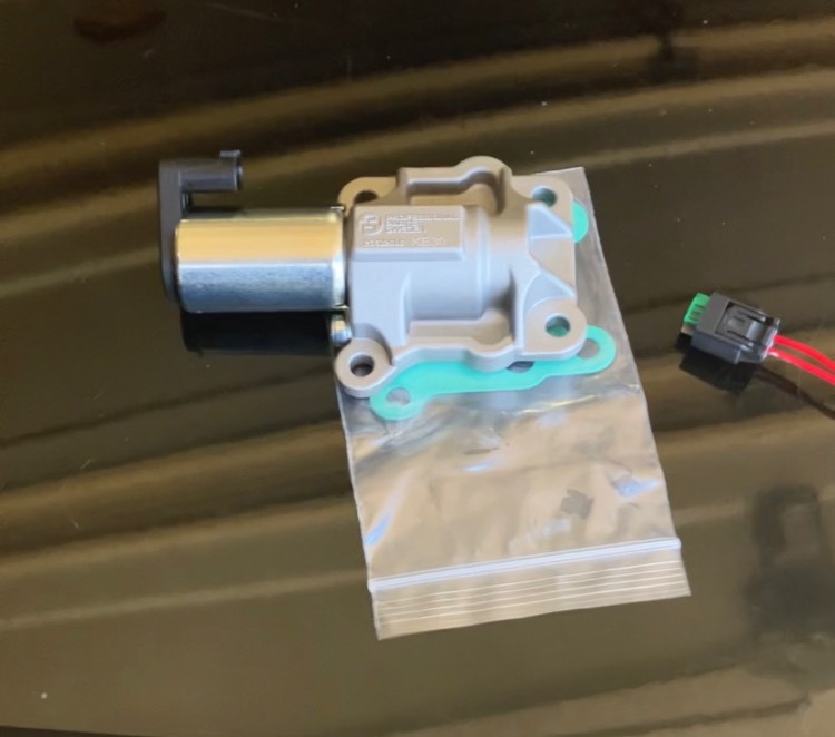

Pics
CVVT Solenoid
CVVT Solenoid
Must be re-wired to work
For now, removed and replaced one M10 x 1.5 x 70mm with 5/16" x 16 x 3.5"; long enough to put a serrated flange nut to hold the mount till I have a time-sert fix in place.
