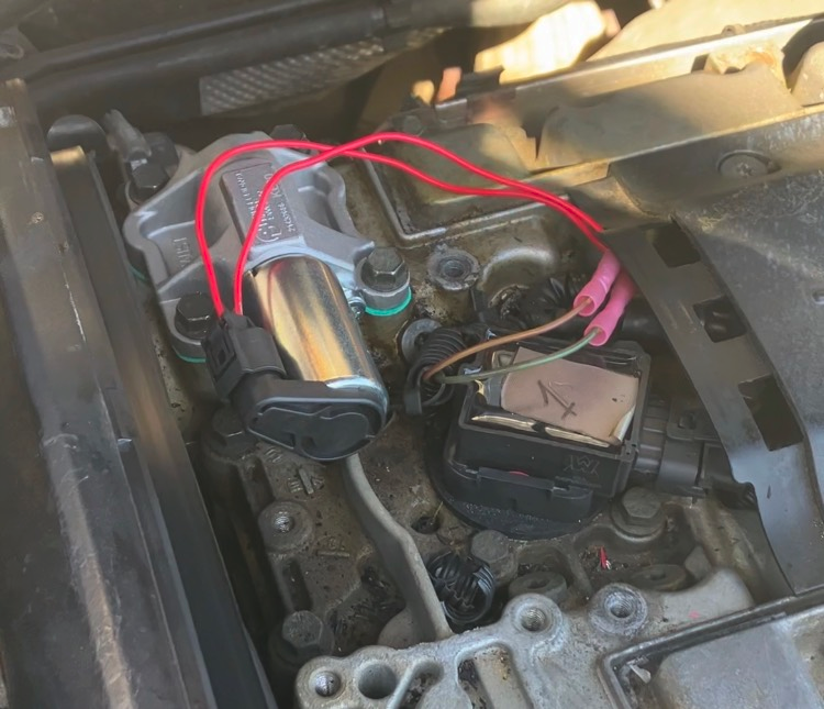

MooseGangJP wrote: 05 Mar 2023, 17:44 Pics
01 S60 Solenoid.png (1020.46 KiB) Viewed 593 times

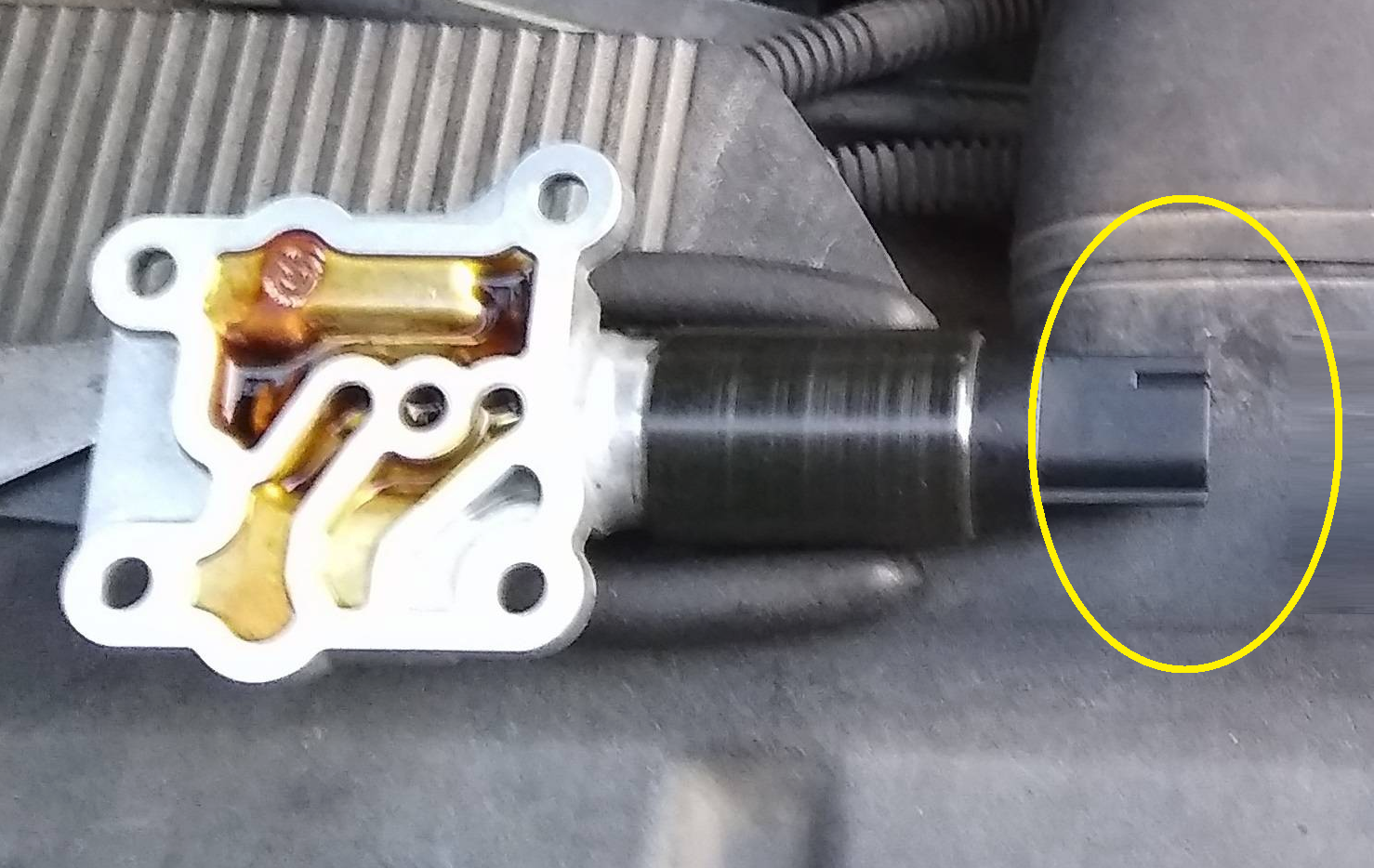

Was your original solenoid with a straight connector like mine so you had to splice the wire? I was considering replacing mine with the side connector as the straight connector solenoids are hard to come by and more expensive. The gasket and body looks the same and could interchange as the function of the solenoid should be generic.
Posts: 36175
Joined: 17 Feb 2013, 17:54
Has thanked: 1614 times
Been thanked: 4078 times
Ugh. Those proParts Sweden solenoids aren’t known for their friendliness

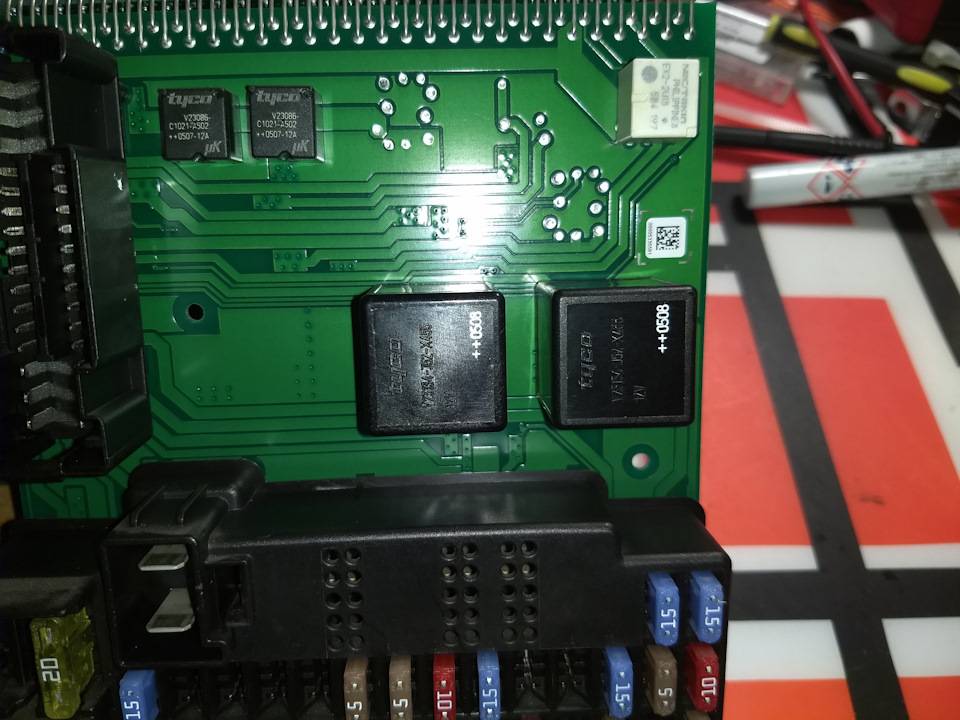

Replacing relays is pain in L-shaped CEMs. It is hard to take these CEMs out, it is hard to disassemble them, it is hard to desolder a broken relay (need a soldering station with hot air). Volvo Cars made sure you better pay $1600 for a new CEM (or, better, spend 1/2 of new car price in two years leasing it out), unless you're stubborn and dedicated to break that ill "buy new" economy by fixing the CEM for $7.99.

vtl wrote: 07 Mar 2023, 06:57 It is hard to take these CEMs out, it is hard to disassemble them, it is hard to desolder a broken relay (need a soldering station with hot air). Volvo Cars made sure you better pay $1600 for a new CEM (or, better, spend 1/2 of new car price in two years leasing it out), unless you're stubborn and dedicated to break that ill "buy new" economy by fixing the CEM for $7.99.
Are there any photos of how this looks?

Post by vtl »
BlackBart wrote: 07 Mar 2023, 07:12 Are there any photos of how this looks?
Of course! I was chasing a "no power to BCM". Last photo is what explaining those $1600 in Volvo Cars cocaine dreams.

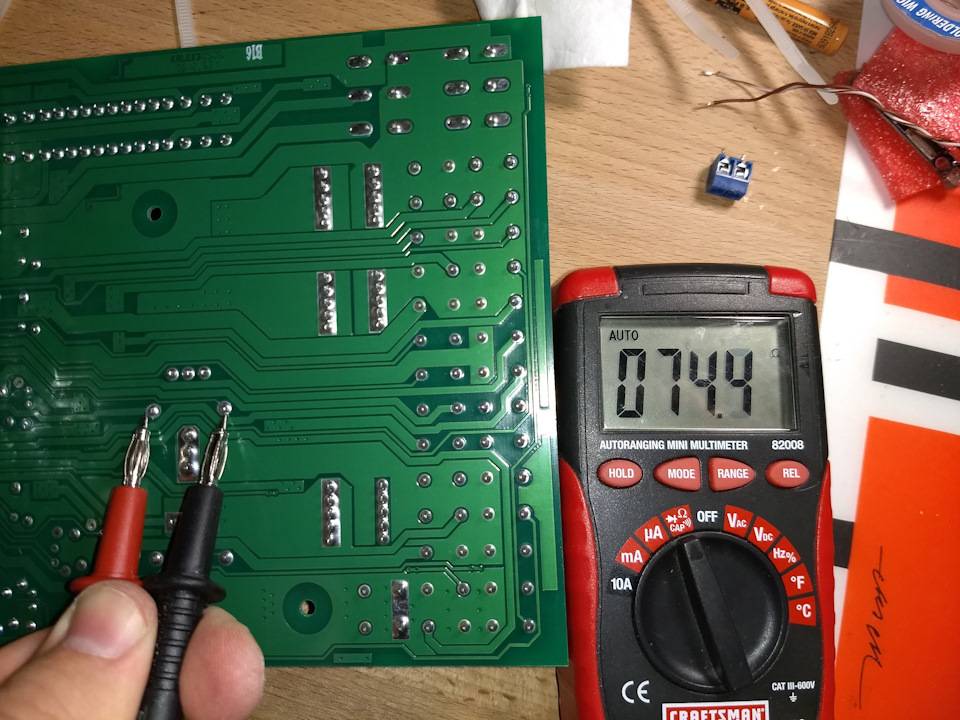

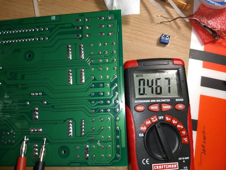

Post by XC70Rider »
I had to replace the same relay on the REM. I got zero resistance on the coil. This was causing ANTI SKID to be out service because the REM communicates to the DEM. I purchased the AZ980-1A-12DE relay from www.digikey.com.

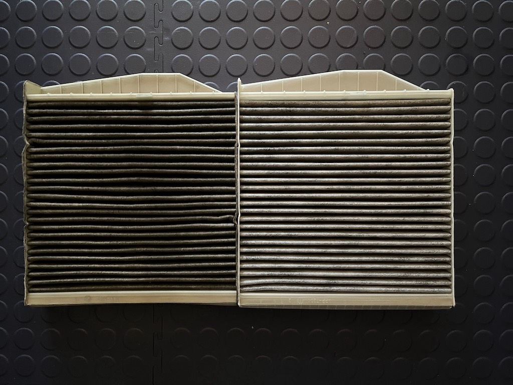

P80GLT wrote: 09 Mar 2023, 06:36 Changed the cabin filter, I think the old one had been in there since the car was built
You have a better choice in Europe: Mahle LAO54, with antimicrobial layer. We've had it in US for some time, too, but I can't find it anymore. Even had the same LAO series filters in my big Toyotas, no longer sold as well.
