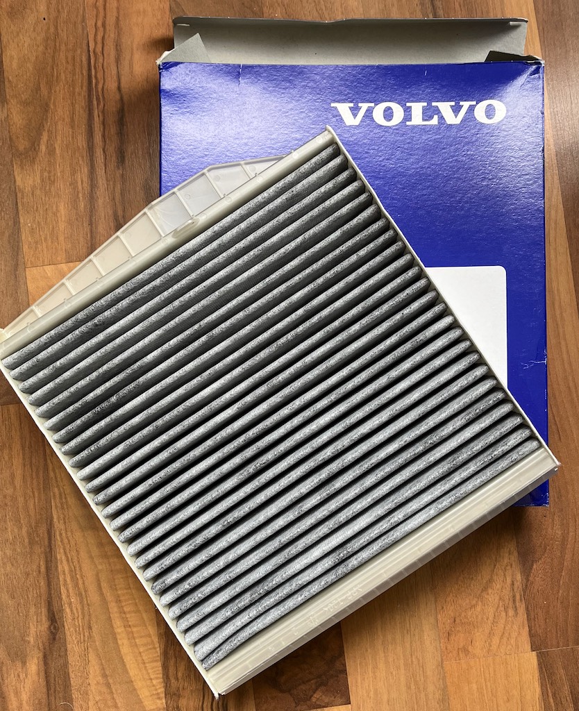

vtl wrote: 09 Mar 2023, 06:48 You have a better choice in Europe: Mahle LAO54, with antimicrobial layer. We've had it in US for some time, too, but I can't find it anymore. Even had the same LAO series filters in my big Toyotas, no longer sold as well.
The new filter is a genuine Volvo filter that had the same part number as was in there. I know there are also charcoal filters available but not sure if they would fit into the housing

P80GLT wrote: 09 Mar 2023, 07:57 The new filter is a genuine Volvo filter that had the same part number as was in there. I know there are also charcoal filters available but not sure if they would fit into the housing
Your filter is charcoal. But there's an even better filter. They all fit: pollen, charcoal, antimicrobial...

Do you guys find the charcoal filters to be too restrictive?

ZionXIX wrote: 09 Mar 2023, 21:25 Do you guys find the charcoal filters to be too restrictive?
My lungs don't find anything bad in a better filter. Cabin blower I can always replace when it dies.

I just don't have hardly any airflow with charcoal filters. I need as much as possible in the texas summers.

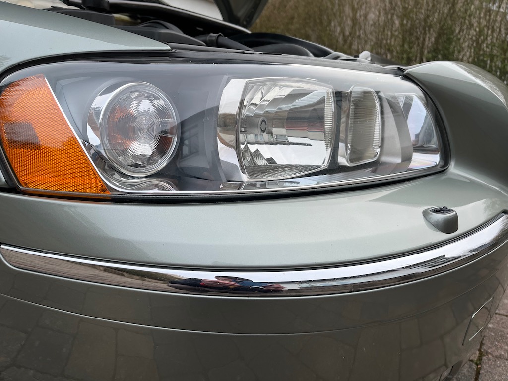

Turned my DRLs off with Vida, why did Volvo not keep the 850 system where you could press a tiny button on the headlamp switch to alternate between on and off, finding it in Vida for the V70 was a PITA.

I think you’re just looking for any excuse to post pictures of that beautiful car! How many miles on it? It looks brand new, I’m super jealous.
