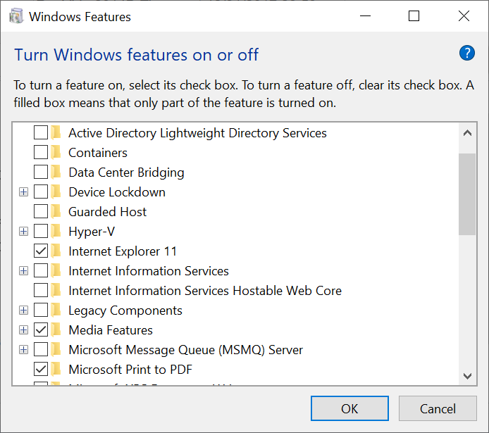

The hyperlinks are dead. Go to page 16 and use the Magnet link as instructed.
No need for all that.bronco wrote: 10 Jun 2020, 07:53 I have a windows 7 machine which I believe has IE11 on it in storage even if I dont get the date patched I should be able to adjust the date back a decade if need be
Get the Repack and install it in Windows 10 as instructed on page 6. IE11 is still there in windows 10. You might need to activate it in Programs and features. The 2099 patch is on page 1.
