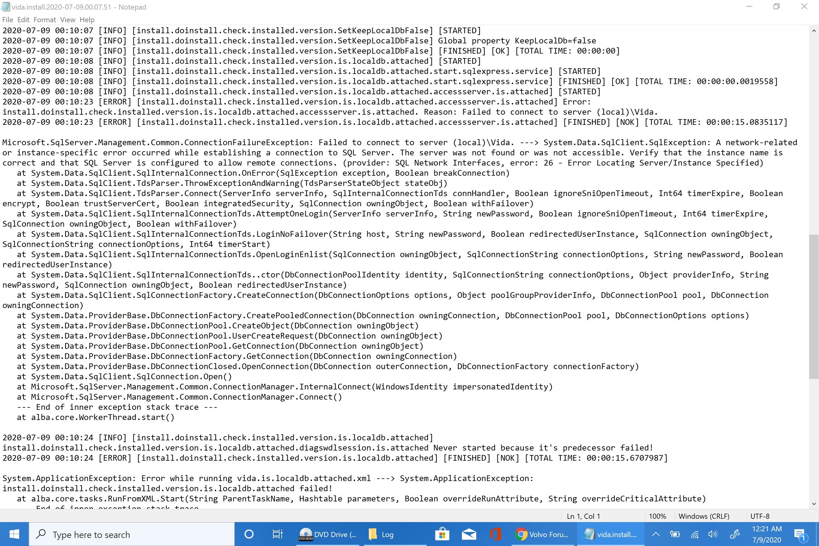

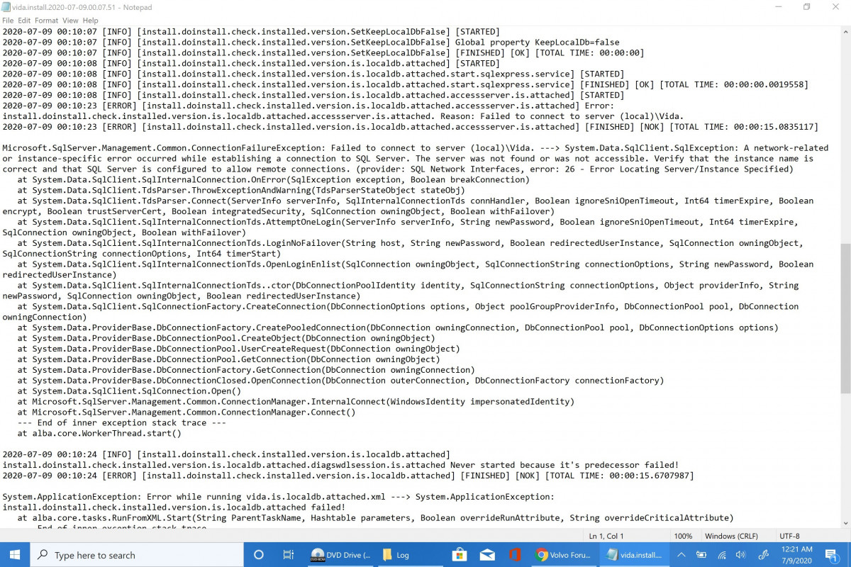

Having some trouble with the repack on my Surface running Win10 Home.
When I run script 2, I get a VIDA NOT OK message at the end of the install. The log indicates
Error: install.doinstall.check.installed.version.is.localdb.attached.accessserver.is.attached. Reason: Failed to connect to server (local)\Vida.
Microsoft.SqlServer.Management.Common.ConnectionFailureException: Failed to connect to server (local)\Vida. ---> System.Data.SqlClient.SqlException: A network-related or instance-specific error occurred while establishing a connection to SQL Server. The server was not found or was not accessible. Verify that the instance name is correct and that SQL Server is configured to allow remote connections. (provider: SQL Network Interfaces, error: 26 - Error Locating Server/Instance Specified)
I have IE11 installed, and before this I ran script 1 as admin. Any ideas?

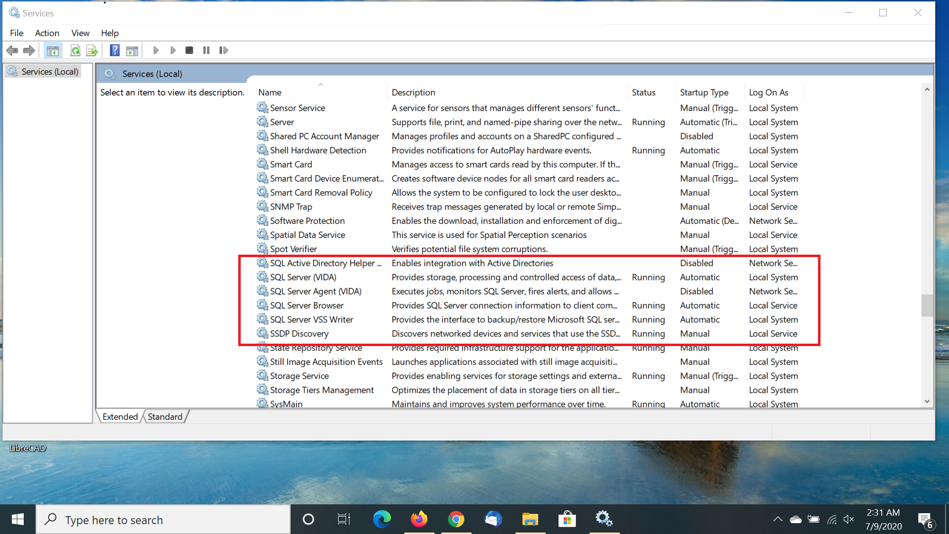

Kara503 wrote: 09 Jul 2020, 01:22 (provider: SQL Network Interfaces, error: 26 - Error Locating Server/Instance Specified)
Check services.

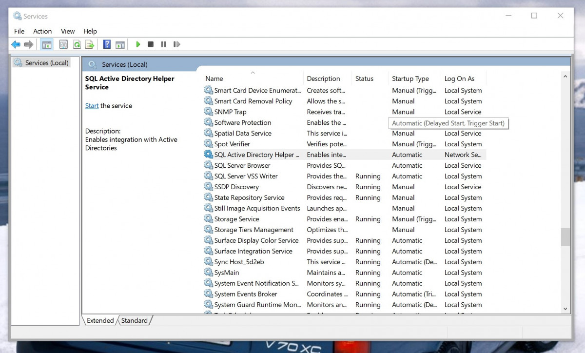

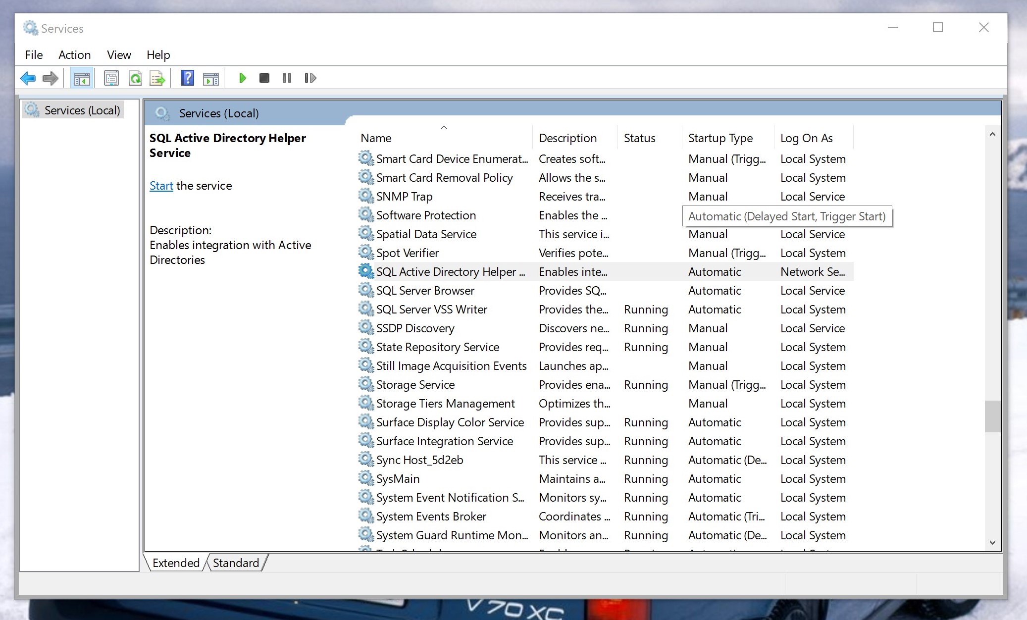

Check services.
Not getting everything you have. Wondering if something in the SQL install pack failed. I can get The server browser to start from this window, but the Active directory helper fails to start no matter what. I've tried re running the SQL part of the re pack quite a few times.

Something wrong with your SQL server install or your security settings.

RickHaleParker wrote: 09 Jul 2020, 16:47 Something wrong with your SQL server install or your security settings.
Got it figured out, some files were getting missed during the SQL uninstall/ reinstall. Deleted those, installed SQL again, finished everything and now using VIDA on my sisters S40! Thanks.
