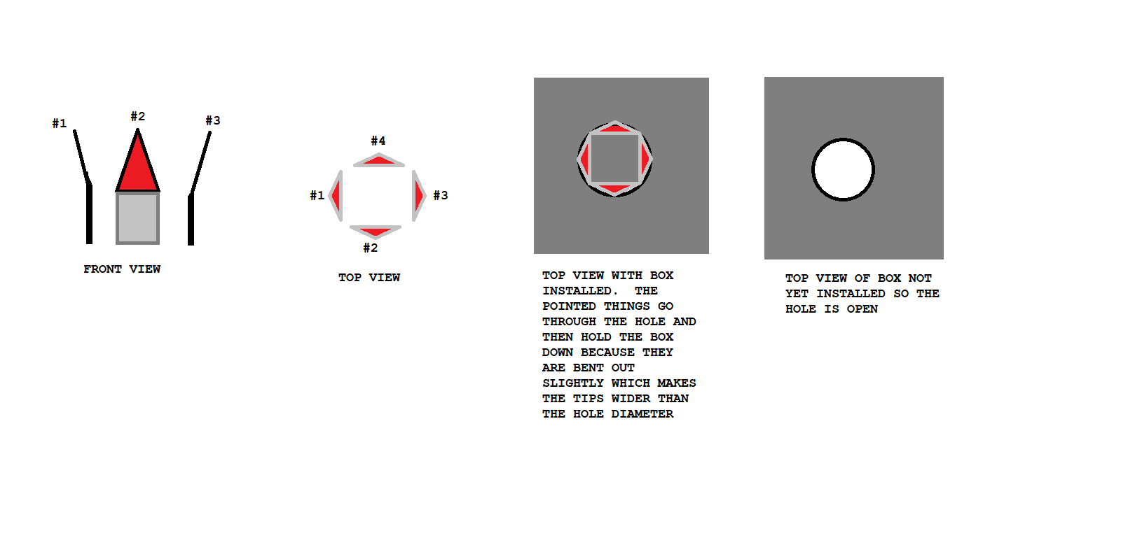

Hi,
I forgot to ask, the CLIP in the drawing i posted, what kind of clip is that and how do you get it off?
Thanks.
I posted a drawing of what the 'clips' look like. The four prongs go up into a hole in the air box and then spring more open. The springy mechanism makes the tips wider than the diameter of the hole once the air box is installed and that holds that part of the box down.
That's what it looks like anyway.
I am guessing that you just push the air box toward the passenger side and then yank it up to get it off of that clip(s) and because they are springy they will close up slightly as the hole moves upward from the yank thus releasing the box at the hole location.
Maybe it's not that strange of an idea if that's the way it works because you dont have to loosen anything to get the air box out.
I am not sure if this is the correct way it works through.

Post by scot850 »
I use a pair of wide pliers or adjustable pliers with a decent width. Place it on the corners so it catches all 4 sections and it pops out. You can be a little rough and pull hard and they normally release.
I also have a pair of long reach 90 degree pliers that work well as well.

Hi Neil,
Do i have to take the battery out to do that? I was hoping to not have to do that.
It is hard to get to that 'clip' i tried using a 2 foot long screwdriver and a 16 inch pair of large hemostats but it didnt seem to work. I seriously doubt i could get a regular pair of pliers in there. I could take a picture if that would help i meant to yesterday when i tried this.
What happens if the 'clip' breaks? Will the box no longer stay in the right place or just jiggle around more?
I feel i am getting close now to solving this little dilemma, thanks again.

Hi,
Oh that's a great video i didnt see that one or it would have cleared this up faster i think Robert makes great videos.
I see now that what i think would help a lot is to take the frontal air pipe out first, as that may clear enough room to get in to the clips a lot better. I'll try that next. That probably clears that mystery up and the video also helped clear up the mystery of the exhaust heater pipe as he shows, pulling it off of the box. There is also a vacuum line and a connector to be removed.
So this may finally clear up the method to remove the air box as that was the biggest obstacle to getting to the distributor cap and wires.
Thanks once again, and i updated my little drawing to show how i think the clips work in conjuction with the hole in the flange of the air box. See if you agree with the drawing of the mechanism in the bottom part of that drawing. It's just an interpretation of how i imagine it works for now.
BTW i think my air box only has one 'pin' on the side of the driver i thought there were two, but that's not a problem at all just a note. I checked it yesterday by gently pushing the air box toward the passenger side which reveals the space between the air box and fender metal.
