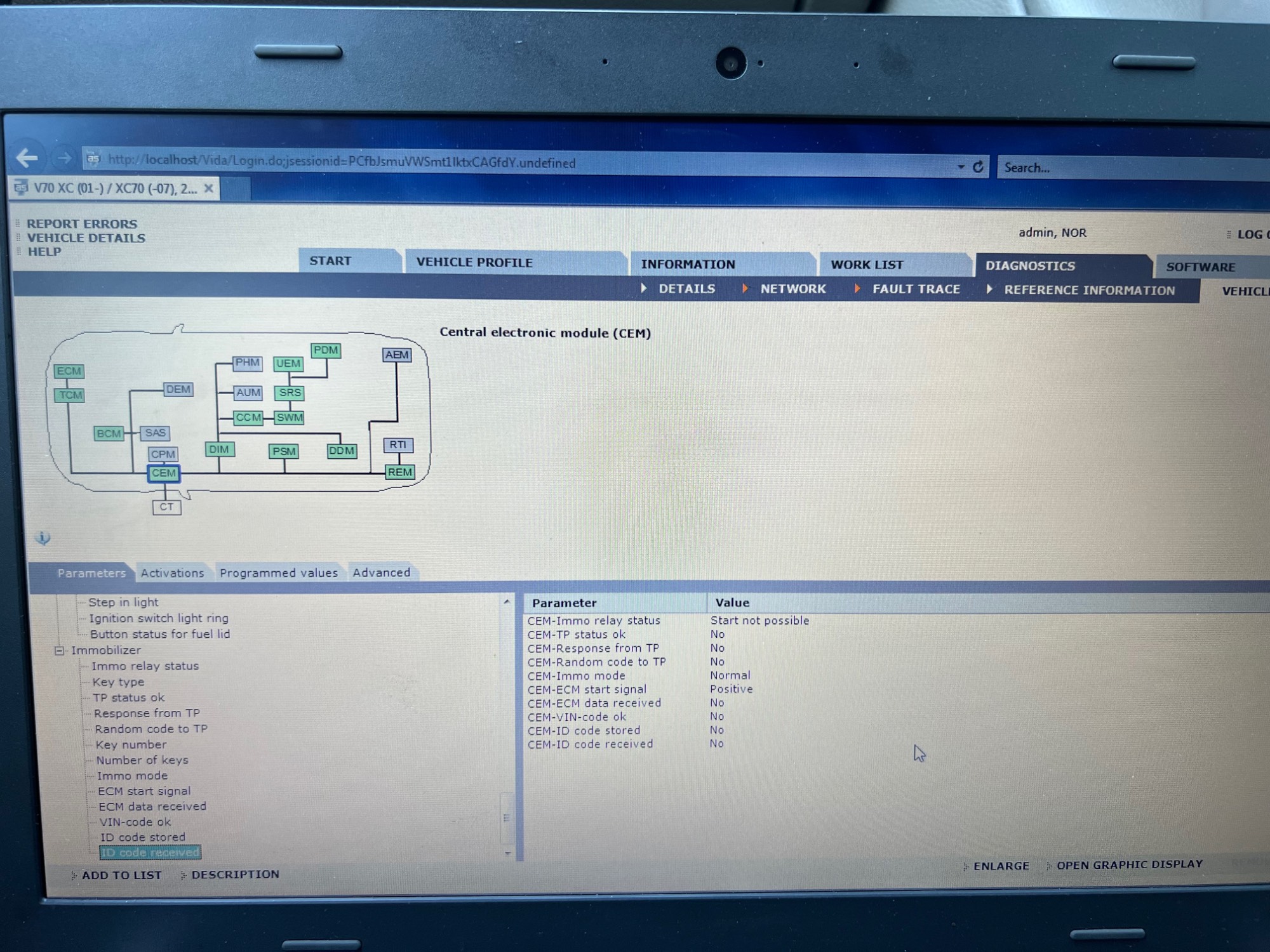

I'm thinking the key programming was lost so I get out my VIDA to check. But VIDA cannot connect to the car. I get the following message:
Is it possible that the CEM went bad or is the immobilizer preventing connection? How can I program my keys if the VIDA can't connect? Does anyone know how to fix this? I'm lost, please help.

If vida doesn’t connect to your car, try to put vin # manually ,and then vehicle profile + diagnostic.

I have also “ car prevented to start” message , vida shows me this reading under immobilizer. Does car need to be programmed by volvo or is other choice? Thanks for any suggestions.
